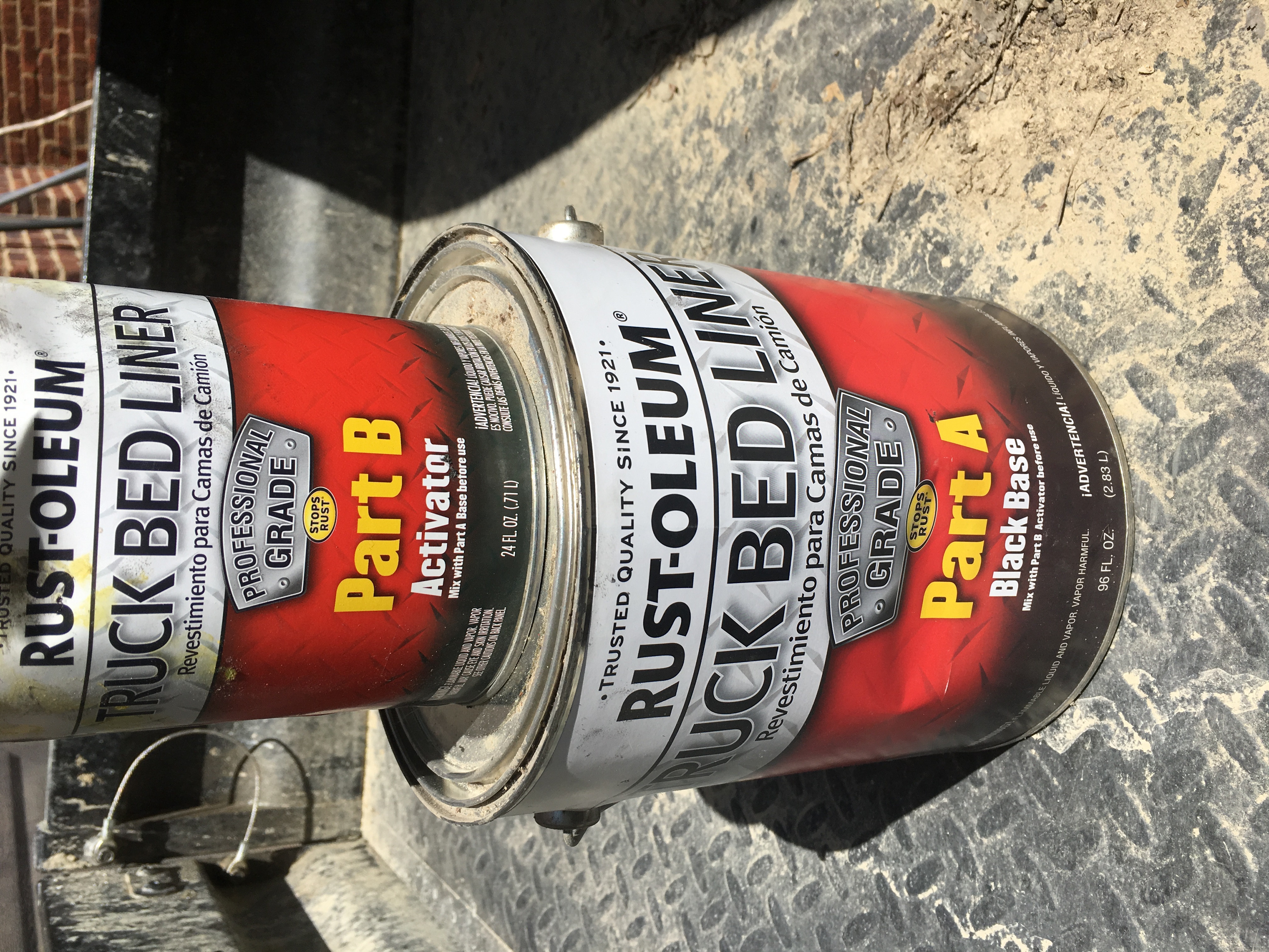

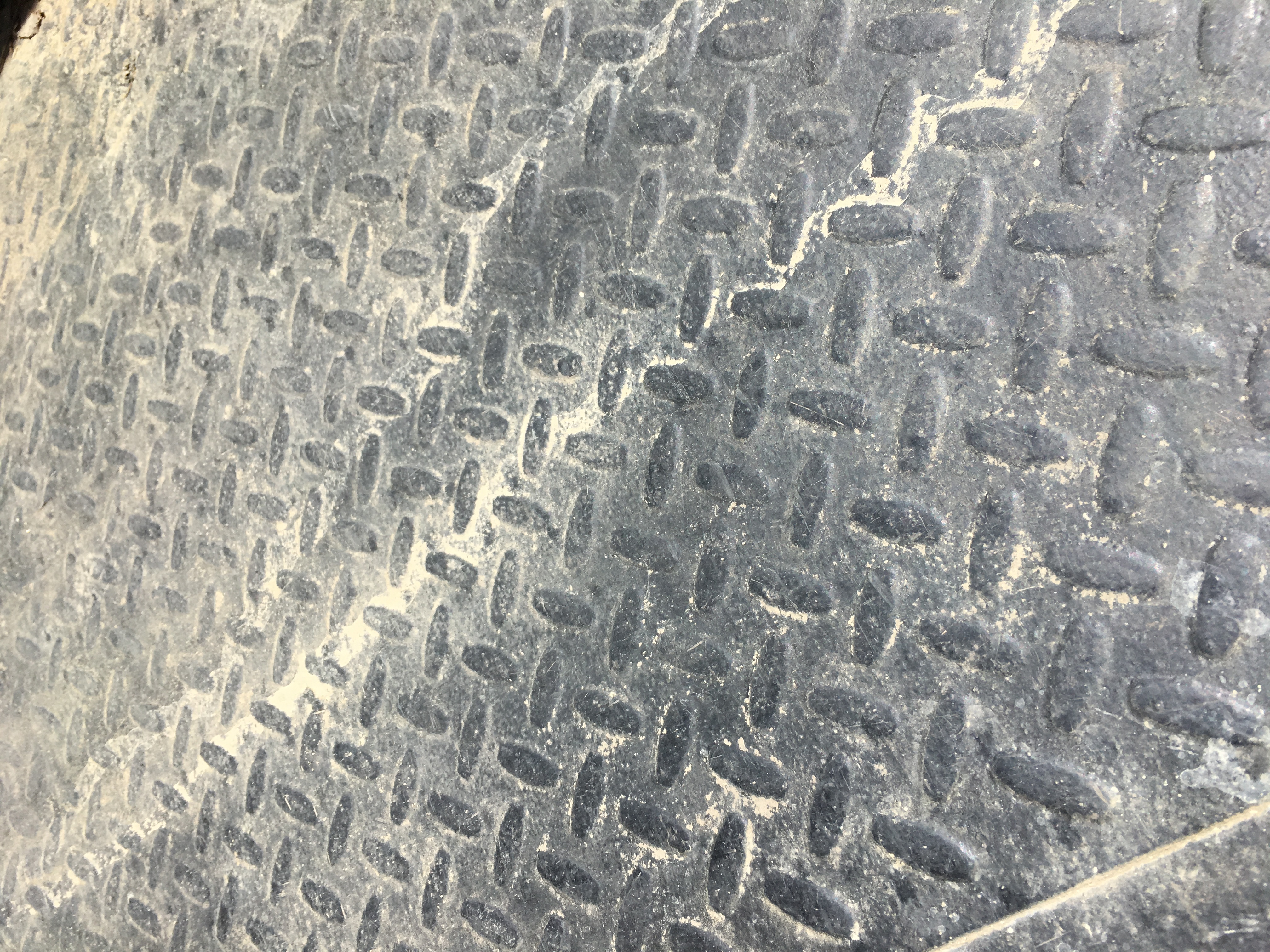

I was also shocked at what they wanted to do the bed of our mule. We used Rustoleums two part bed liner in the bed. It still is holding up excellent after 3 years of heavy use. Rock, dirt and shoveling have not damaged it a bit.
Like others have said prep is the key.

I just wonder. The "cost" of having a small part/area done must, obviously, include the setup costs. Which could be a fairly standard cost - large job or small job. That's the reason I decided to DIY. AlanW - is the Rustoleum a Urethane type product? Being two part - like Part A mixed with Part B.

It appears to be a two part epoxy coating with ground rubber added. As you can see it holds up well. Even the pitch fork hasnt scratched it yet. I have planned on doin my tractor steps with whats left. Someday.
   / Non-Skid Coating for BX floor #7
UGG - I ment Epoxy - two part. Looks good.
