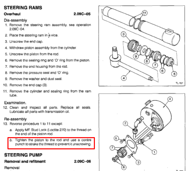

Need to fit a new seal kit to a leaking power steering ram on my MF 253. A bit confused by the directions from the factory manual that the nut should be locked onto the shaft by centre punching the thread (see illustration)as this would surely cause problems the next time it needs to be refitted.
Any suggestions on recommended process for locking a nut to a shaft, would locktite on its own be enough?
Thanks for any help and if anyone wants more pages from the manual happy to supply.

Loctite would probably work, you could also safety wire nut but I wouldn't be too concerned with the method described. You only need to deform one thread to prevent the nut from vibrating loose. You will still be able to get it apart later.

ok, thanks that makes sense
