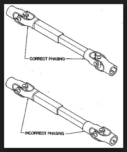

I had a bearing go bad in my Kubota 60" mid mount mower gearbox. I replaced all the bearings since I had it apart and it sounds great when I run it.That is until I lower the deck. Then it sounds horrible. Worse than it did when it had the bad bearing in it. As soon as I raise the deck back up it sounds fine again. I took it all apart and rebuilt it again just in case I might have done something wrong. Same thing. Any ideas ?

Folks I believe we have a winner ! The noise and vibration from the mower deck in a lowered position (but not in some other one) means the input and output shafts aren't parallel OR that the PTO drive shaft is out of phase. If it's put together properly, the inner cross yokes must face the same (as in no angle between them). Otherwise you will get a cyclic wobble that will rattle your nerves and your bearings.

I just went out and checked and both my mmm and brush hog shafts have the yokes aligned, not 90 degrees to each other. Yours should be too, regardless if it is keyed, or not.
/ noise from mower gearbox #16
My Bad.....In my previous in put I should have said 180 degrees....been out of high school for 50 years.

Thanks for the picture Kanook. I really didn't understand what you guys meant by out of phase or time. It's said that confession is good for the soul.........I was kinda thinkin some of you guys are nuts. I'm 56 years old and been driving tractors on a farm for 30 years. I've never heard those terms being used in reference to a u-joint or pto shaft. Now I get it. I just went out to the garage to look at the shaft. It's splined but not keyed......and it's off about 35-40 degrees. I took it apart and lined them up right. I will put the mower back on the tractor tomorrow and try it.

Thank you to everyone who responded to my problem. It was the shaft misaligned. I'm surprised that the shaft is not keyed. The ones on my tiller and bush hog will only go together one way and I just assumed this one was the same way.
