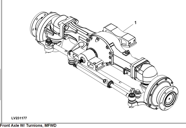

I have a noise like finger nails on a black board when using FWD and going down hill. Left side only.

Sounds like a u-joint. Not familiar with that specific model but the u-joint for the LF axle is probably getting bad. If it is really bad you might see play in it with prybar or see rust coming out from one or more of the caps.
   / Noise from front end on 4400 JD utility tractor #6
Stubut
I'm a bit puzzled what you are calling the short shaft. Here is a pic of the front axle assembly and it is driven by a shaft coming forward from the transmission. Within the axle assembly are some shafts that drive each hub left and right.
Have you checked oil level in the front axle assembly and it is full on the dip stick? If not, maybe hearing a seal going out, or maybe a bearing.
Keep us posted so we can help sort it out.

The noise is coming from the shaft that goes from the axil to the wheel.
I am going to take it apart this weekend and check the barring.
I will report next week.

Good Day all;
Well I finely got the time to take it apart.
Pulled the tire and the finial drive of the Left side. Very fine metal dust and oil mixed. Cleaned all bearing and other pieces with degreaser.
In the manual it says to set the T12 gear at the lower end of the spindle shaft to .022 ". It moves about 3/8 of an". This is the way I found it. Do they really want spacers that move it that high? The said the backlash should be .006 to .008. Is this the space between the finial drive gear and the T12 lower spindle gear teeth?
All parts look good except the final drive gear (the big one). It is not shinny.
I am the Virgin Islands so can't run down the JD dealer.
Open for suggestions.
I checked the backlash by moving the spindle T12 gear to both ends of it's movement and got .025".
I cleaned every thing and spun the two finial drive bearings. They sounded quiet and did not have any play. I put it back together and still have the loud noise.
I now believe it is coming from a bearing. There is a roller and a ball bearing. Do I replace both? Should I check the spindle bearings?
Thanks for the help.
