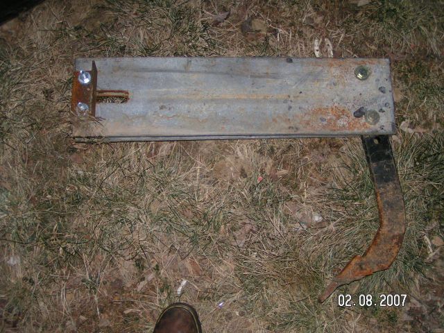

I have made a subsoiler out of a drawbar, scrap metal I found on the side of the road, and a Ripper Shank I bought at TSC for $24. I will post pictures once I get home.

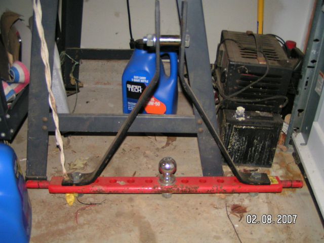

OK, here are the pictures I promised in my first post. The first picture is the 3pt trailer mover. It is simply a 26" drawbar (bought at TSC) with the two pieces of 3/8" that go to the top link (I bought them for $35 on the web).
The second picture is the ugly, yet effective subsoiler (if you want to call it that) that I made from a BB ripper (again bought at TSC) and some 6"x24" that I found laying in a trash heap next to a parking lot. I cut slots for it to slide onto the drawbar, then bolted some angle iron across the back to keep it from pulling off the drawbar when in use. I used this to help dig a 140' trench to lay wire for a lamp post, worked great. First pass went a few inches, second passe (with 220lb BIL stnading on it) got me down a good 10 inches at least.

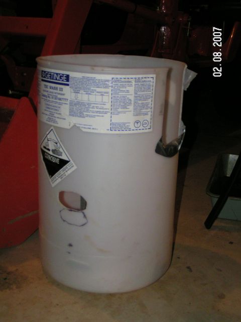

The last picture is off my ballast tub in progress. It is a 15 gallon tub. I have cut holes in order to put a drawbar through it (made it so I could pull the drawbar out if needed). I also cut out a piece of the side so that top link would fit. I have 3 bags of conrete waiting to go in.

Duh...Sorry, her are the pictures
