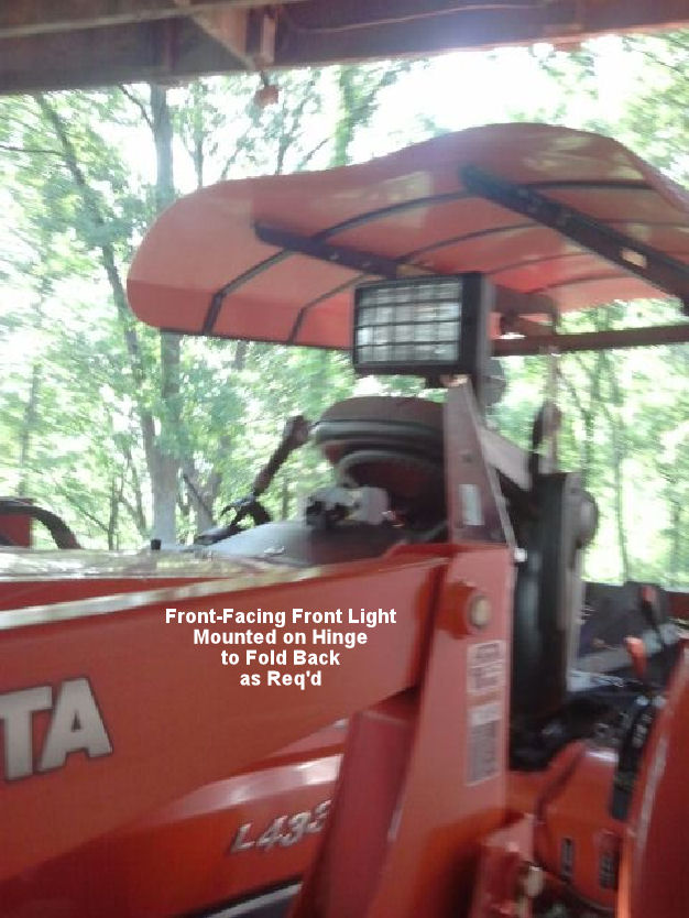

After years of use and intimate encounters of the worst kind with branches, my work lights needed rehab. I note, as do all of you with FELs, that the tractor's OEM lights must be there for some purpose other than nighttime visibility.
My requirements, this time around, are to have fore and aft lighting that can duck out of the way, do the job whether the ROPs is up or down, and install using readily available (e.g., Home Depot/Lowes, etc) hardware. Also, front illumination has to shoot over my canopy.

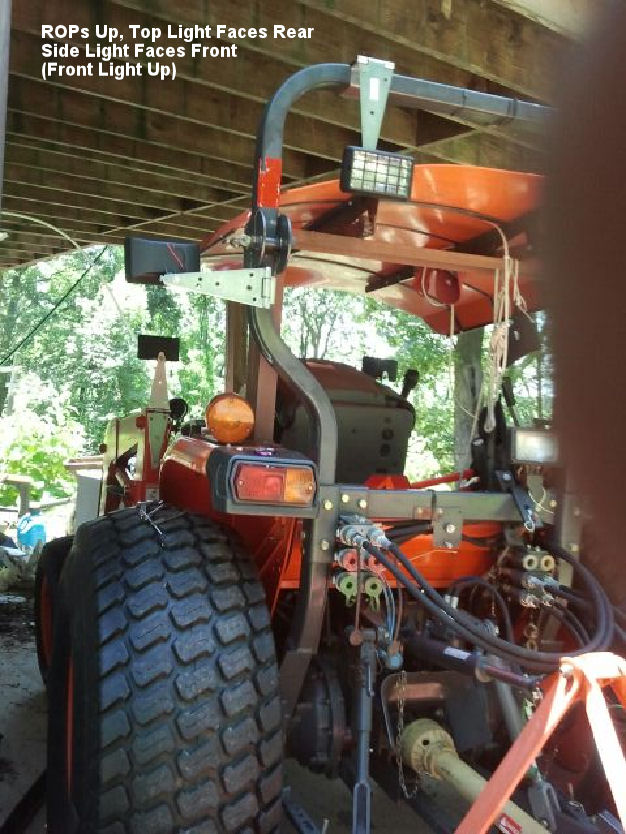

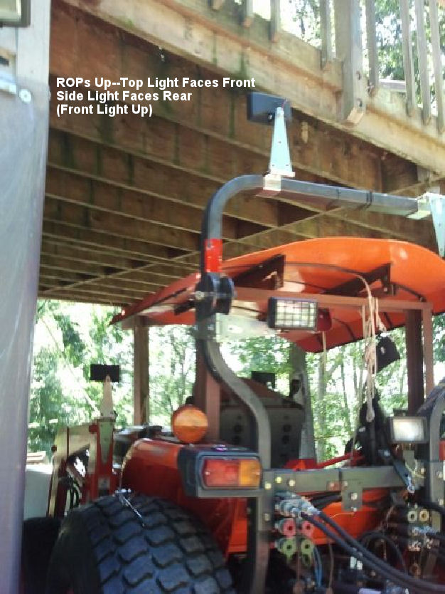

As the pictures show, the lights are mounted on gate strap hinges, which are attached to the ROPs with Gate-Latch "Closed Bar Holders". I drilled and tapped the Bar-Holders (but you could use washers and nuts) and drilled matching (slightly over-sized) holes in the hinges. The fasteners are all 1/4 - 20 hex-heads and 1/4 "fender washers" (because the holes in the hinges are over-sized to give some adjustment ...and make up for the fact that I'm notoriously bad at measuring).
The lights are mounted as shown in the farthest (existing) hole of each strap hinge ...I used a taper reamer to get the required fit (if you're not familiar with this shade-tree mechanic's best friend, I recommend one for your toolbox).
The pics show the variety of configurations possible for the lights (which are symmetric, side to side). There are 3 pairs of lights, then, controllable from 3 switches (which, in fact, are double-throw, so I could get fancier, if/when). I can't imagine using all 6 lights at one time (although I have upgraded to the larger "cab" alternator). Note that, if I want to be in electro-conserve mode, I can run just one pair of ROPs lights, one facing front, the other facing rear.

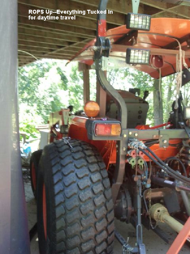

And, did I mention that each light is designed to fold away when brushed by a branch. The last pic shows all the lights tucked away for safe travel.
The discerning among you may have noted that wires are not yet hooked up and there's some excess strap hinge to be cut off ...but that's for tomorrow

What holds the light in position, as in photo 1 and 3?

Could you also post some details photos of how you attached the strap hinges w/o drilling into your ROPS?
I didn't understand your explanation- my fault not yours- I process better by images than text...

Could you also post some details photos of how you attached the strap hinges w/o drilling into your ROPS? I didn't understand your explanation- my fault not yours- I process better by images than text...
See " Gate-Latch 'Closed Bar Holders' " example here:
[ame=http://www.amazon.com/National-N235-291-Closed-Bar-Holder/dp/B000BO9NFI]Amazon.com: National #N235-291 ZN Closed Bar Holder: Home Improvement[/ame]
   / No-Weld Trick Work Light Brackets
WRooster's link shows the piece that slips over the ROPs...the rest of my explanation may now make sense, no?
As for what holds the lights in position ...in the ROPs case, side or top, note that the hinges will only fold 270 degrees and I made that work for me.
In the case of the front lights, they are set down just a tad below the "barrel" of the hinge and the upright member, to which they are attached, stops any forward movement.
So far, so good, but I am sure others can improve on the design(s).
   / No-Weld Trick Work Light Brackets #7
Clever idea; but without a torsion spring on the hinge pin, I don't see what keeps the lights in place during use, as any vibration is going to move the lights anywhere but where aimed.
hinges are quite stiff, and arranged so each light operating position is slightly "over-center" on hinges that only turn through 270 degrees and are used at the limit of their travel. what else can I say, they seem quite stable.
