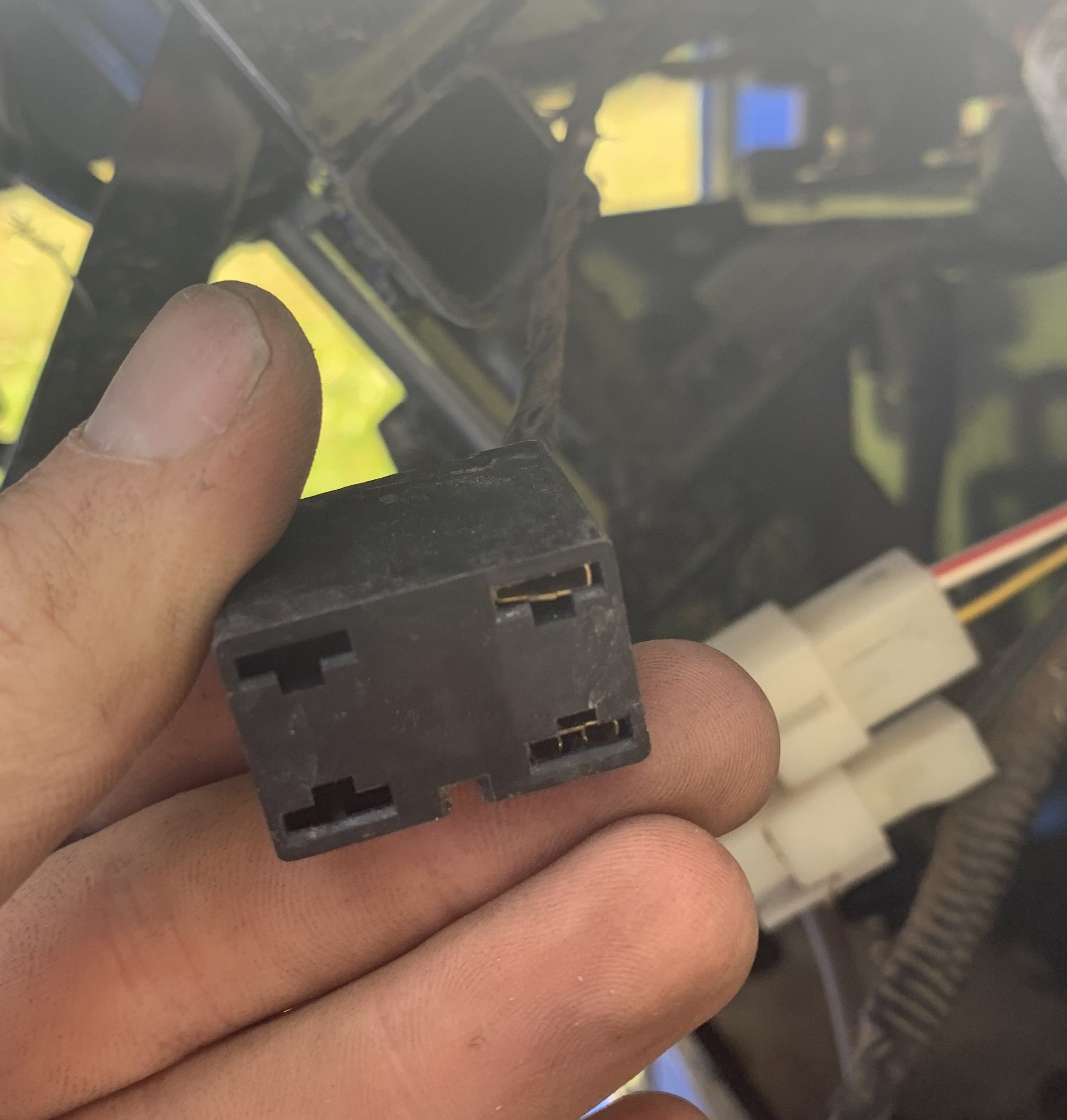

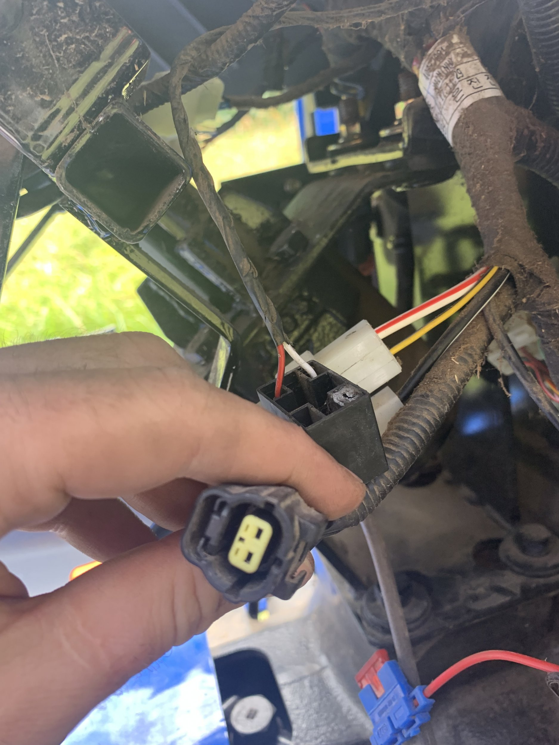

There are also two orphan appearing connectors under the dash. normal or cause for alarm?

Not sure about the open plugs under the dash.... I do know that there are a few unused plugs there... one is for a horn, can't remember what the other is for. It is possible that something got disconnected though.
