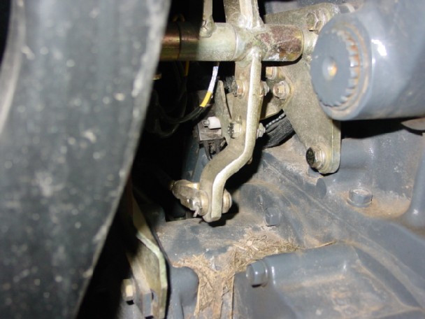

My TC29D has two neutrals on it. The tractor will not start unless you are in one of them neutrals. My problem is the lower nuetral which is where you usually are in the shifting range seems to always need adjusting. My TC21D that I had was easy to adjust. The one on my TC29D is much more challenging. The dealer will adjust it and then three weeks later it is out of adjustment again. I can just move it up to the upper nuetral but sometime it won't go up there unless I rock the tractor back and forth. Can someone tell me how to adjust the lower one on this tractor? There does not seem to be any adjustment screws but there is a plate that has two bolts on it that looks like I could loosen and move some.

No I don't need the clutch. I do need the PTO's to be disengaged. I have two nuetrals and I can start the tractor from the ground. I don't have to get on it. The lower nuetral is the one I use because it is between 1st and 2nd. That is the nuetral that for some reason gets out of wack all the time. If I make sure I shut the tractro off in that neutral it seems to start ok the next time. If not I just have to get it through 2nd gear and to the upper nuetral. My dealer has now adjusted it 3 times. It works great after he adjusts it for about two or three weeks and then doesn't again. On my TC21D there was only 1 nuetral and it was easy to adjust. This one I just can't figure out.
Attached is a picture with another one to follow. You will see two bolts that you can loosen and allow a circular type bar with teeth on it to move. My problem is, if you adjust the lower nuetral you will also adjust the upper nuetral.

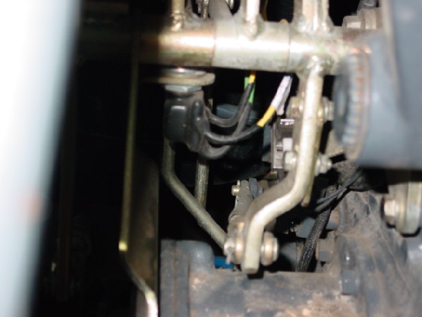

   / No Start Neutral
pic #2

You are on the right track, the adjustment is made by moving the dimpled bar. The switch mount may also be shifted slightly. Usually moving the bar is sufficient

I guess at worse I will mess up both sides. Playing around I will learn how to adjust on my own. I also know that alls I have to do is go push in on the switch and it will start in any gear or any place for that one time.
