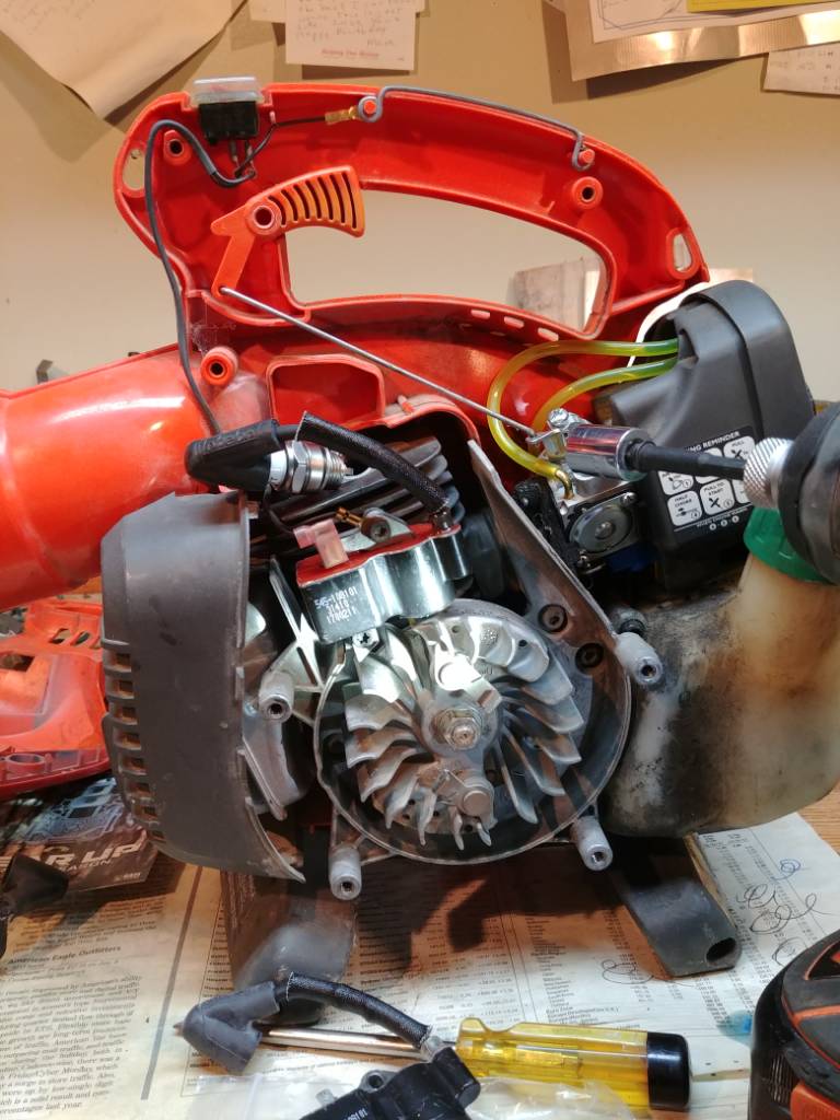

Husqvarna 125B Leaf Blower. When turning with cordless drill & plug out and grounded against fins, cannot get visible spark. What am I missing?
3 different coil packs (2 brand new). 3 different plugs. Continuity check on kill wires and switch (plus tried w/o kill switch wiring).
Flywheel magnets are strong. Set coil pickup distance with business card (sb 0.010).
I'm at a loss. I thought this ignition system was so primitive that even I couldn't screw it up but I'm apparantly missing something. Ideas? 20190320_193406.jpeg

First suggestion is using your hand/fingers rather than a spark plug to test for fire...
Have coils tested...
Set clearances to mfg. specs...
   / No Spark on Leaf Blower. Need ideas. Please.
Air gap set to 0.010 per spec. Nothing changed. Never a spark.
Buttoned it back up to get off the bench. Just for a lark followed starting procedure...
... and it fired up.
Sure glad I don't try to make a living at troubleshooting. Better ground when torqued into head? Better able to twist down wire cap when plug screwed down? Pull start more RPM than drill?
Originally wouldn't fire with new China carb -- always flooded. So that's when I bought the coil.
Sometimes lucky is better than smart.
