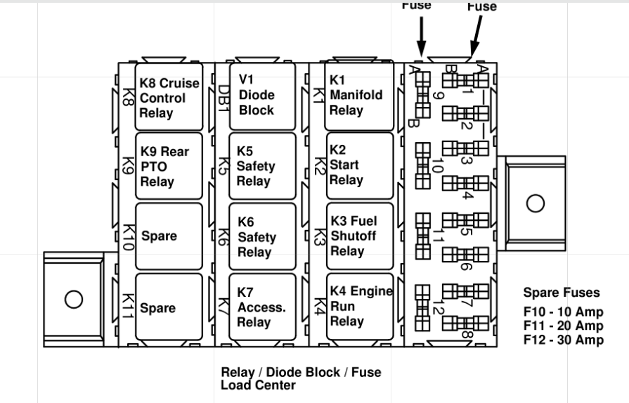

I don't know anything about the fuse panel chip, but there is a bunch of relays in the panel. I think they are all the same so you could do some trial and error with swapping them around, you might verify the diagram is the same on each one I just Think that they are all the same may not be. Is the "click" you are hearing from fuel shut of solenoid?

Thanks. I'll try that when I get home. Perhaps a naive question, but do the relays simply pull out and plug in like the fuses?

Yep, just pull em out like a fuse, they will normally have a little wiring schematic on them so you can compare to the others to verify they are the same. Looks like according to the drawing there may be some spares you can play with.
