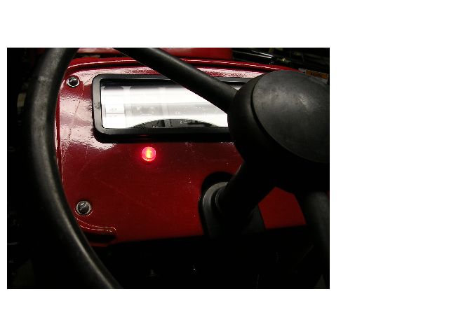

Hi..One of my Jinmas had a oil pressure gage that took forever to indicate I had pressure..I just didn't trust it. Got a mechanical one from Wal-Mart whole kit was 8 bucks,had metric fittings too. now the pressure reads quickly and I trust it. You can hook up a gage temporary while you troubleshoot your factory one.
   / No oil pressure in 224 (under 5 hrs.) #5
Did you cut a hole in the dash and install it?? I installed a ignition light.
So far I guess I trust the OEM oil guage. Maybe we could install a "T" and have both dash and mechanical!?
Patrick

The newer Jinma's have both a electric pressure gauge and a low oil pressure idiot light on the combined instrunment panel(also has a charge idiot light).
