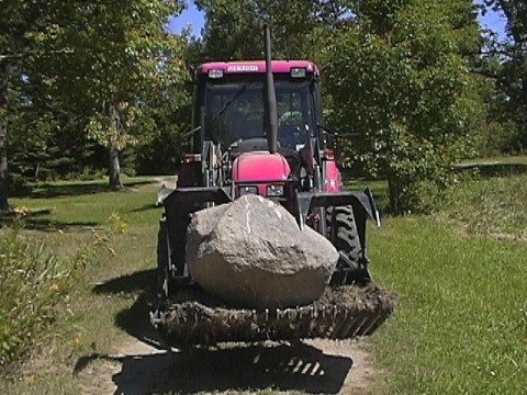

I've been digging rocks this past summer with my Zetor. I looked at skid steer as well. 2 problems with SS. 1 No ground clearance gets hung up in the field easily, short wheel base also gets stuck easier & cannot crab itself out. 2 skids instead of turns really tears up the turf

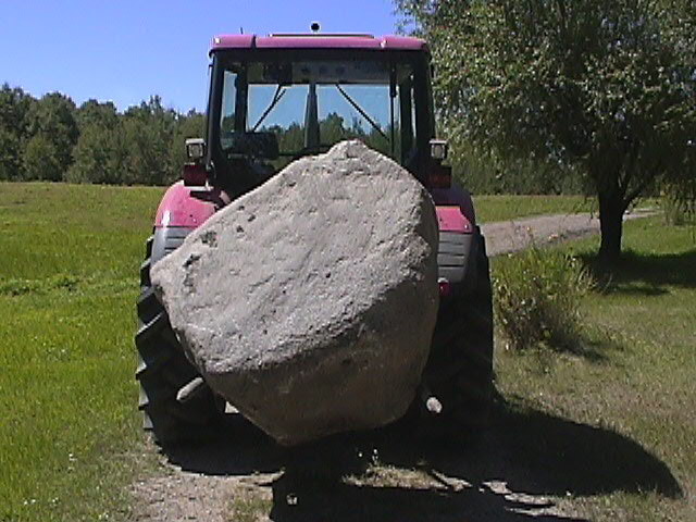

Larger rocks on a bale fork
