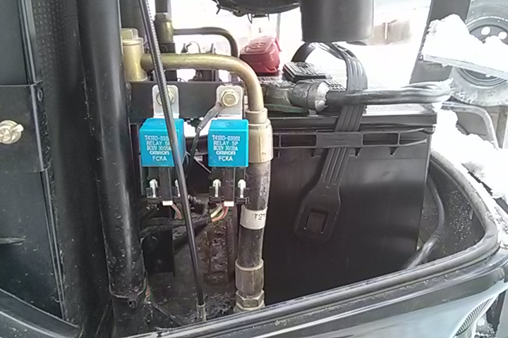

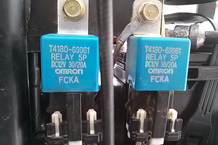

   / No lights or dash electronics - CK27 2010
Alright, so after replacing the ground, cleaning connections points, and now, today, a new battery, my flickering dash/lights are now completely non-existent. I got them to work when I was messing with the ground when I fiddled with the two relays by the battery. I've attached pictures of those relays as well as 1 on the engine wall. The CK27 parts lookup says there are three of these relays at the battery (my bobcat ct225 has two) and that they are for the hi-low beams. If I replace 1 or both of these relays at the battery, do you think this could be the problem. IMG_20140216_123038.jpgIMG_20140216_123053.jpgIMG_20140216_123159.jpg
