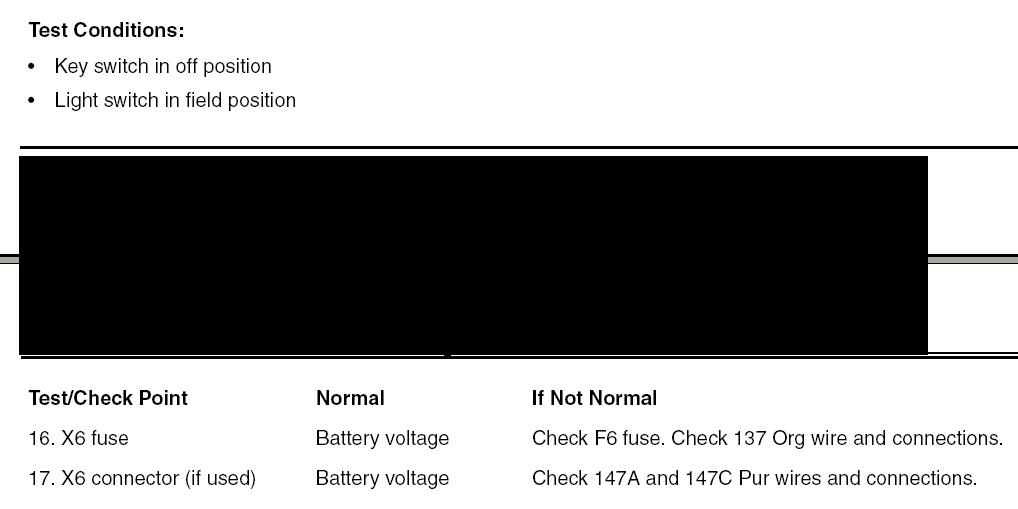

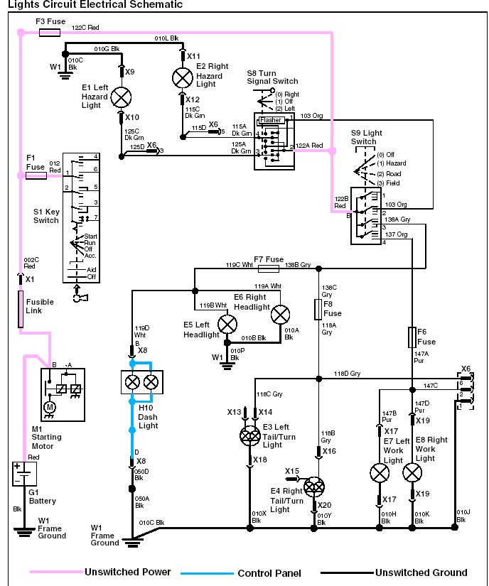

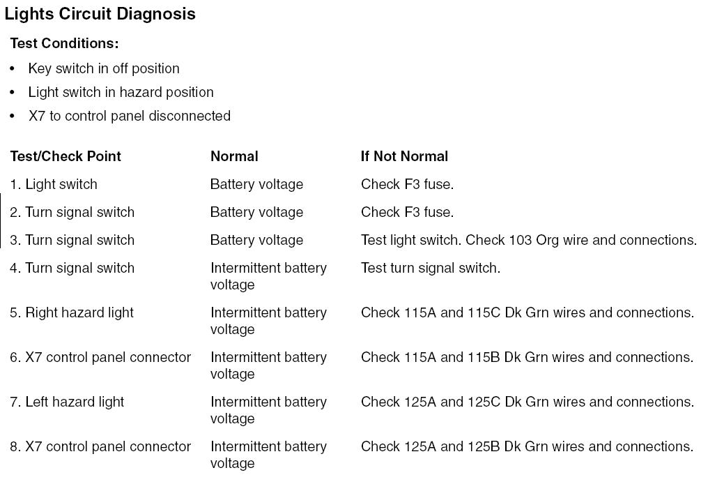

Hey all...I just joined after purchasing an '04 JD 4410, just wanted to say and bug you all for a minute.
Tractor seems to be pretty good for what we are going to using it for. A an issue that has come up since getting home and going through everything. The headlights and turn signals don't work at all...what should I guy look at first? I haven't really gotten into it too much yet, I'm at work and haven't checked fuses yet but wanted to see if anyone on here had any ideas of where to start.

If you don't get too many hits on this post, you might try putting one in the "Owning and Operating" board, as this one is for Lawn and Garden (smaller) tractors.
One handy item to have for such things is the CD or paperback copy of the tech manual if you are interested in tracking things down and fixing yourself.
Maybe look for a blown fuse. I'll poke around in my tech manual as I believe it also covers the 4410.
Here are some 'pages' that may help you check this out.
