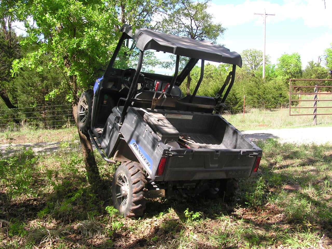

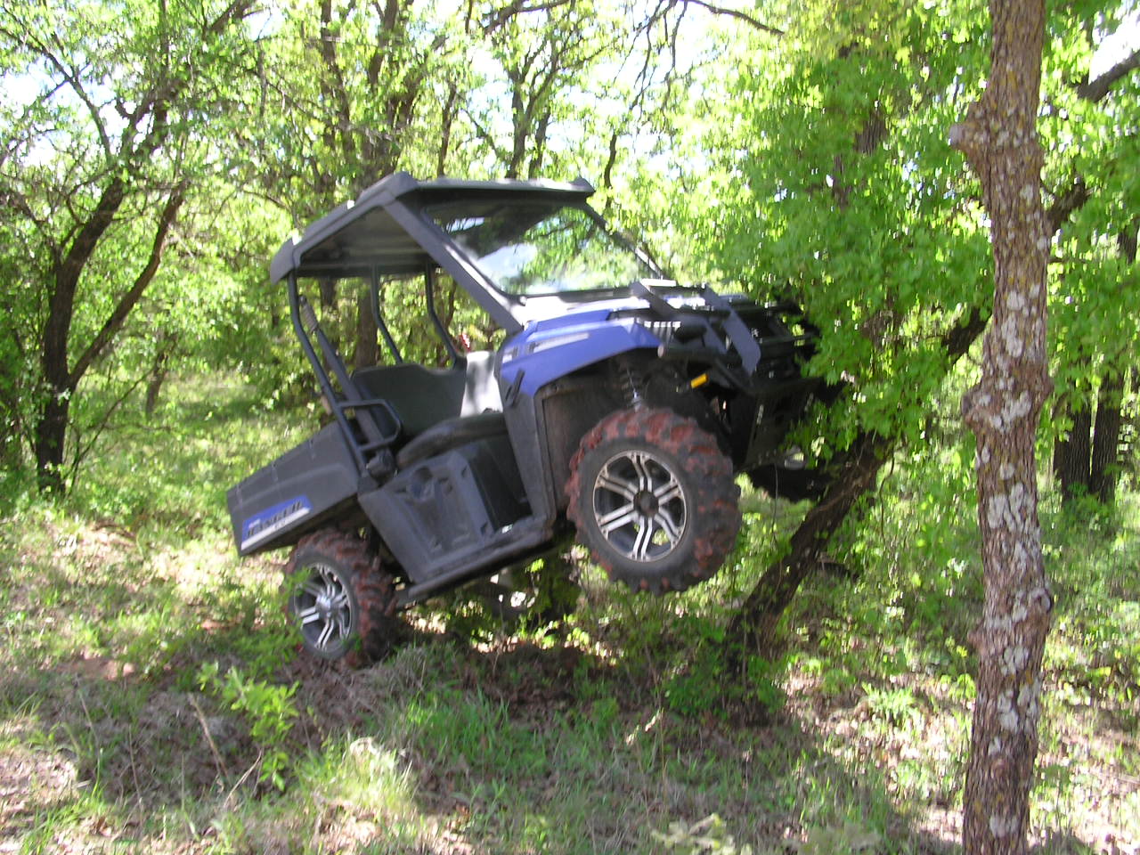

If the motor has potentially high field voltage and current, maybe they don't want that thing grounded. I wonder if the Polaris 48 volt UTV has a grounded frame.
   / No Frame Ground! Electric Golf Carts and such systems #9
-------- I wonder if the Polaris 48 volt UTV has a grounded frame.
No, it is not grounded and I don't know why.
But it is a neat UTV, so powerful it will climb a tree! :D
