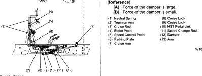

Out tilling this evening and BX25 seemed a little sluggish backing up a few times, but forward seemed to have been fine. Thought it might have been an issue with tractor being in low range so shifted into high range with no difference backing up. checked to see if there was dirt impeding the travel for the pedal, and all is clean. I have had that problem before. Then no forward or reverse. No sudden signs/sounds. Just nothing. Everything else seems to work fine on the tractor. After shut down, checked tranny fluid. Dipstick is dry. It was fine yesterday! Looks like maybe fluid loss around rear PTO shaft that was driving tiller. Added about 1/2 quart of Kubota trans fluid, no change. Oil is graphite/black looking. Pedal doesn't return to position, and if I put pedal up manually to proper position, it drifts down halfway, and feels kinda loosie goosie. Thought maybe to remove strainer and clean. Any other suggestions? Thanks,
   / No forward or reverse BX25 #2
See below image. Follow the speed change rod #11 from pedals to #2 trunnion arm. On most BX's where rod attaches to arm is a ball and socket. Some wear and rod falls off trunnion or ball breaks off and rod falls off. Some are nut and bolt and nut and rod falls off. Hopefully that is what happened to yours and is a cheap fix.

The problem that I had before, was that chunks of dirt got up up between frame and linkage and the HST wouldn't operate. That wasn't the case this time. All clean. Added about a half quart of fluid to bring level up to full, still no movement. The wet brake was changed several years ago, and new fluid at that time. I only put about 150 hours per year on the unit-if that much. Changing fluid and filter, and cleaning strainer today, I will post more when I get some news.

This dropped out when I removed trans oil drain plug. Can't be good, WILL NOT BE CHEAP.
