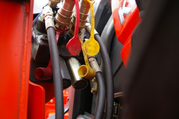

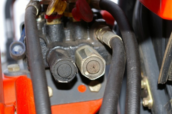

The 4-way valve float position is not working on my LA723 loader. (Kub Grand L3130)
Although I don't use it that often, I'd still like to repair it. Does the valve need replaced/rebuilt or could it be something else? What's a ballpark $ figure for a new valve or a rebuild?

   / No Float on Kub 4 Way Loader Valve #2
I had the same problem with mine while under warranty. It had water in the valve. They changed a part in the loader valve and it works like new. It was a 2 minute fix at the dealer........

Just drill a very small hole in the aluminum cover that retains the spring...... it will allow the moisture to drain and you can also use the hole to pray lube up in there.

When I took it to the dealer under warranty they replaced the Chrome looking unit of the valve body. It was actually grey { the original but was replaced with the new one. As you can see there is a small diameter hole in the bottom of the Nut. When they unscrewed the original water came out of the body. Replaced with no questions asked. 1 minute fix. unscrew yours and i'm sure water will come out of it. Sorry for the delay but had no pics of the replaced part. Hope this helps........This is the underside of the joystick control looking at it from the front.......
#9
JK,
Thanks so much for the information and the pics! You da man!! :)
Now I understand what Ductape was saying about drilling a small hole.
Still don't understand the reason Art says to fill the cap with grease. Is this a "fix" instead of drilling the hole? :confused:
-jim
   / No Float on Kub 4 Way Loader Valve #10
Bucky4 said:
JK,
-jim
I think the grease just holds everything together while it is assembled. Little check balls and springs have a habit of running away and hiding .
