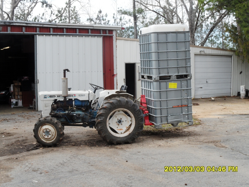

In my view a "carryall" is much more useful than pallet forks for moving firewood and lots of other things. The forks may work well if you have the ability to set up a pallet system for storing the wood, but I don't on either end.
An angle blade is useful both for snow removal and driveway grading.
A rotary cutter is essential for rough mowing.
Terry

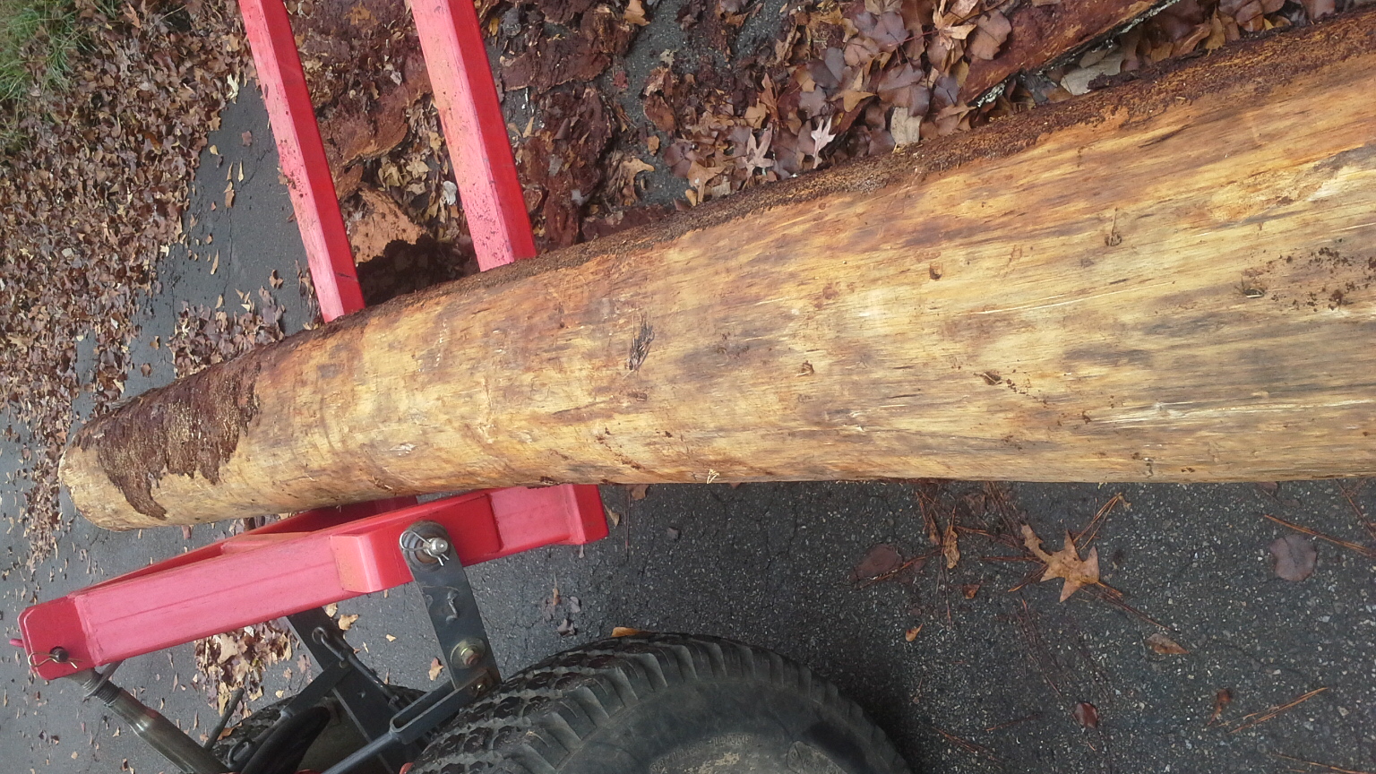

And with my pallet forks I've a box on a pallet which functions as a carry all.
Plus you can carry other stuff.
Sorry for the rotated picture but the blasted upload software is doing it.

Are those cotter keys/hair pin clips strong enough to use on the lower lift pins?
I have lynch pins/linch pins on the lower arms, and just yesterday I drilled-out the hole in the pin on the top link so i could switch from a cotter key to a lynch pin there.
