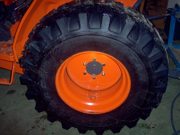

On the attachment you will see how little room there is for chains on the tires. Solid rims never thought about this but being up here in the north east pushing so much snow made me think of that .If anyone with R4 has chains let me know, have not talked to the dealer yet either, is there some kind of spacer cause it is so **** close.

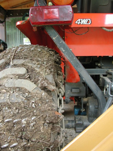

2nd picture solid rim

I think you need to look at spacers. Some off-roading companys make steel ones, maybe in your size. I was curious what they did on the lower priced models to cut the price and the adjustable wheels are pricy. For an L5030 the adjustable R-4 wheels (24") are 400$ a side.
   / no chain room R4 #5
Hey Chris,
I have a B7800 with turf tires unloaded. I bought chains when I ordered the tractor. When I got the tractor and went to put the chains on there was no room for them they just rubbed and bound up on the inside fender. I called Chappell where I bought the tractor from and they gave me the wheel spacers. Then my detent ball became stuck on the loader and had it serviced by them at my house, I threw the service tech a few extra bucks and he installed them for me. The only down side is when you do maintenance on the tractor you have to take the rear wheels off to may sure the spacers are still tight.

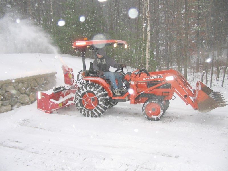

I have a B2710 with R4's and chains. Clearance is not an issue and I do not have wheel spacers.

chrisscruton,
There is not a lot of room there, but there may be enough, depending on what you want to put on that tire as far as chains go.
Like MadRef, I have 2-link ladder chains on the R4s on the back of my B2910. I think I may even have less clearance than you do, but they work fine if you keep them tight, and cut off the extra links on the inside chain.
Attached is a picture. I kept my chains on all year of 2004, due to all the rain we got. Put 350 hours on the tractor without any problems with the chains at all.
These chains are the "standard" kind that use 3/8 chain links.
Don't write off the possibility of using chains on those tires without spacers. It may work if you keep the chains tight.
On the B2910, turf tires are wider than the R4s. and reports are it is impossible to use chains on turf tires for this reason, unless spacers are installed.

My R4's are 12.4-16 and I got my 2 link ladder chains from tirechains.com . I had to remove one cross link as they were just a little too big. I know Henro had to remove a cross link too.
The chains should be tight and not flop around especially on the inside. You may have to cut the chain to accomplish this. The heavy duty spring chain tensioners are a must, don't settle for the standard version.
I have approximately 3/4" to 1" of clearance on the inside of the fender at the closest point which is at the bottom of the fender. I have never had any chain rub.
