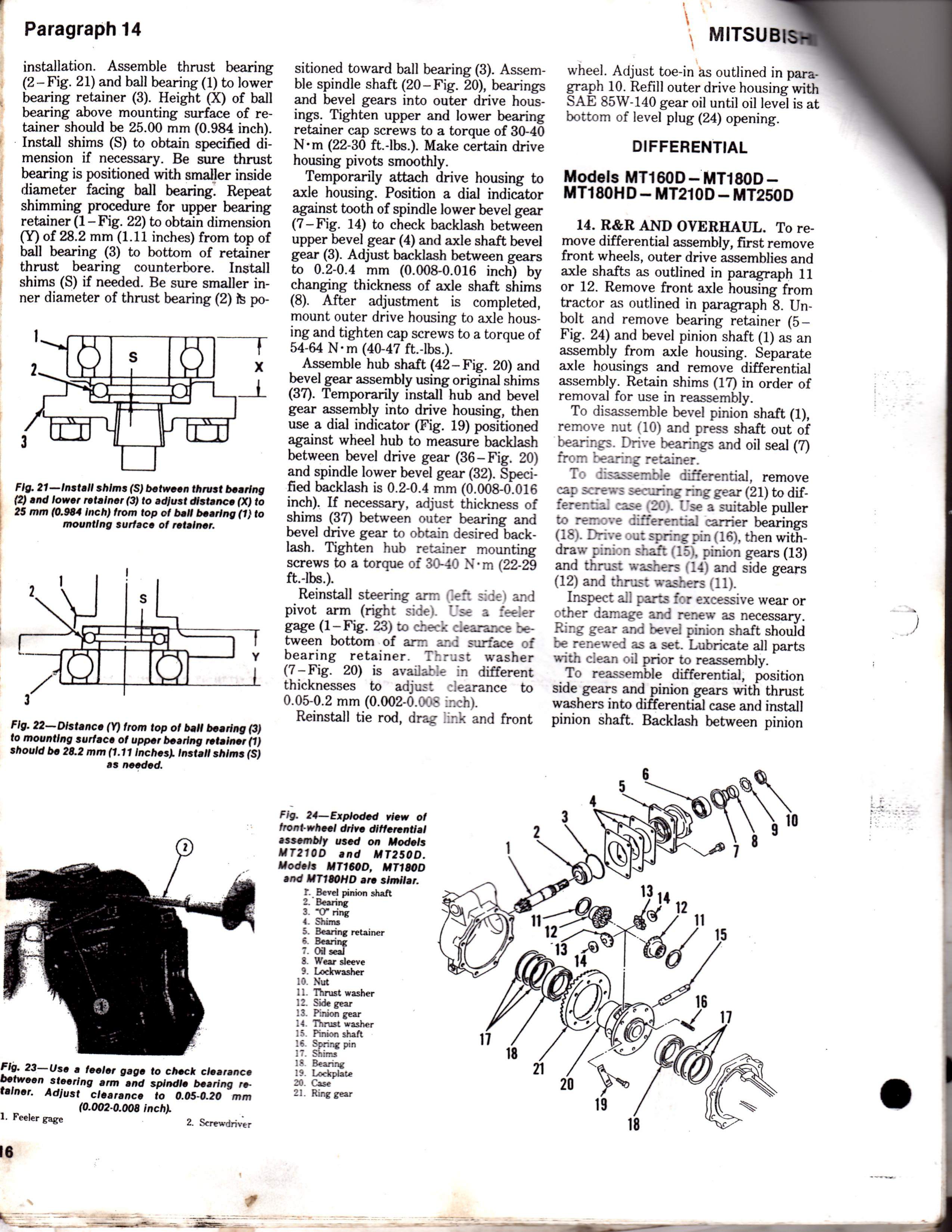

Thanks again for the replies. I got the tractor on jackstands last night. With the front off the ground, if I spin one front wheel the other wheel spins in the opposite direction. This happens in 4x4 and 4x2. When tractor is running in 4x4 the driveshaft still spins but the front wheels do not. The yokes are spinning too so I don't think there is a problem with the driveshaft connection to the yokes.

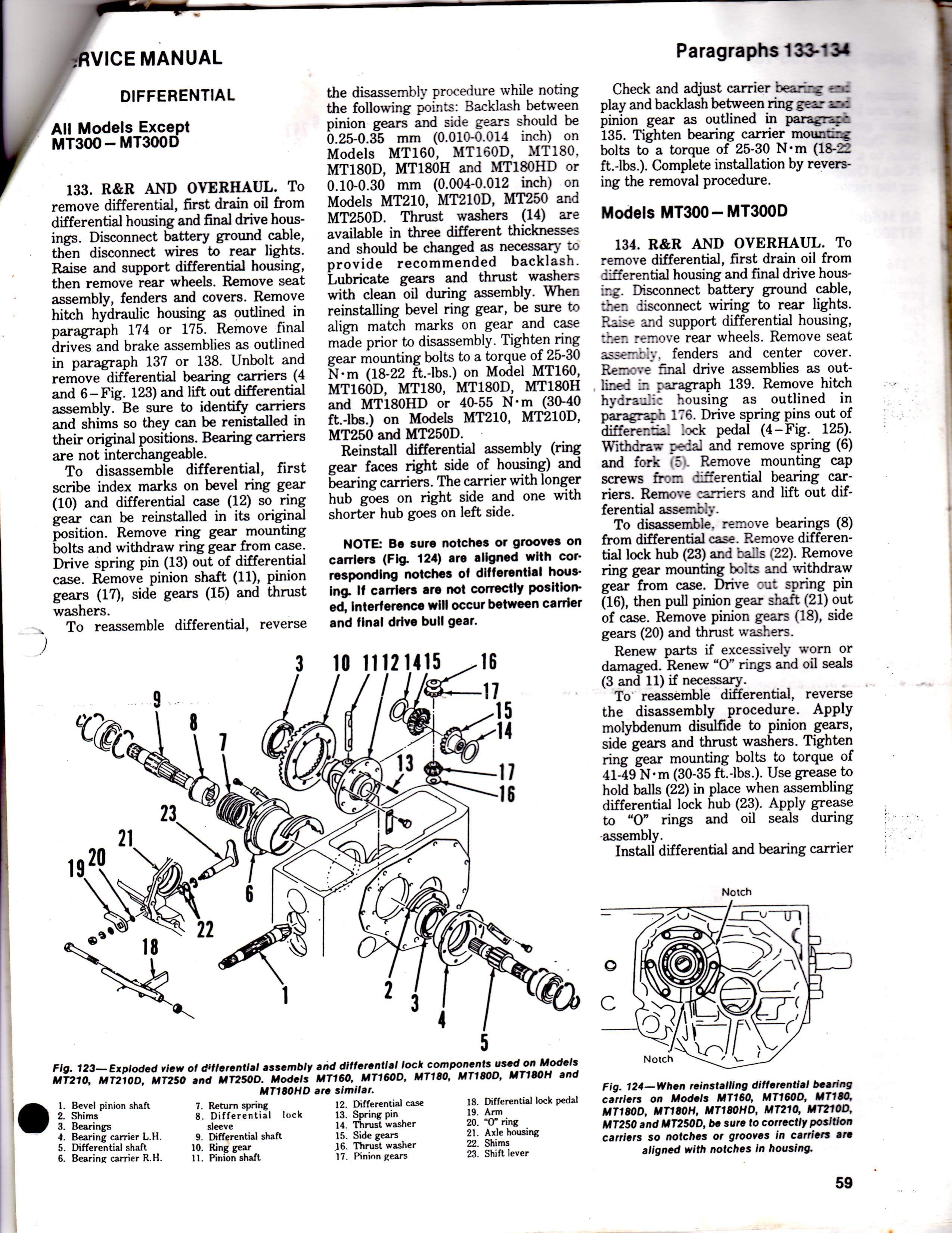

Sounds like the front differential has been neutered. There has to be some parts missing, possibly the pinion gear off the input shaft? When you spin one front wheel and the other turns opposite, that is normal. The locker might be a little loose, not sure. Is there a nut on the shaft where it pivots? Most are pretty tight and have to be freed up. Can you tell by a close inspection if this tractor has been disassembled? You could have one of the notorious vietnam rebuilds. Hope not.
