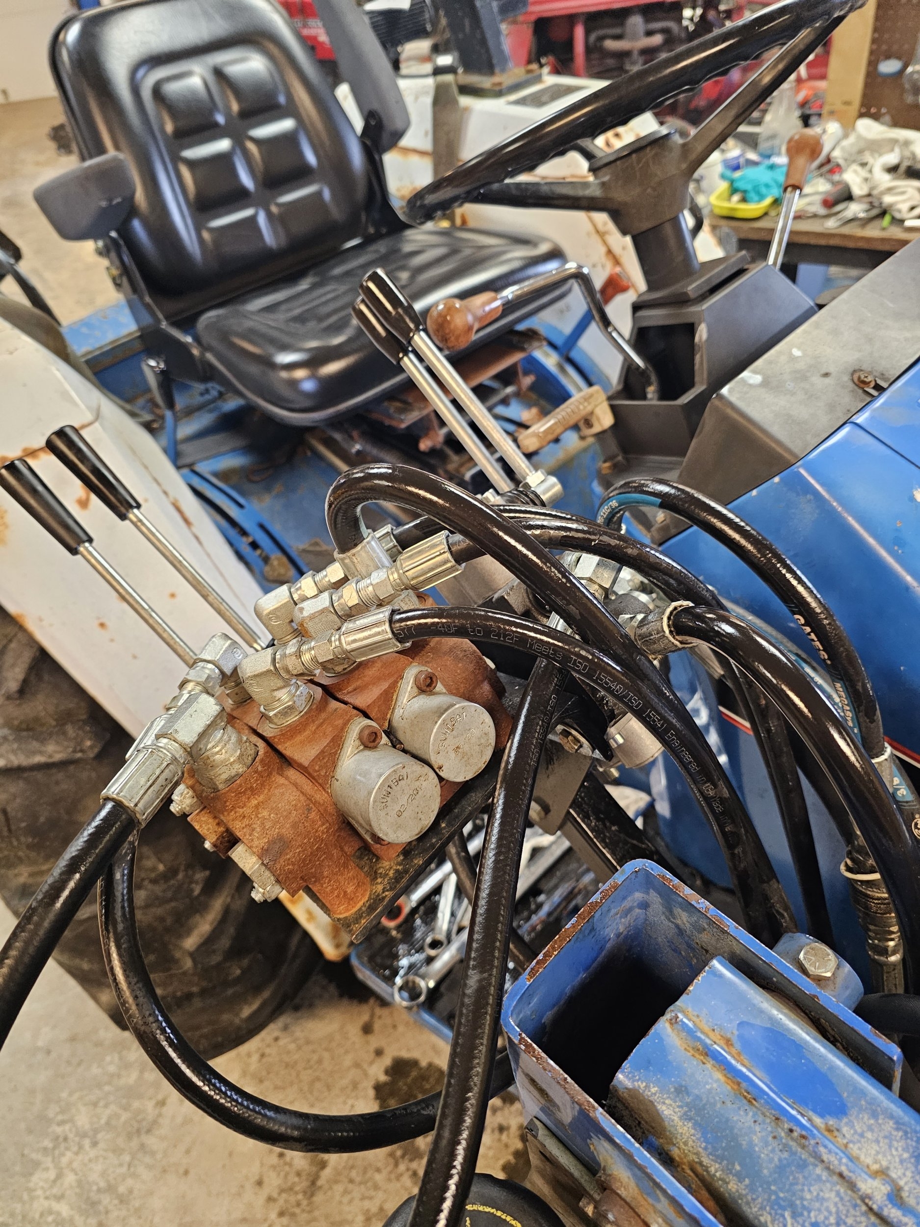

Ford 1720
Installed new loader 2 spool, bucket works, 2 rear remotes work, fluids are good, new filter. I've swapped lines and can't get the 3 pt to work. Am I missing something?

Did you get the right Power Beyond fitting/sleeve for your new loader valve?

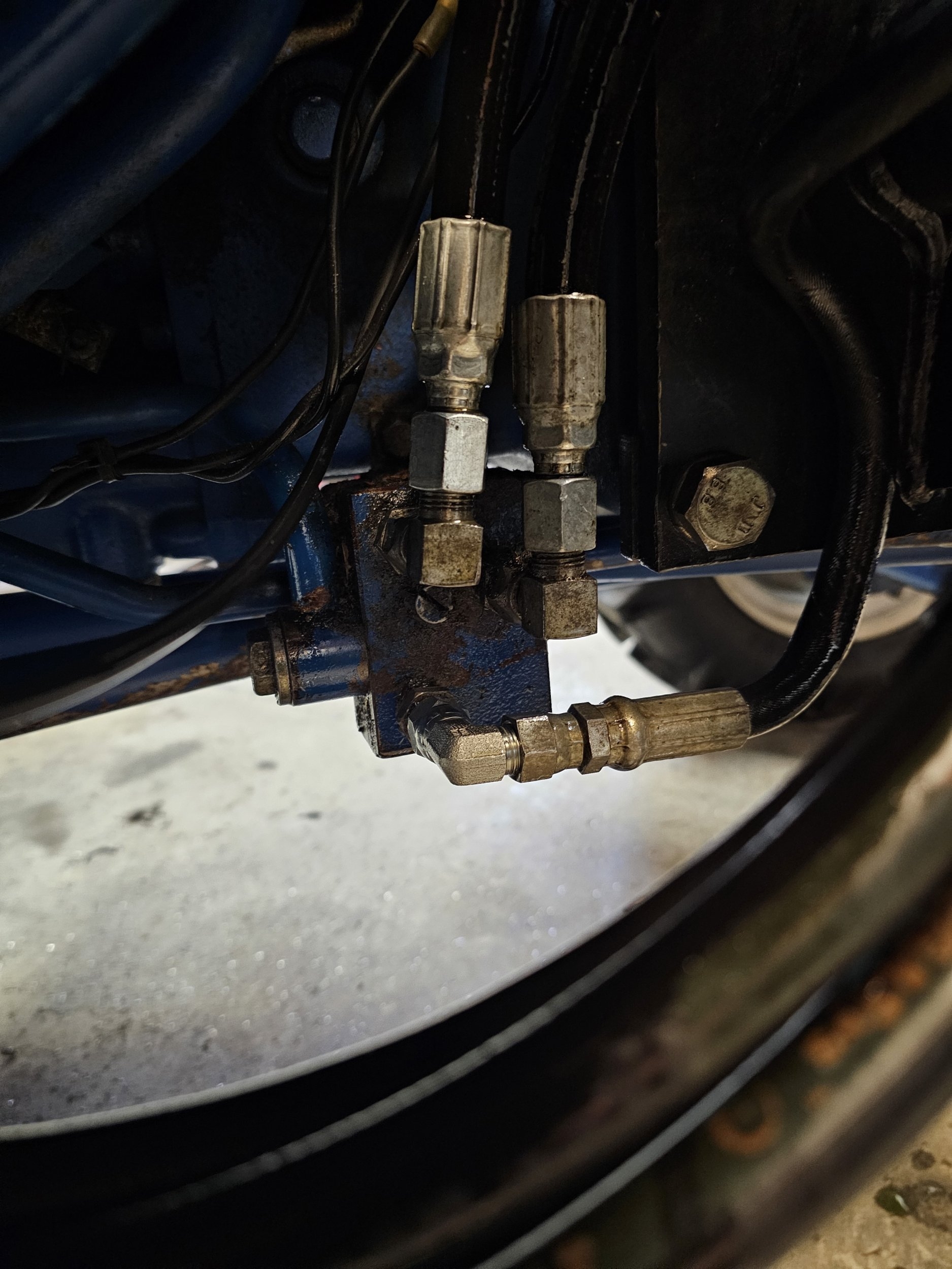

It's hooked up, it started out no loader, and the 3pt worked, got the loader to work and bam no hitch, it originally had a joystick but it broke, so I'm using a 2 spool from Amazon.

For giggles put the 3 pt. lever in the lift position then try one or the other rear remotes to see if it will raise. Just went through this on a recently acquired M-F To 35. It has dual remotes on it for a loader, but with a trip bucket so only one side of the remotes are used. Flushed the trans/hydraulic system and added new oil. Sadly, I disappointed when the 3 pt. did not work. Figured the pump was shot. Reached over and tried the loader valve just a nudge and started to raise, so I knew the pump was good then. For the heck of it moved the other remote lever and the 3 pt. hiked right up. Can't hurt to try it.
