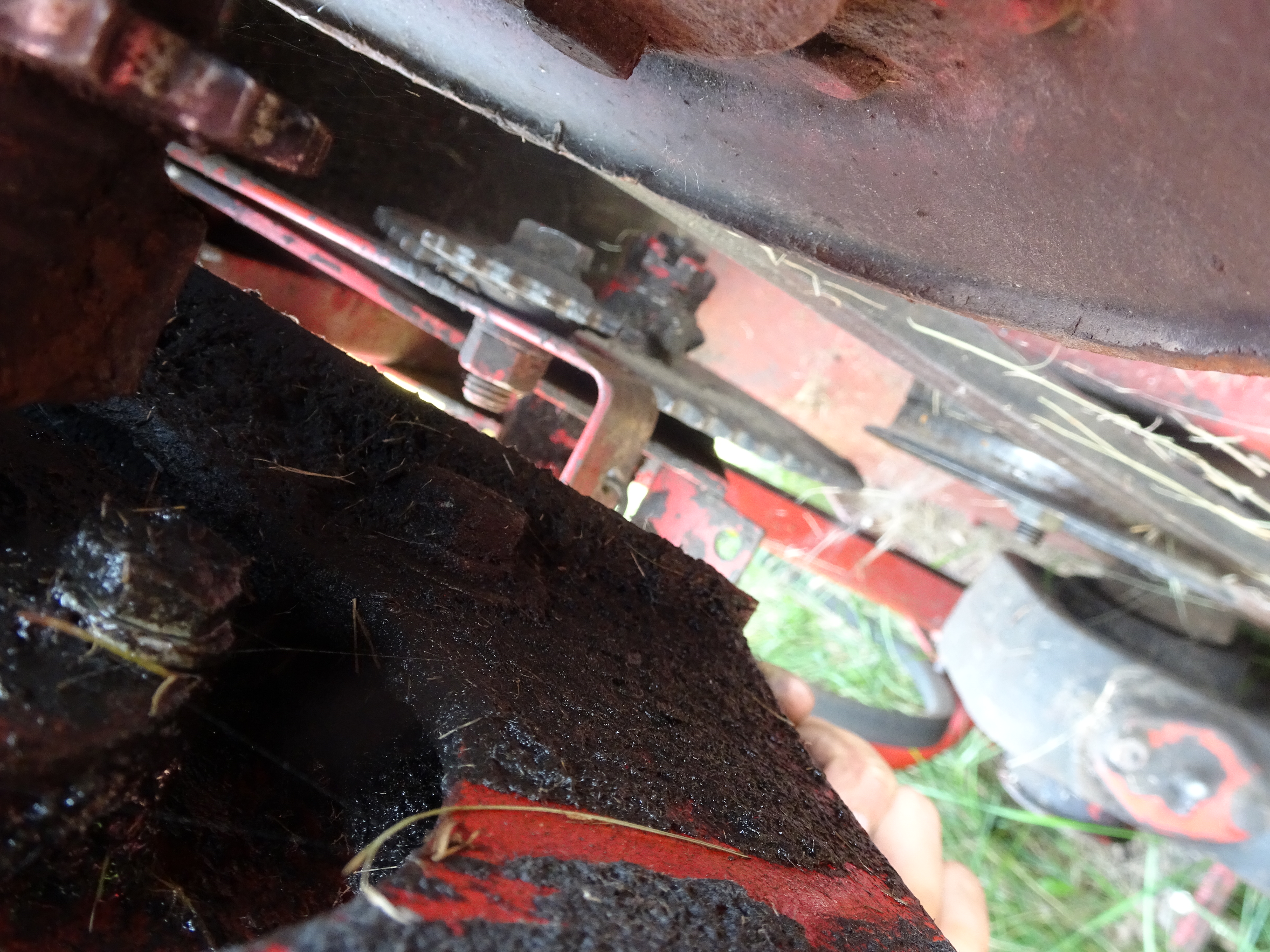

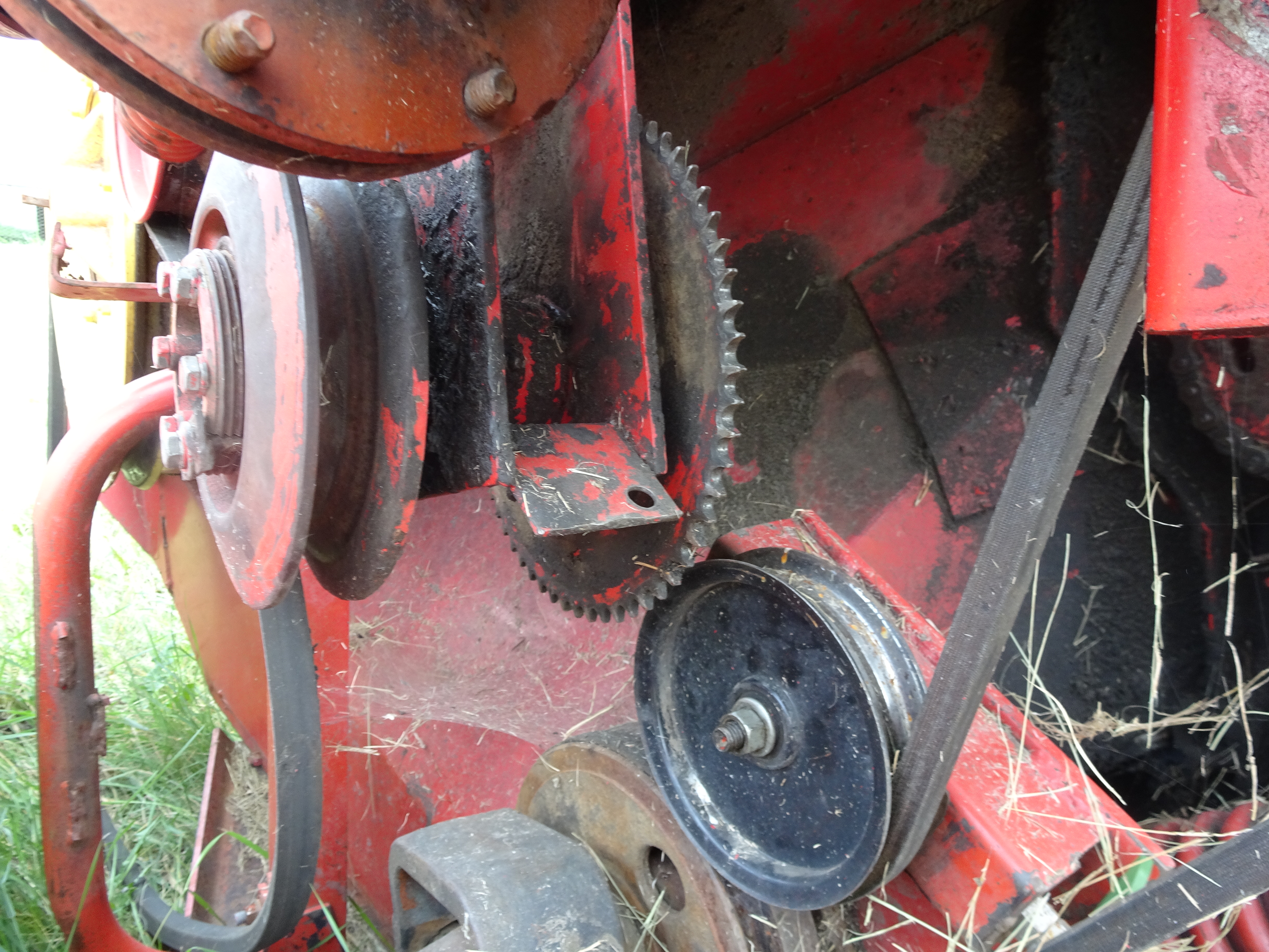

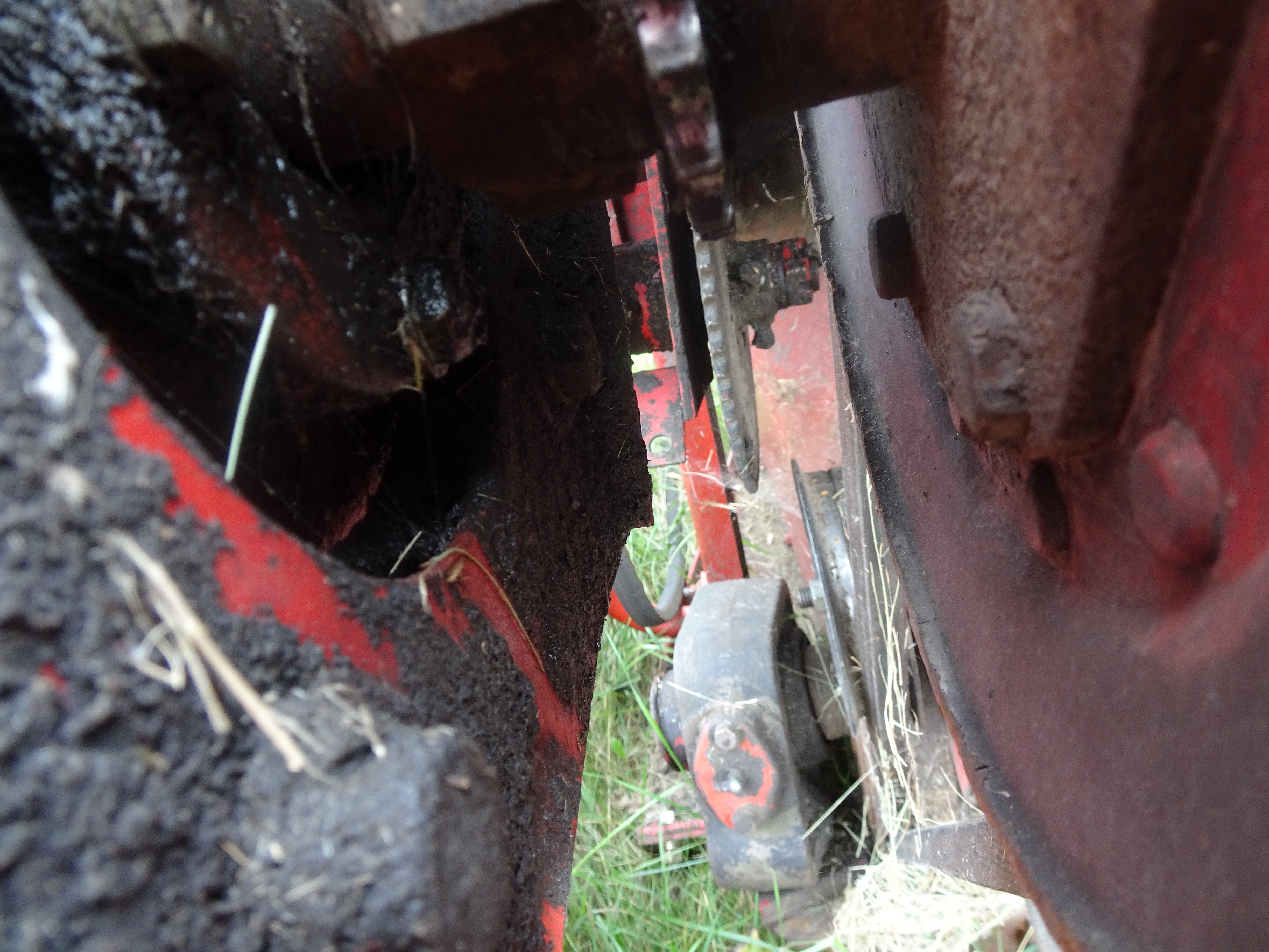

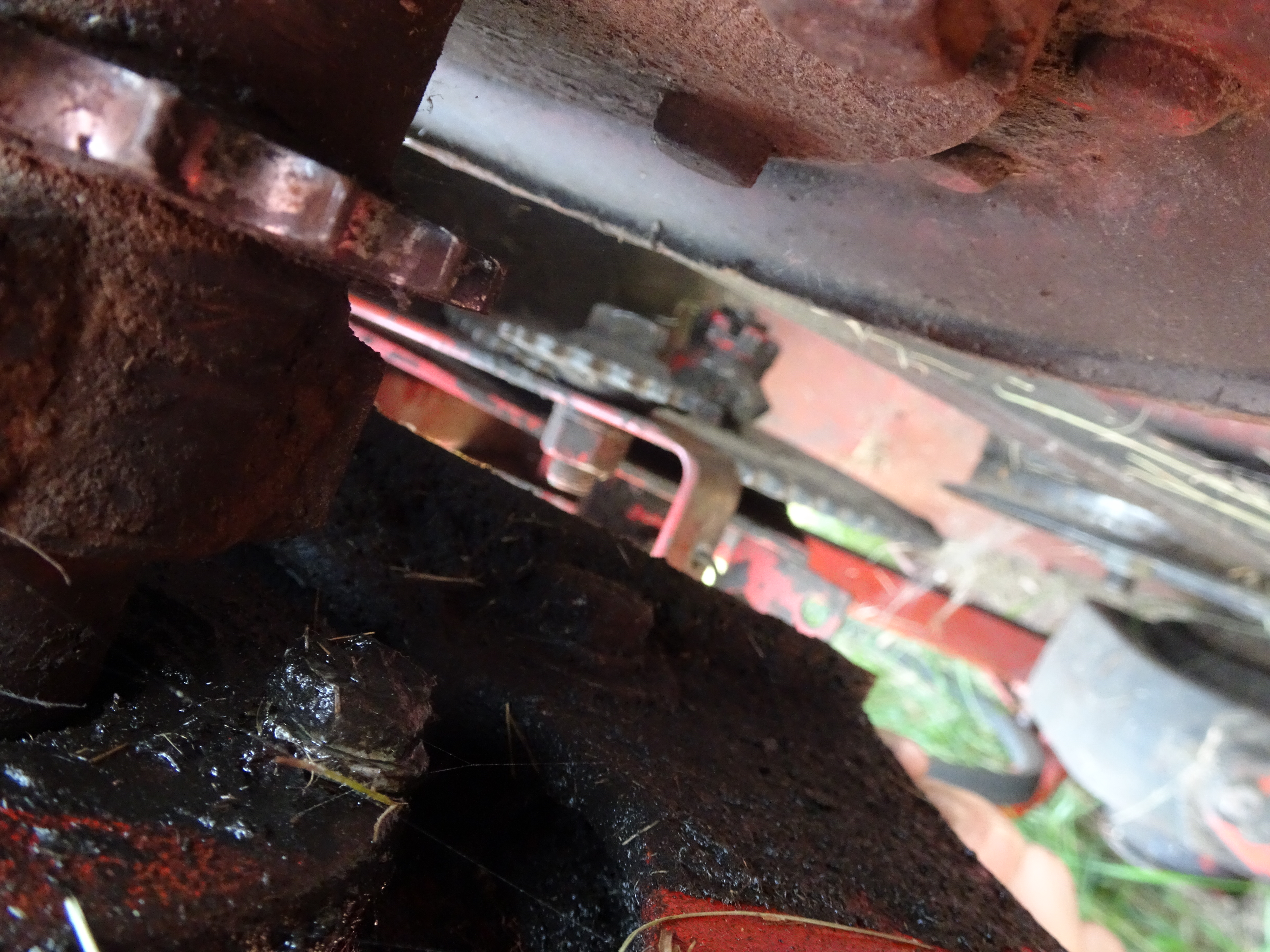

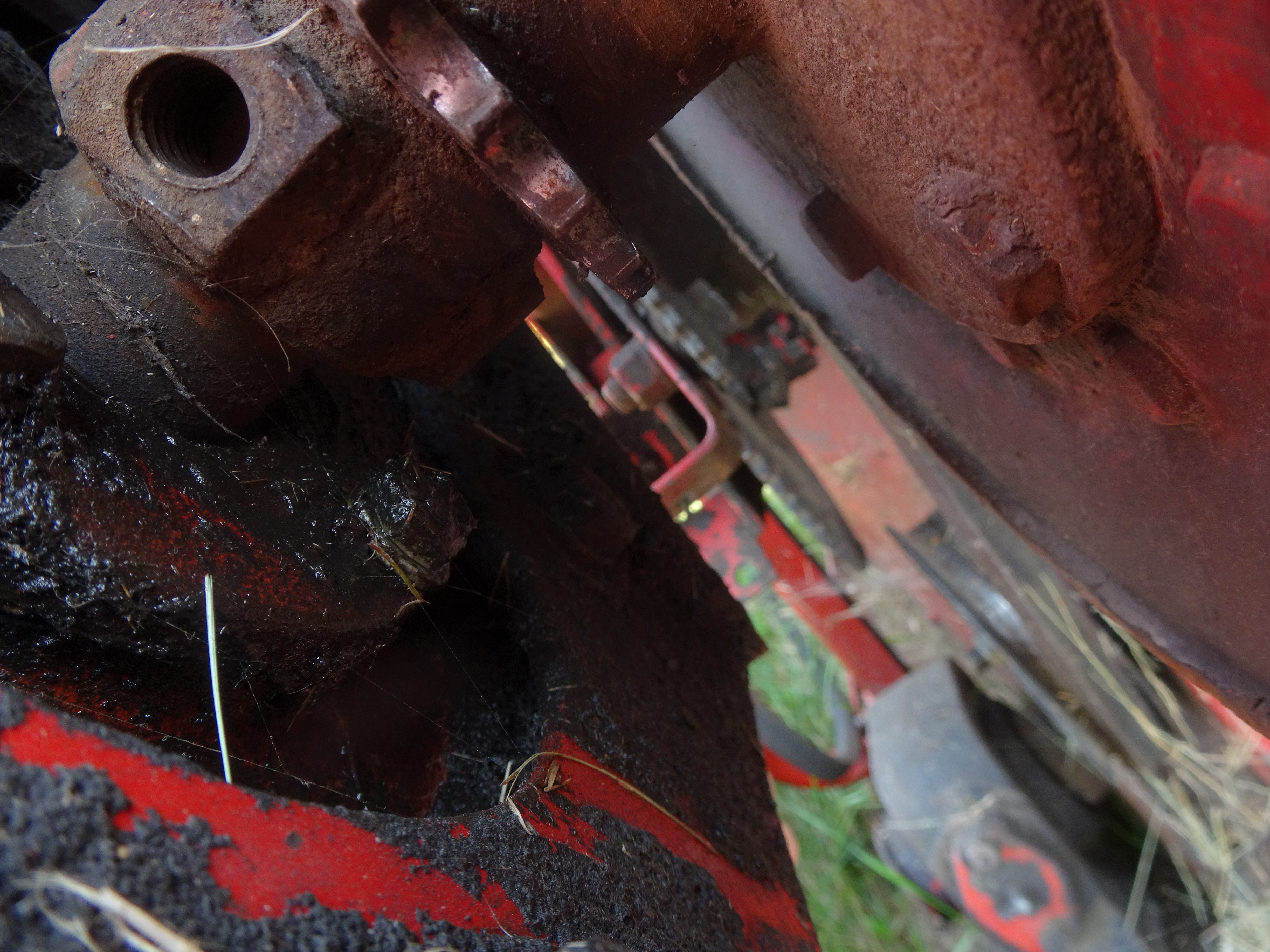

Hello all! I bought a NH495 haybine in fair condition for a great price this summer. Used it for about an hour and hit my first problem, the chain driving the reel broke (and then broke again immediately after fixing the chain) for whatever reason the large sprocket that drives the reel has become crooked relative the the smaller sprocket that drives it (and the idler sprocket as well). The bearings on the big sprocket are fine and the bracket that holds the whole thing doesn't seem bent, so I'm really not sure why its suddenly out of alignment (surely it wasn't running like this for the hour or so i ran it) or how to fix it. Any idea's would be much appreciated! Thanks!

Me thinks the sprocket that is mis-aligned is mounted backwards. Was easy to grease but out of wack with the rest of the world. Flip it around.
