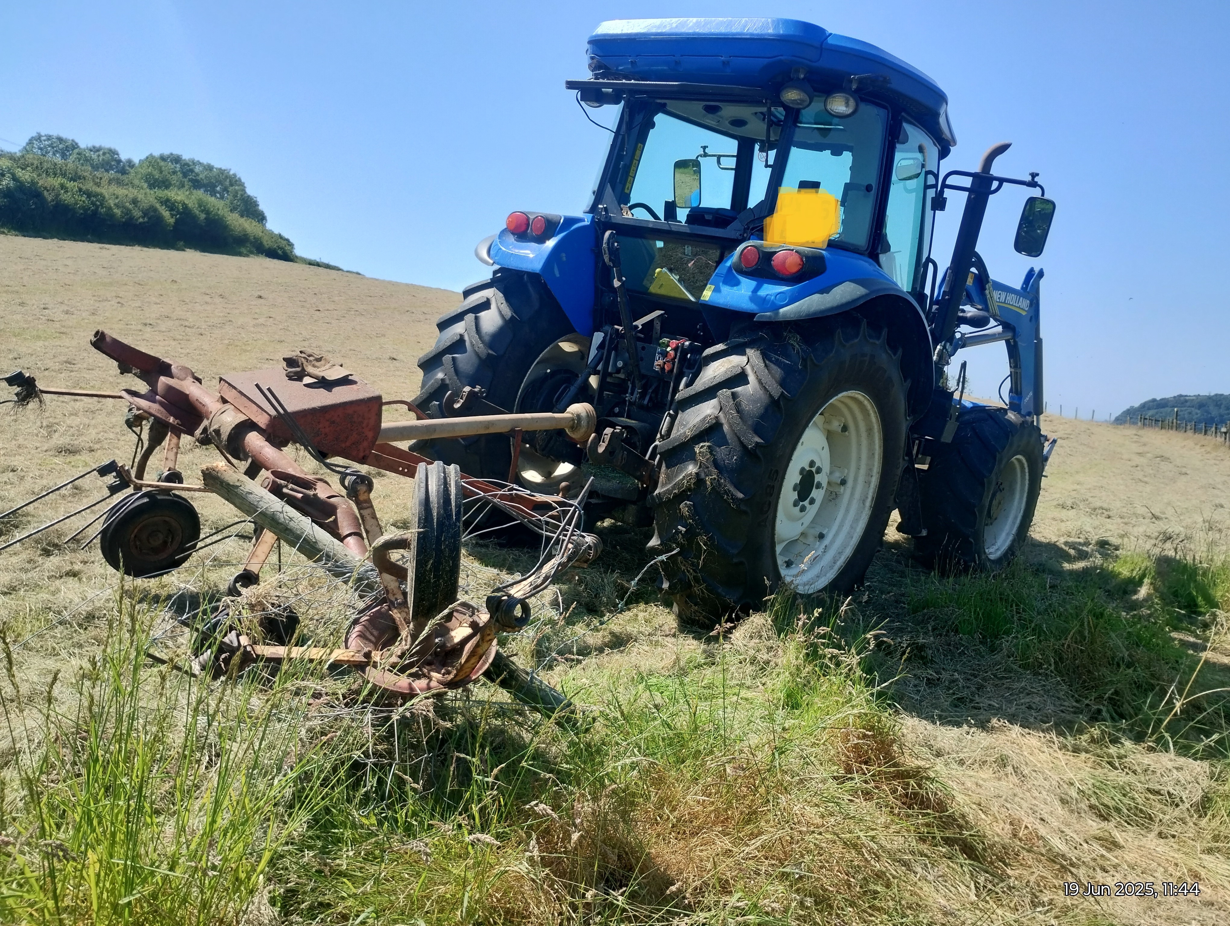

Finally, a warning to other newbies out there to be very careful with your implement! The tractor has been brilliant at our small type of farming and I was actually looking forward to tedding hay a couple of months ago. The contractor had a massive Massey with triple mower and could only just get it through the gateway as the entrance was 90 degree turn from another gate to the road. He suggested I remove some fence as the rake and baler could not get in there. As the fence already had a joint in it, I did so and "secured" the two parts on the outside of the field. Except one half was not that secure and I did not notice that the fence had jumped back into the field. Result: lots of banging noises, snapped fence and post and knackered tedder. Photo attached! (I was shaking like a leaf but no real harm done to the tractor.)
