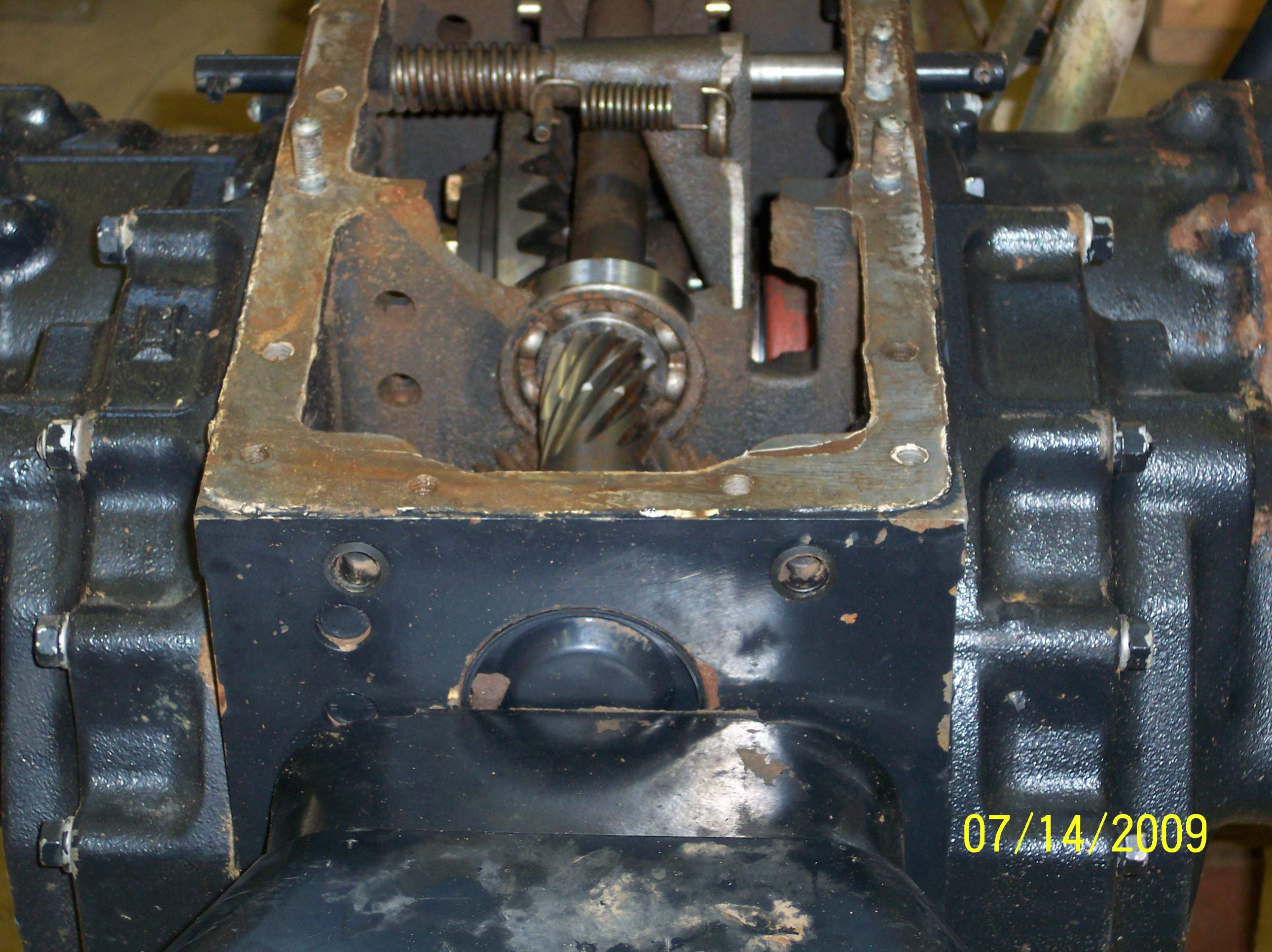

New to TBN and this is my first post. I bought a NH TC45D with a 16LA Loader and a Bradco 509 backhoe. The tractor has 1600 hours and the backhoe has little use. When I bought this package it was for the right price since the rear transmission was trashed. The case has been broken on one of the webs that houses a bearing. I am assuming this is from the backhoe as is the local NH dealer. I have found a used rear transmission case that is far less expensive than a new one from the dealer. My question is has anyone tackled the job of swapping out and rebuilding the rear transmission. I have turned a few wrenched in my day so I am not worried about that. I am wondering if there are any secrets or pitfalls to avoid. Thanks for any advice. Looking forward to being TBN member.
I sure would like to see pix of the break in the case. I would guess that
the Bradco hoe was mounted on the 3-pt hitch, rather than on a dedicated
subframe.
What kind of deal did you get and where was it?
   / NH TC45D Transmission Rebuild

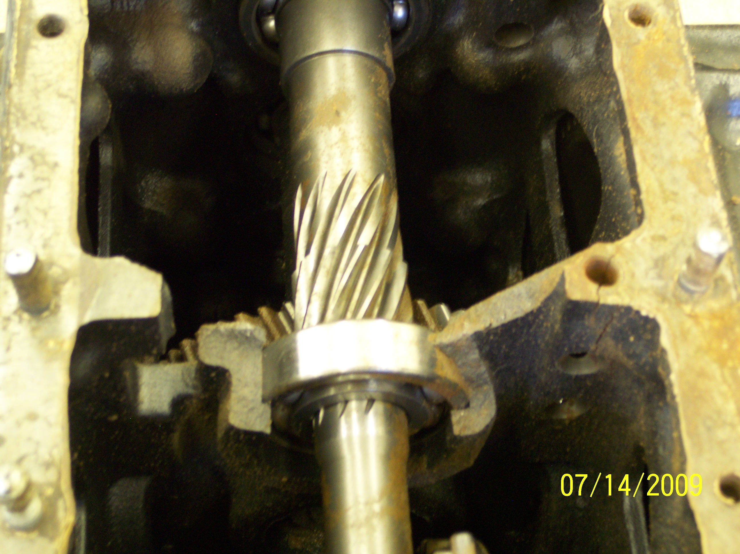

Thanks Mike I did get a copy of the parts manual so I have some good drawings. I looked into a service manual and they want $550 for one. Seems steep since that is about 1/4 the cost of a new case. Although a step by step might be nice I am a little reluctant to spend that kind of money on the book. Although I am only about $5000 into the whole unit with the backhoe I am gun shy on spending too much before I get a sold game plan and a good source for the parts. Here are a fedw pics of the case and where it is broke. I will try to get some better ones of the whole project. I might start a project thread too on the project page.

   / NH TC45D Transmission Rebuild #5
I have never heard of a manual that expensive, and I have bought many,
never for more than $150.
Its very rusty in there! Not a good sign.
Yup $529 since its OEM. No market for knock off books on that new of a tractor. If you have a good source let me know. No big deal on the surface rust. Its not pitted and remember the whole case is scrap. I has a good coat of oil until the heavy works starts.
   / NH TC45D Transmission Rebuild #7
I sure would like to see pix of the break in the case. I would guess that the Bradco hoe was mounted on the 3-pt hitch, rather than on a dedicated subframe.?
I'd bet the same thing. It wouldn't be the first time it happened. Some of the dealers around here won't sell a 3 ph backhoe for this reason.

#9
Djausin I pm'd the info. Thanks again. I found out from the dealer that the cause of the break was a PTO shaft that was too long. Got quoted $2600 for a new case from the dealer. OUCH. Still working on a used case from a local tractor junk yard. I'll keep ya posted
