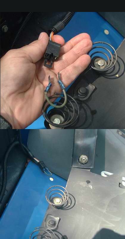

   / NH TC35D Bad Safety Switch.....But Which One ?? #3
I agree with RickB that the seat switch is the culprit. Remember, you can start your tractor out of the seat if it is in neutral, the PTO off, and the parking brake is set. As soon as you change any of those things with a faulty seat switch, the engine will shut down. I think if you change or repair your seat switch, you'll be good to go. For a temporary fix, you can remove the seat switch plug and jumper between the two wires in the plug to simulate a closed seat switch. Mine has been that way from when I bought my tractor, but I would not recommend that to anyone else except as an emergency issue.

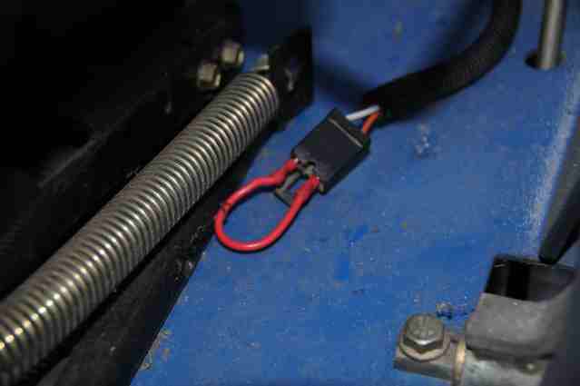

You guys are right on the mark AGAIN. :)
Did the jumper routine on the seat switch & voila....... tractor is just a hum'in dynamo.
