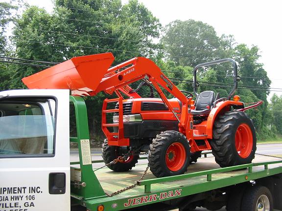

Thanks for all the info....I finally made a purchase, see attached picture to see what decision I made. If anyone would like purchase details, please post.

You made a fine choice. Congrats! /forums/images/graemlins/cool.gif
   / NH TC33DA vs. Kubota L3130DT #7
Congratulations on your purchase! I am sure you will get many hours of work/enjoyment out of this tractor.
OrangeGuy
   / NH TC33DA vs. Kubota L3130DT #8
Congratulations on your new Kubota. You won't regret it.
