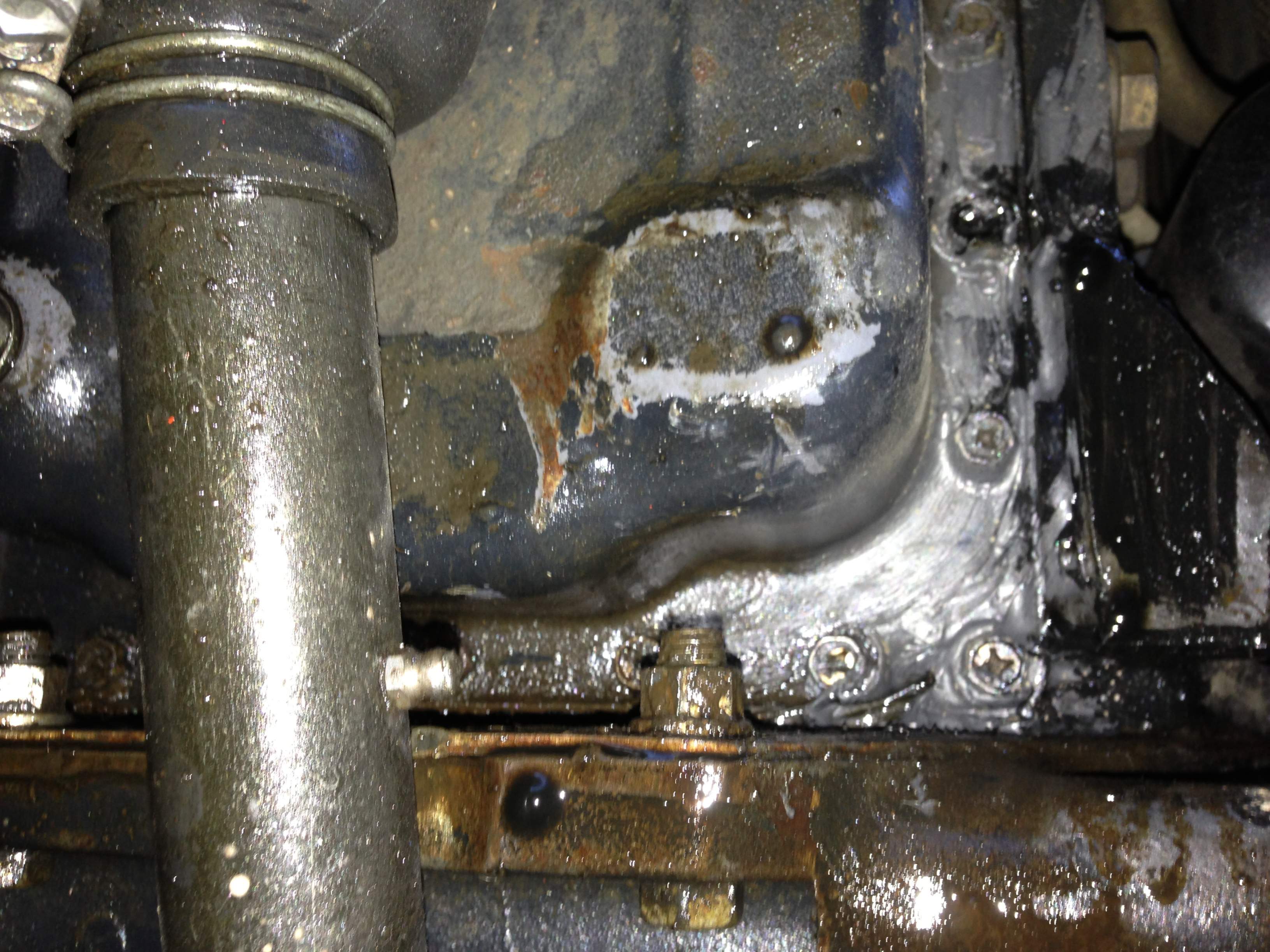

For #1 -brin - what hose is this called if you know, or what does it control? I'd like to open her up and fix it. It seems like its coming from a panel behind the engine. I have included a picture of the underside leak for what its worth.

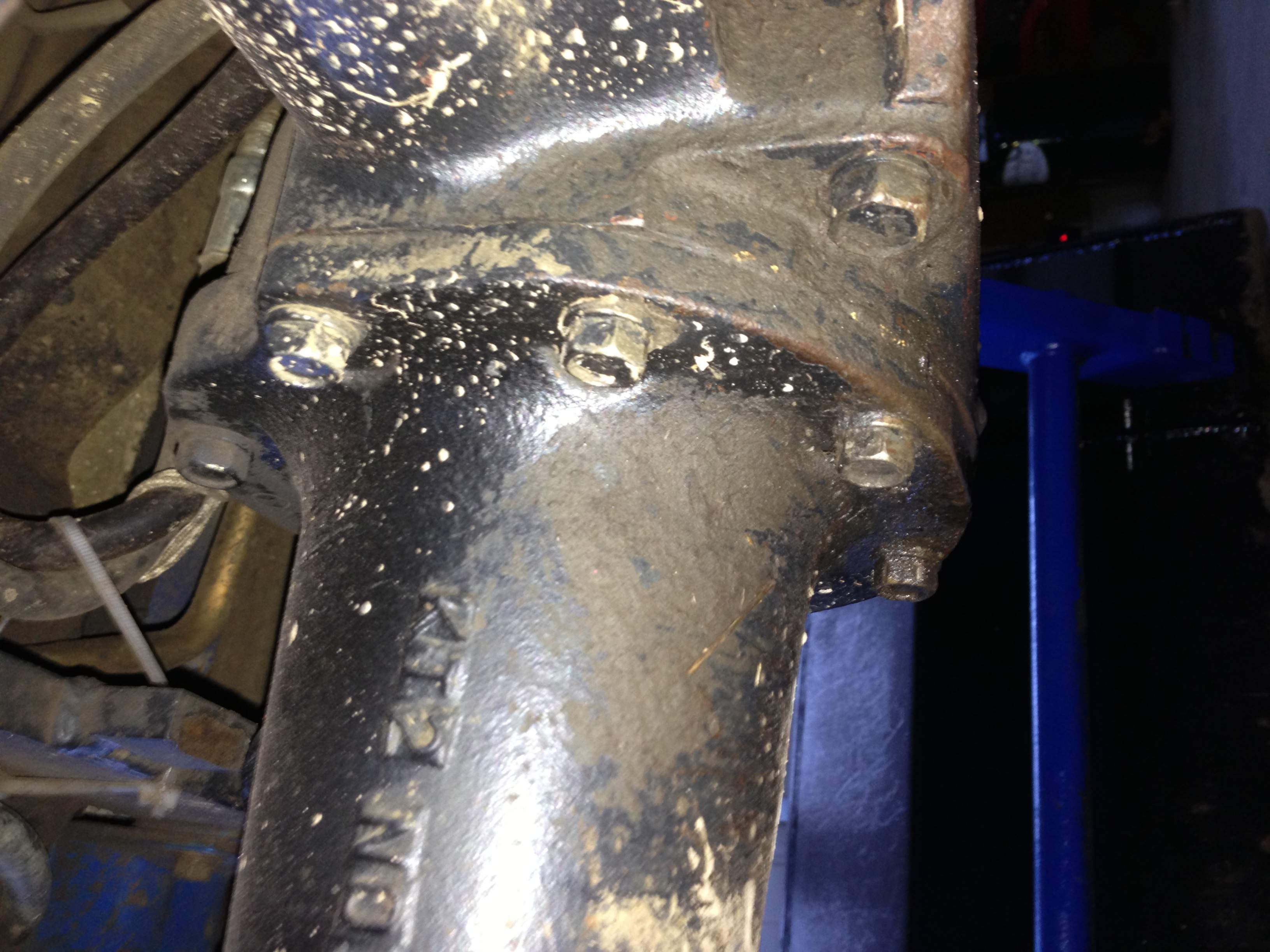

Also, I have a leak from the front axle, call this issue #5. I've included a picture of this leak as well. How bad is this repair? Open it up and RTV it?

#1 - It is a hose to the power steering tank under the hood...a small leak like that is annoying so when you fix yours come and fix mine...:)

#5 - I have not had a front axle leak yet...can't be too bad to repair ..probably a gasket or o ring.

I have pulled apart the dash and found the power steering pump had a line repaired. The good news is this is not where the leak was coming from. It seems the leak is from the oil pan, or from in between the engine block and the transmission. The oil leaking is somewhat clear, and pretty sure its not oil. I've cleaned the offending area with hopes this will show where the leak is.
Also cleaned the front axle with hopes this leak was from a previous owner filling.
