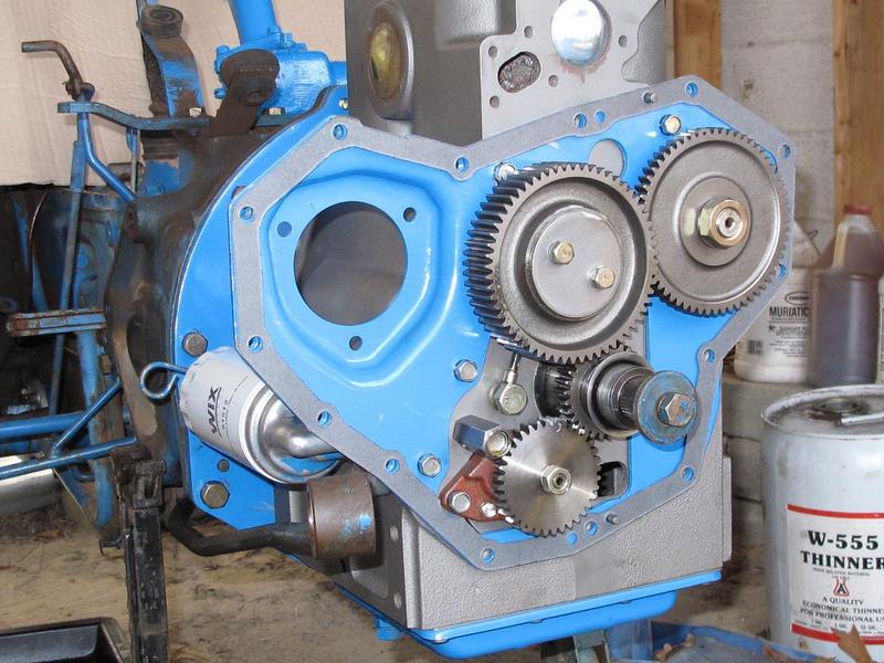

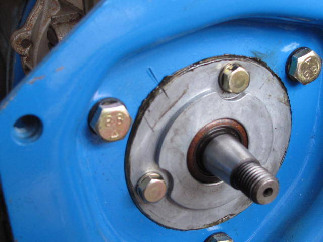

I have not but the pump injector fuel distribution and metering is certainly timed. inside the timing gear cover you have camshaft gear, crankshaft gear and oil pump gear. They are all timed and meshed constantly. There is timing mark on the gear and the housing to line them up. on the pump bracket if you notice when you take the bolt off there is a slot rather than a hole. The reason for that is that you can rotate the whole pump CW or CCW for a few degrees. If I were you , I would put a witness mark on the pump housing and the engine block timing cover. You want to make sure that you do not move , start or jump the tractor to maintain same timing as you had previously. On my 1700 i used scratch awl and dremel tool to put my witness mark if I ever need to do it. The assumption here is that you have a mechanical pump and I am 99% sure you do.

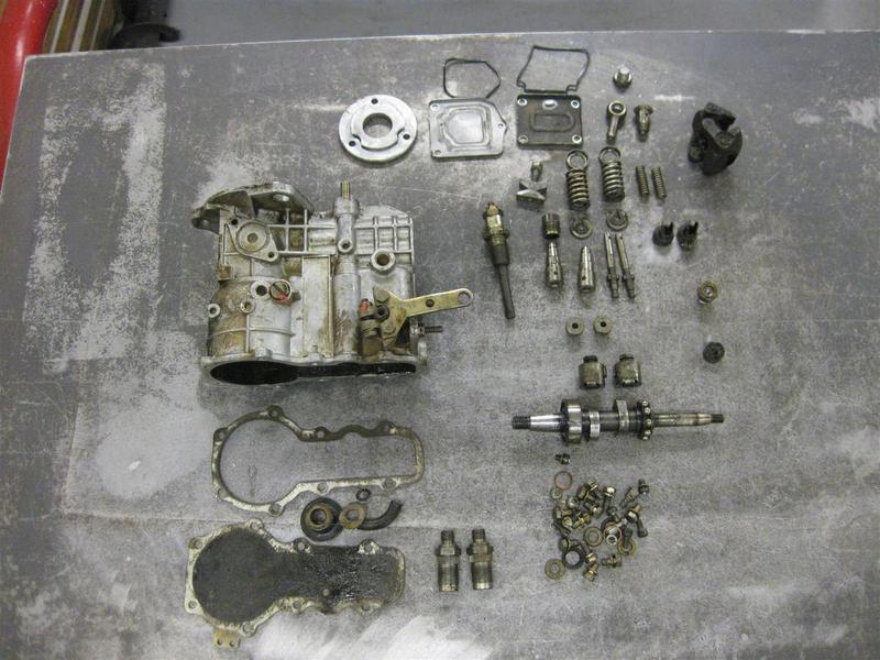

He might have. As I said what I said was just a general outline. Saying that, I went to NH website and looked up TC-30 injection pump. A lot of components of the pump they do not identify as if they want you to buy whole pump. In ways it appears to be the same of what I have my 1700 with the exception of 3 discharge/ injectors for TC-30. On mine and it appears from design the pump is driven by it's gear that is permanently meshed with oil pump, crankshaft and camshaft. The gear is coupled to a pump input shaft. This shaft in turns has lobes (like a camshaft) that reciprocate pistons to pump the fuel to the injector same as a positive displacement reciprocating pump. Below is the innards of my pump just for reference.
