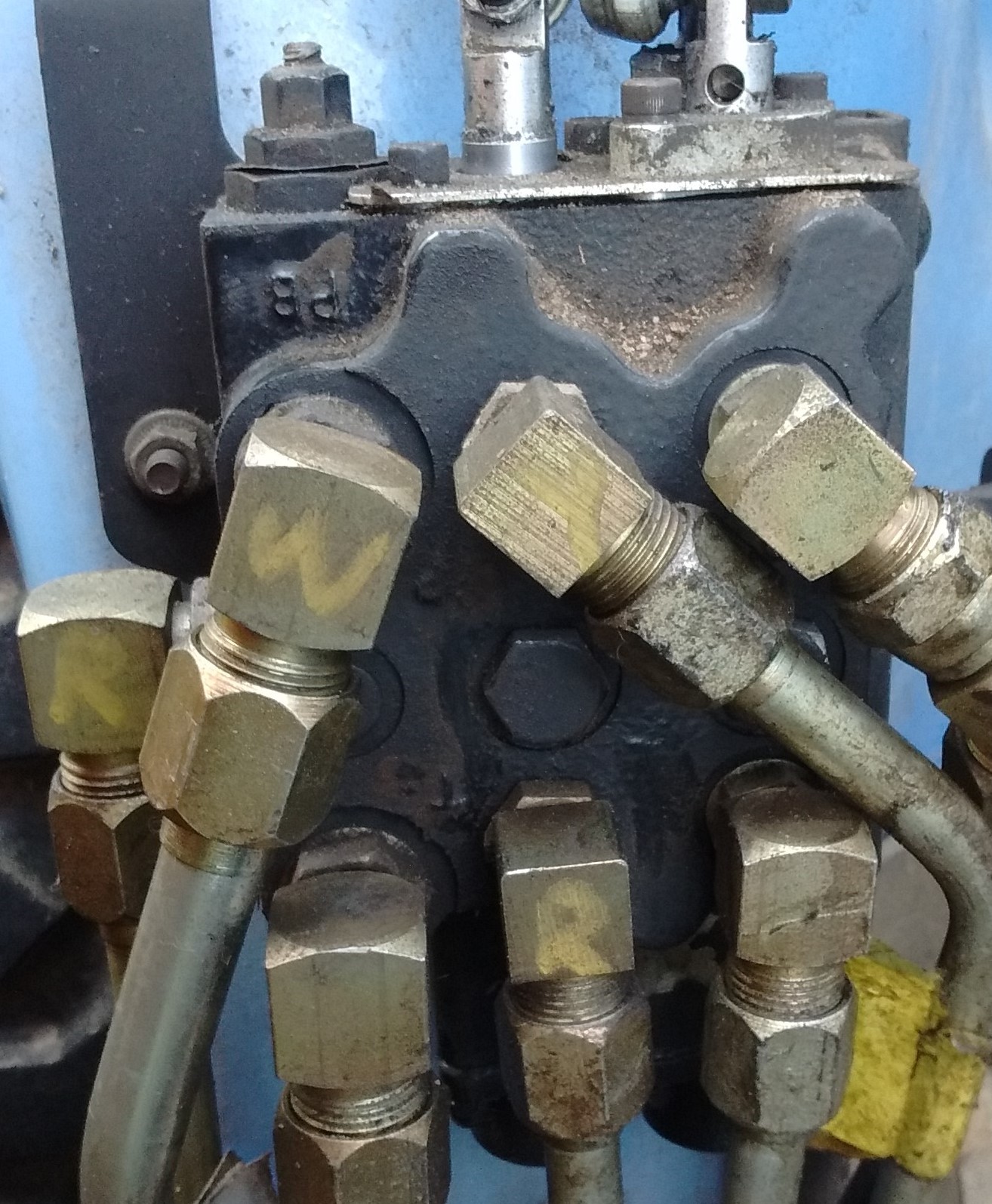

It was recommended to tap into power beyond at the joystick. I'm a newby to hydraulics. I've attached photos of my joystick. Anybody recognize the joystick (it is not as shown on my parts diagram)? How to get power beyond? Thanks.

And another angle of the joystick:joystick2.jpg

If I am seeing things correctly your joystick has 7 hoses connected to it.
What this means is that you are already utilizing the Power Beyond capabilities of your loader valve.
I marked up your photo to show the letters PB for power beyond.
All is not lost however. If you buy your next valve with the power beyond feature (remember there is an optional sleeve or plug that must be installed to activate PB) then you can feed the next valve's IN port with the power beyond from your existing valve.
Then you use the new valve's PB port to feed the original power beyond hose that you disconnected.
I know this is confusing so please ask more.

Thanks Dave. Actually your explanation is clear. My new valve does have power beyond. So, I remove this pipe, take the PB from loader valve to new valve, new PB to the hydraulic block.
Any experience with using pipes? I have none and it seems replacing with a hose would make routing easier. Thanks again.

Steel pipes are not easy to alter and most will switch to hose when making changes.

Roger that Dave, I'll switch to hoses, thanks.
