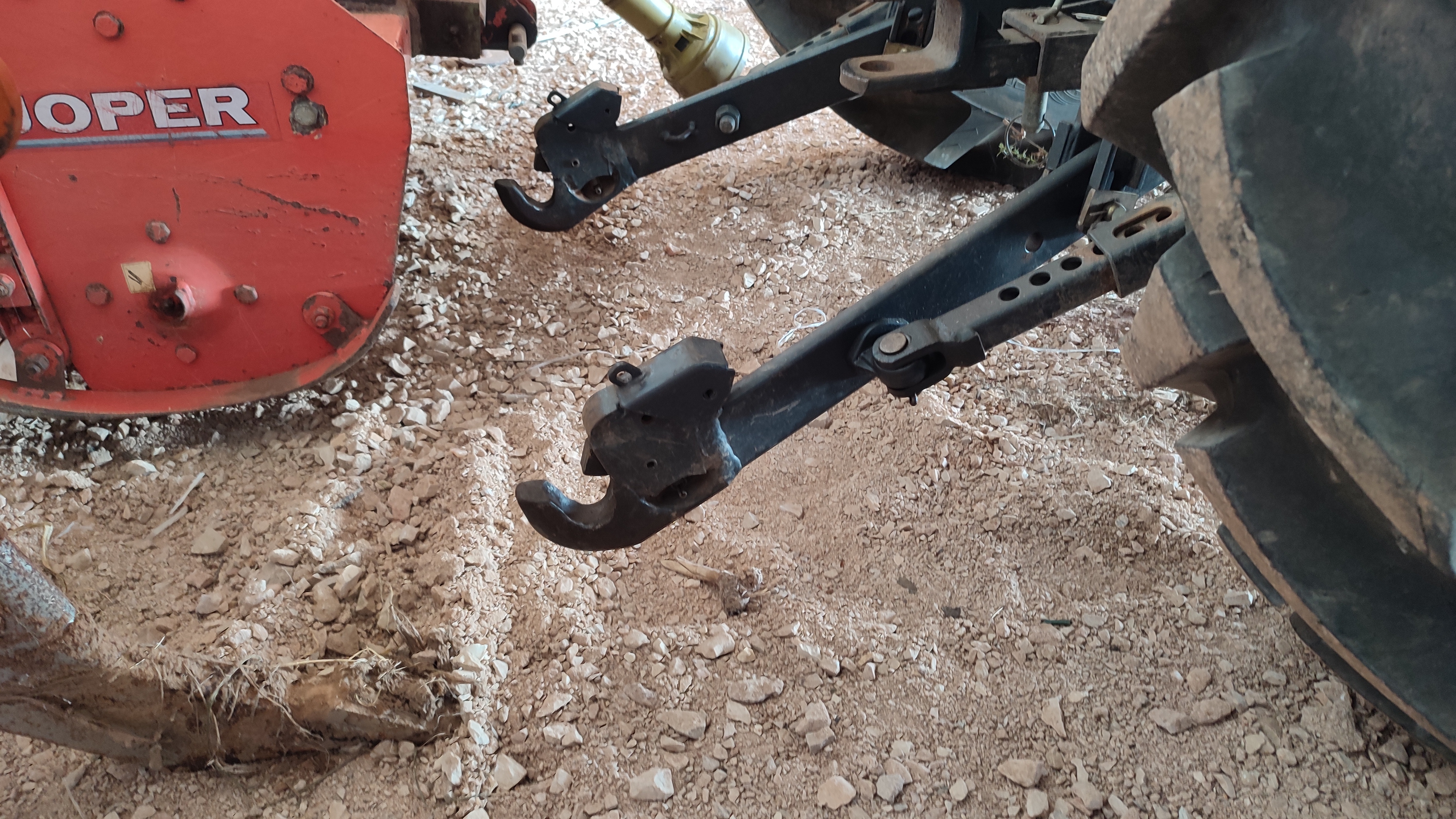

I am curious how long the 3 point lift arms are with extension links c2c on a New Holland TC29D or TC33D. I want to add this type of arm to my Ford 3000.
   / NH TC29D or TC33D 3pt lift arm length c2c with telescoping ends #2

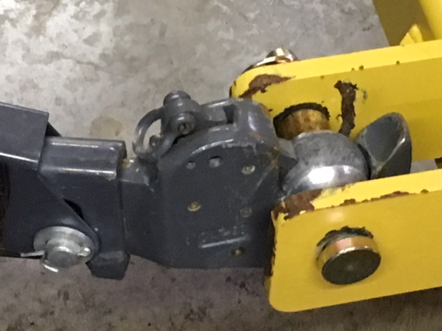

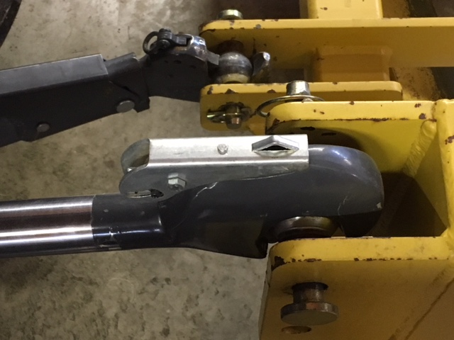

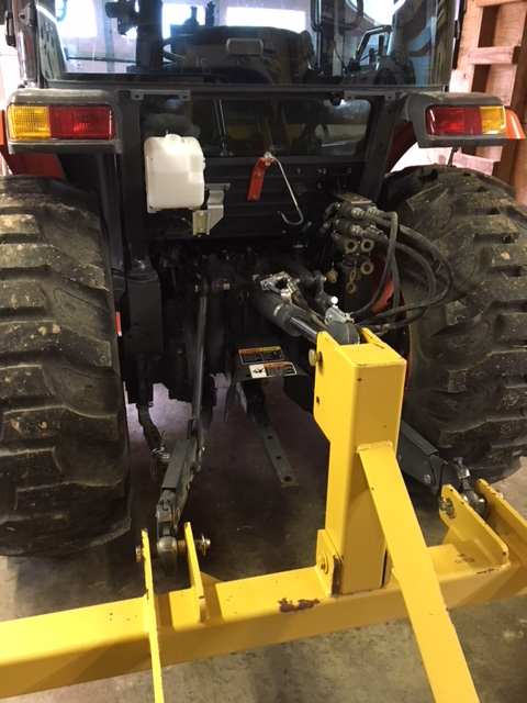

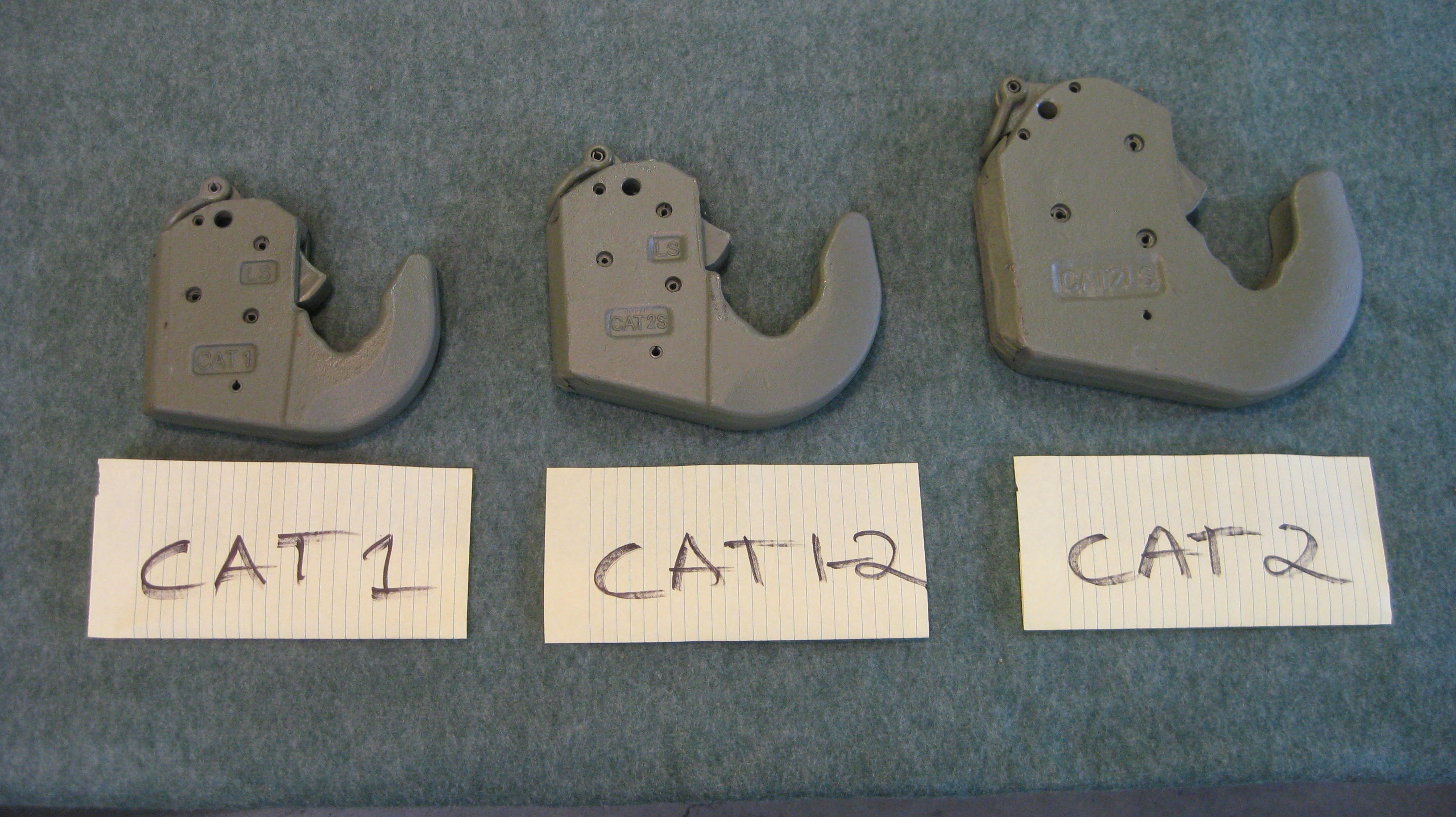

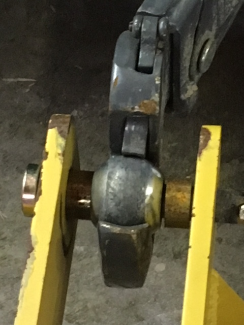

Not that these are the same, but the Euro hooks work quite well and would be welded to the draft links that you now have.
These typically add about 2" to the length.
Just another option to consider. :unsure:
