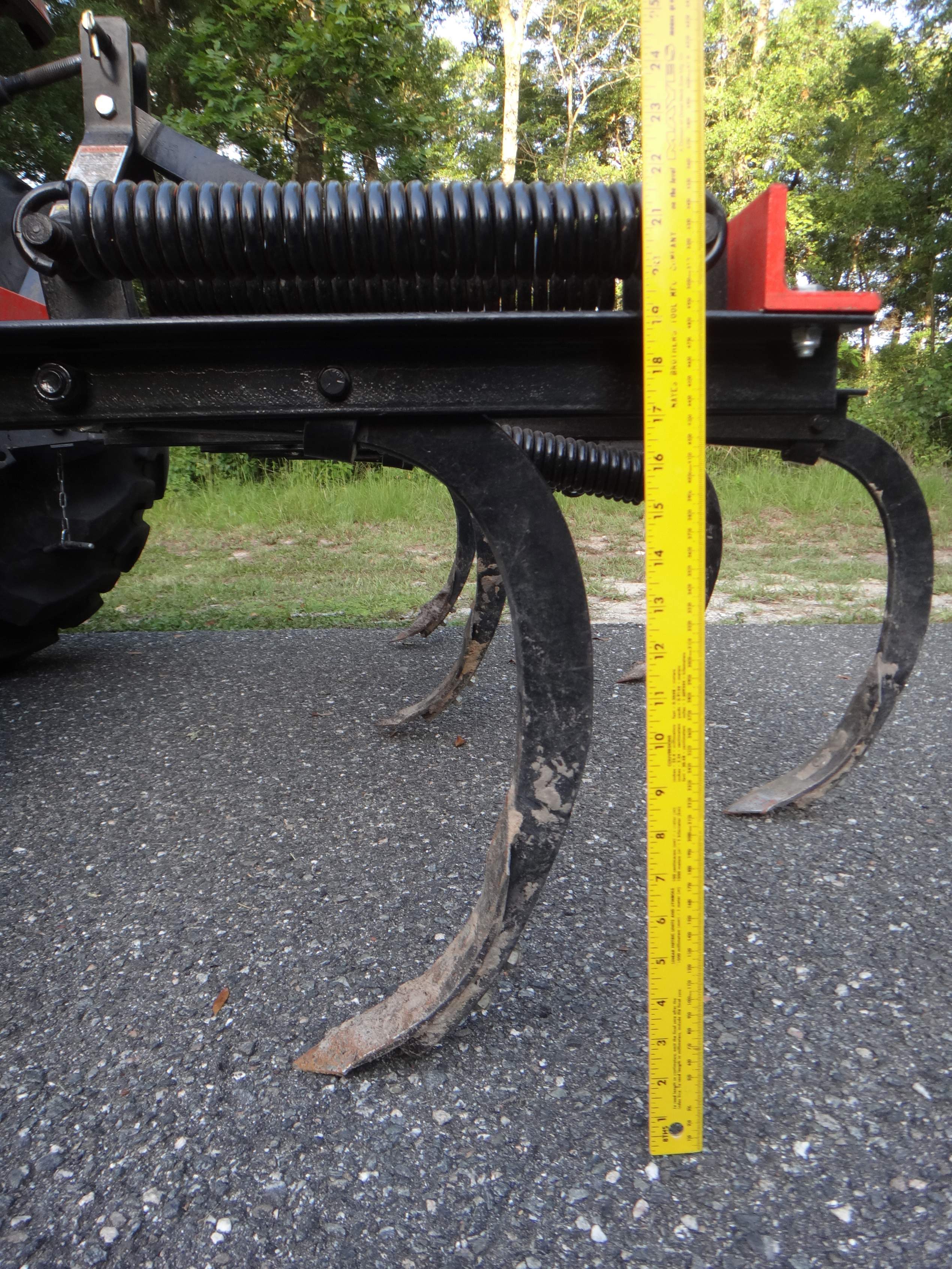

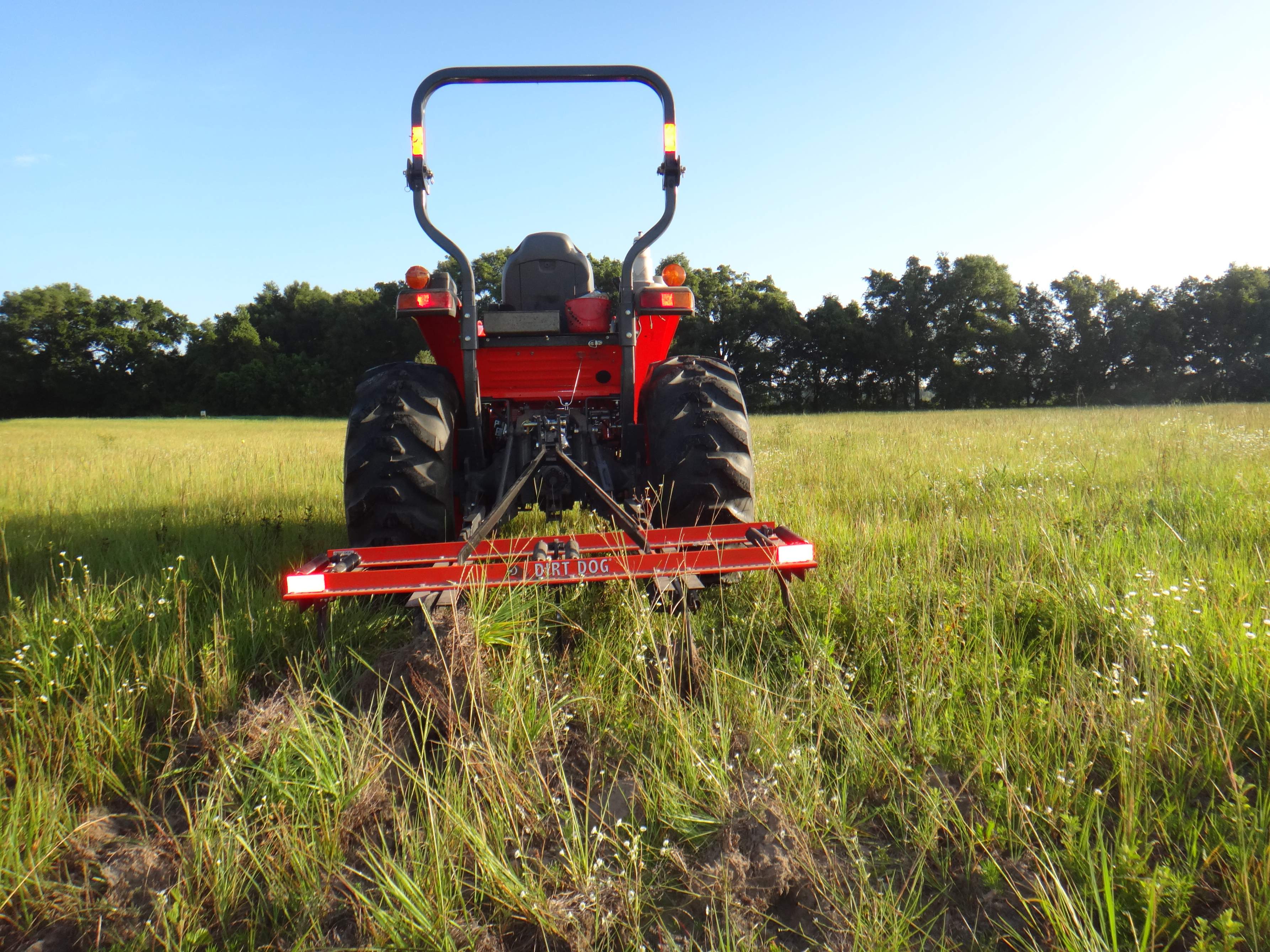

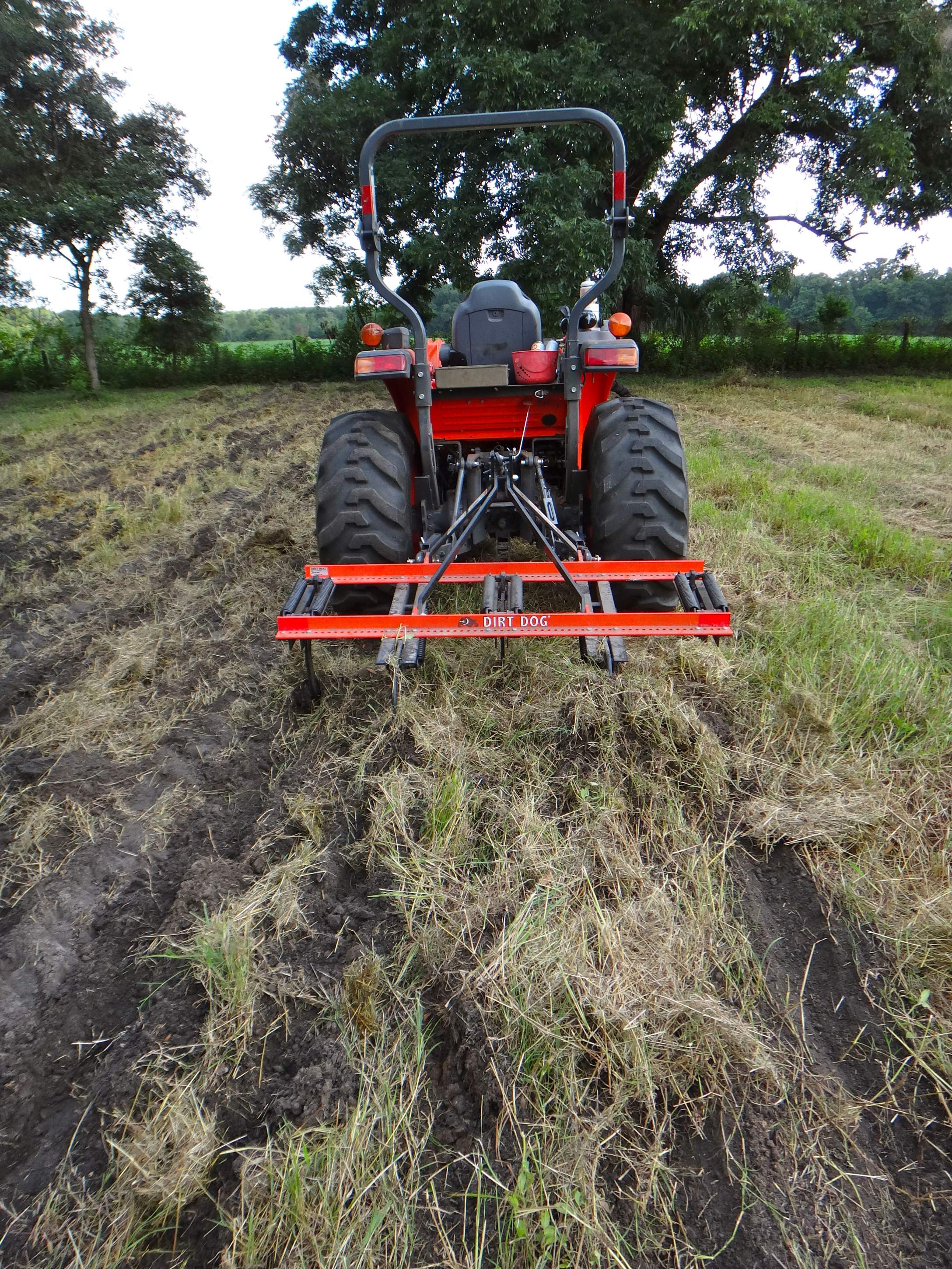

You will need a plow sized specifically for subcompact tractors. Though you have a standard Category 1 Three Point Hitch, the frame of a standard moldboard plow is too long and will collide with tractor frame with a lot of inertia. Standard plows are designed around 12" ground clearance. Your T1110 has less than 8" ground clearance.
I suggest you consider a PTO powered roto-tiller in lieu of a plow and disc harrow two implement combination. I do not think your 1,500 pound tractor can pull a Disc Harrow heavy enough to be effective at smoothing plow furrows. You may wish to plow, then smooth furrows with the roto-tiller, which will decrease the "breaking" load on the roto-tiller.
Another alternative if ground is not too hard nor too rocky, is a spring-protected Field Cultivator in lieu of a plow and disc harrow. You can pull a four tine, possibly a five tine model with 28-horsepower. You would have to discuss potential to clear ground contact with <8" ground clearance with the vender.
Do not plow so deep that you mix infertile subsoil into relatively fertile Top Soil.

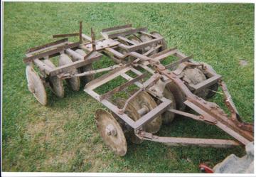

I used to plow (1 single bottom plow) with my 1948 8 hp Farmall Cub. I also used to harrow with it using this International harrow (pic from online) i1394.jpg You can set the angle of the disks for the amount of bite you want. It did really well.
When I got my TC30 I used that for plowing and disk harrowing. It was extremely easy for my 30 hp tractor. I did a few passes with the harrow until I liked the way the dirt looked. Then I planted. (I also use the harrow to recondition my gravel driveway when it gets grown in with grass,)
I roto till now with a 5' tillovator from agriworld that I bought online and had delivered. The rototiller is a little harder on the tractor, but mostly because I am doing it at a higher rpm.

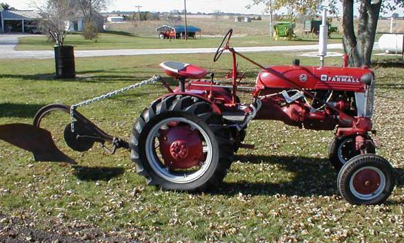

This is a Farmall Cub with the type of International plow I have.
I like this plow. It has a sprung mounted arrangement that bolts to the drawbar. It is raised and lowered with a chain to the top link. The angle/depth can be be adjusted on my TC30 by raising and lowering the drawbar. With this plow I can plow in circles if I want to.
