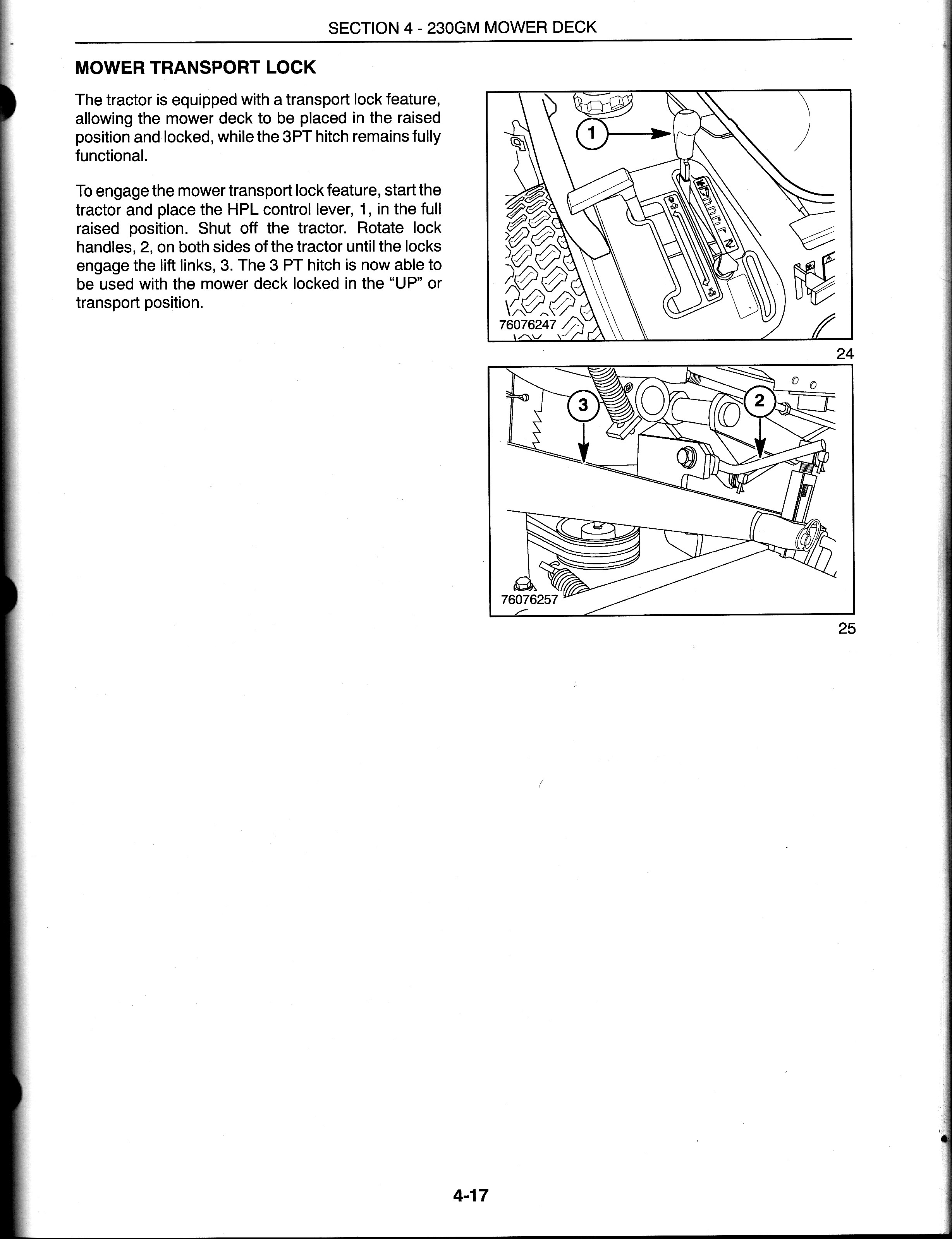

I have owned my T1010 for a few years now. Love the tractor. However, I was in a hurry and forgot to connect the drive shaft to the front pto last year and raised the deck. With the deck not up all the way I adjusted the deck height. Ever since then when I lock the deck it still lowers about 4 inches. I know when it was brand new the deck would drop just a few inches before the lock would catch the deck and the 3 pt arms still go down.
I have looked under the tractor with the left rear wheel off to see if I can tell what seems to be the problem but can not see where anything is bent or not catching. Does anyone have any ideas on what to look for?

The manual doesn't say much about that transport lock. I am sure that is what you mean. You want to lock the mower deck up, so that you can use the 3 point hitch. Other than that, the mower deck moves up and down with the 3 point hitch at the same time.
Since I don't have the belly mower for it I can't help you much other than give you a little copy of that what I have in my Owners Manual. It explains how to set the lock with a couple of pictures with it. I am sure it has either something to do with the lift links that are either bent or not set proper, or the mower deck doesn't raise high enough, thus the deck needs a hight adjustment set propper.
The last pic explains how the transport lock works.

Thanks for the info. I'll check under the deck for anything that's bent.

Well... the good news is I was able to figure out how the deck lift and lock mechanism works. I was able to make some minor adjustments and it's as good as new. Bad news is the socket wrench slipped of the bolt I was trying to loosen and I ended up with 7 stiches in my little finger. My homemade bandage job wouldn't stop the bleeding. I'll live. I had to adjust the deck height lever so I could pull it back a little further and shorten the length of the rod that connects the deck lifting arm to the hydraulic lever that's at the rear of the tractor. If anyone wants more detail I'd be happy to share more. Thanks
