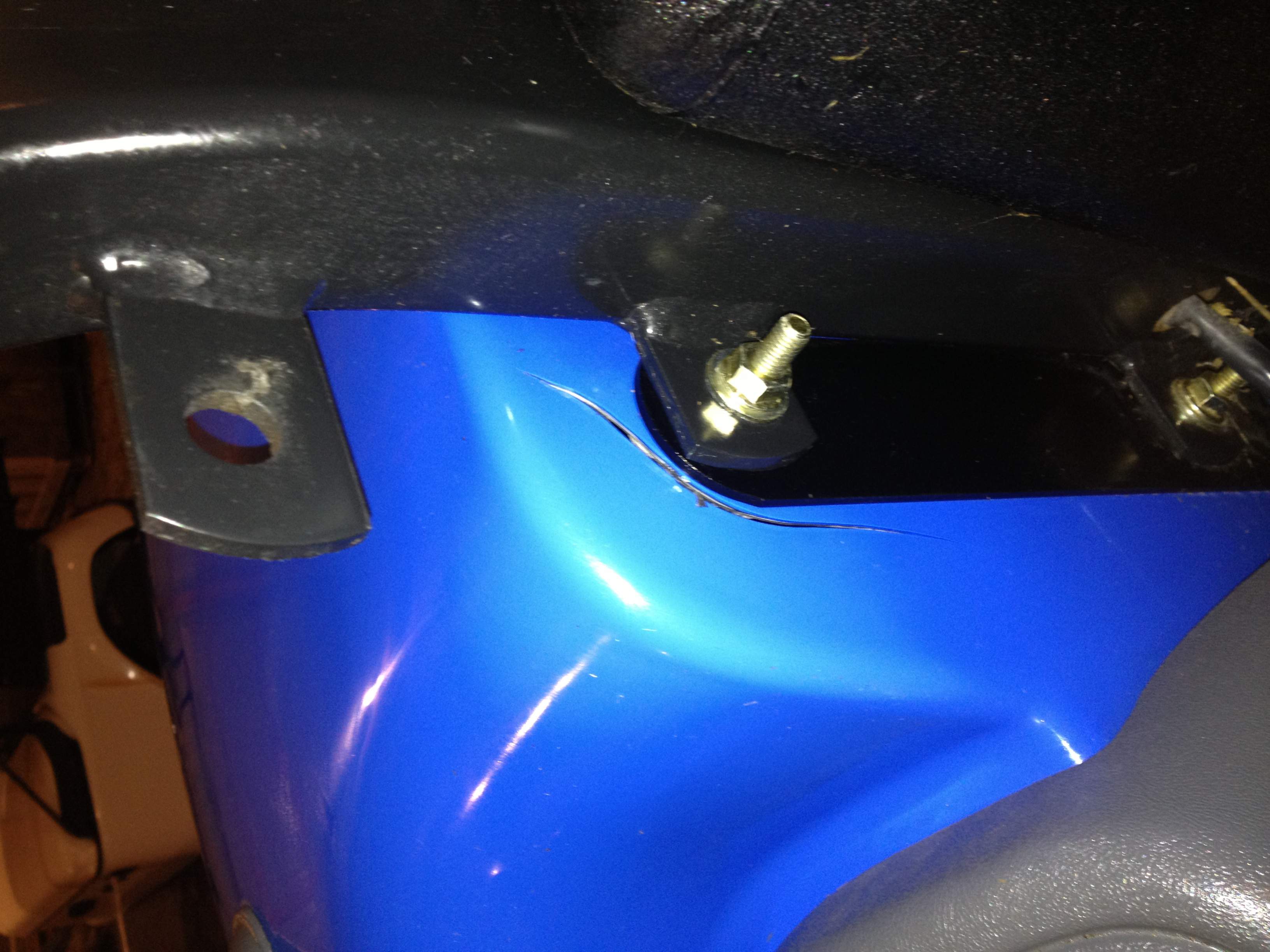

I wish I had checked things over more carefully in late 2012 when I was going out of warranty, but unfortunately I didn't think about it. Mid last year I found a crack of unknown cause on the back of the right fender, maybe 8 inches long from the center corner forward. Later, after more inspection I found a massive crack on the same fender where it attaches to the roll-bar. The entire fender is coming apart with ZERO physical damage. Oddly, I do not ever get on/off of the tractor on this side due to the loader controls and have NEVER used this fender handle. Throughout this process, I spoke with the dealer several times and always kept it friendly. They were sympathetic but said I had to deal with the Regional CNH rep and/or customer relations at CNH.

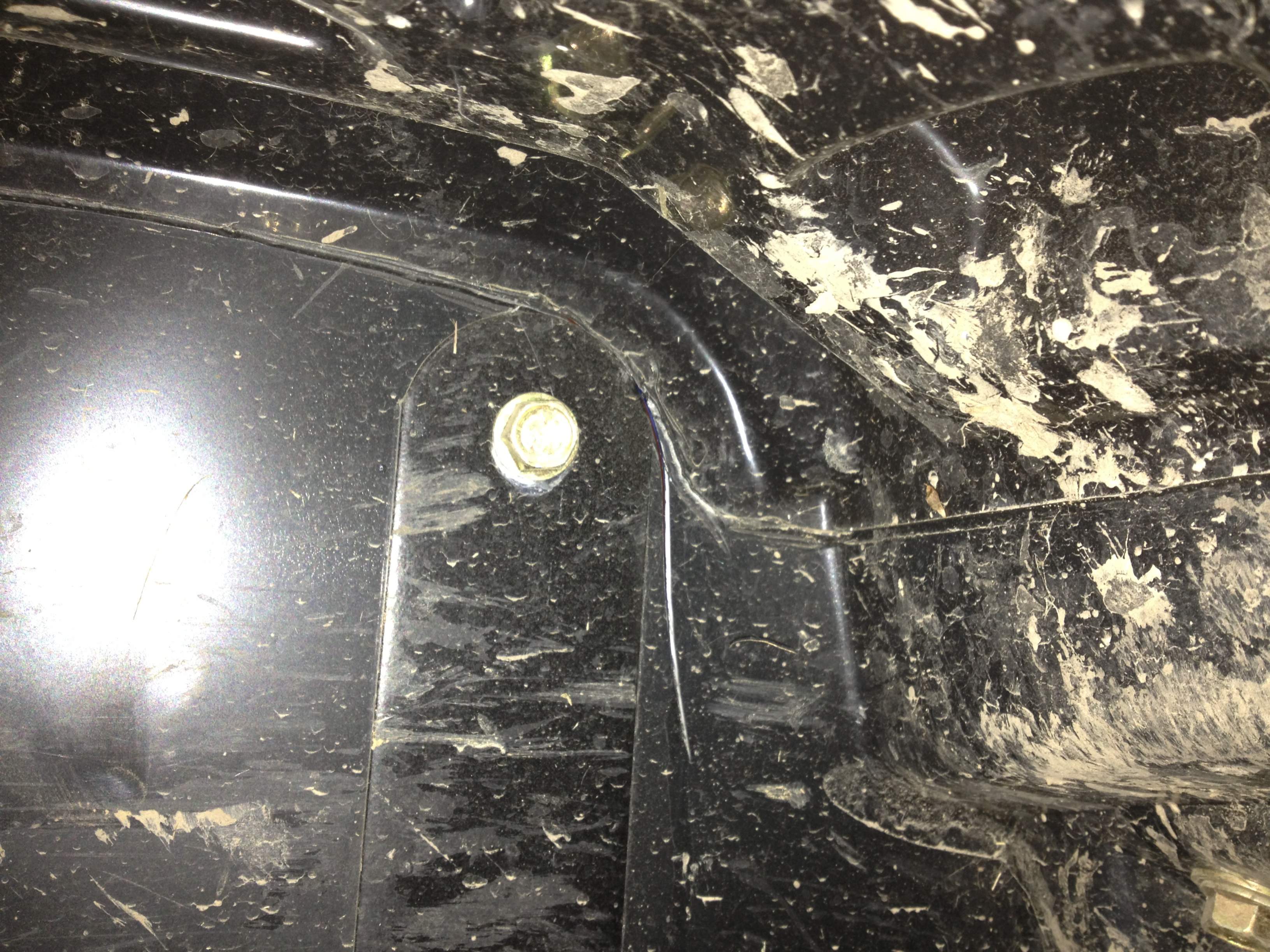

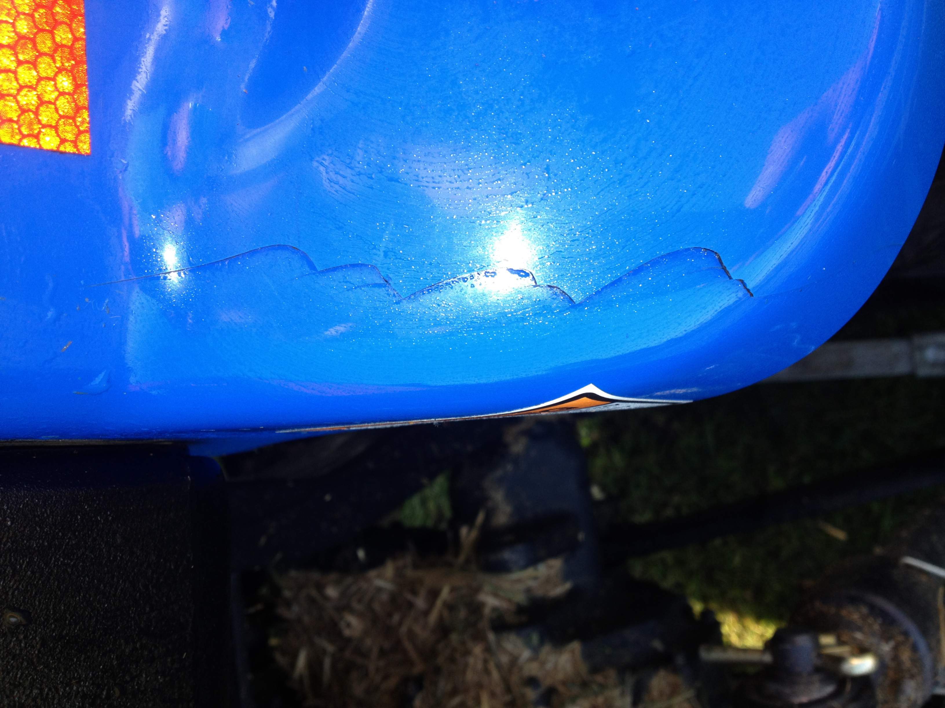

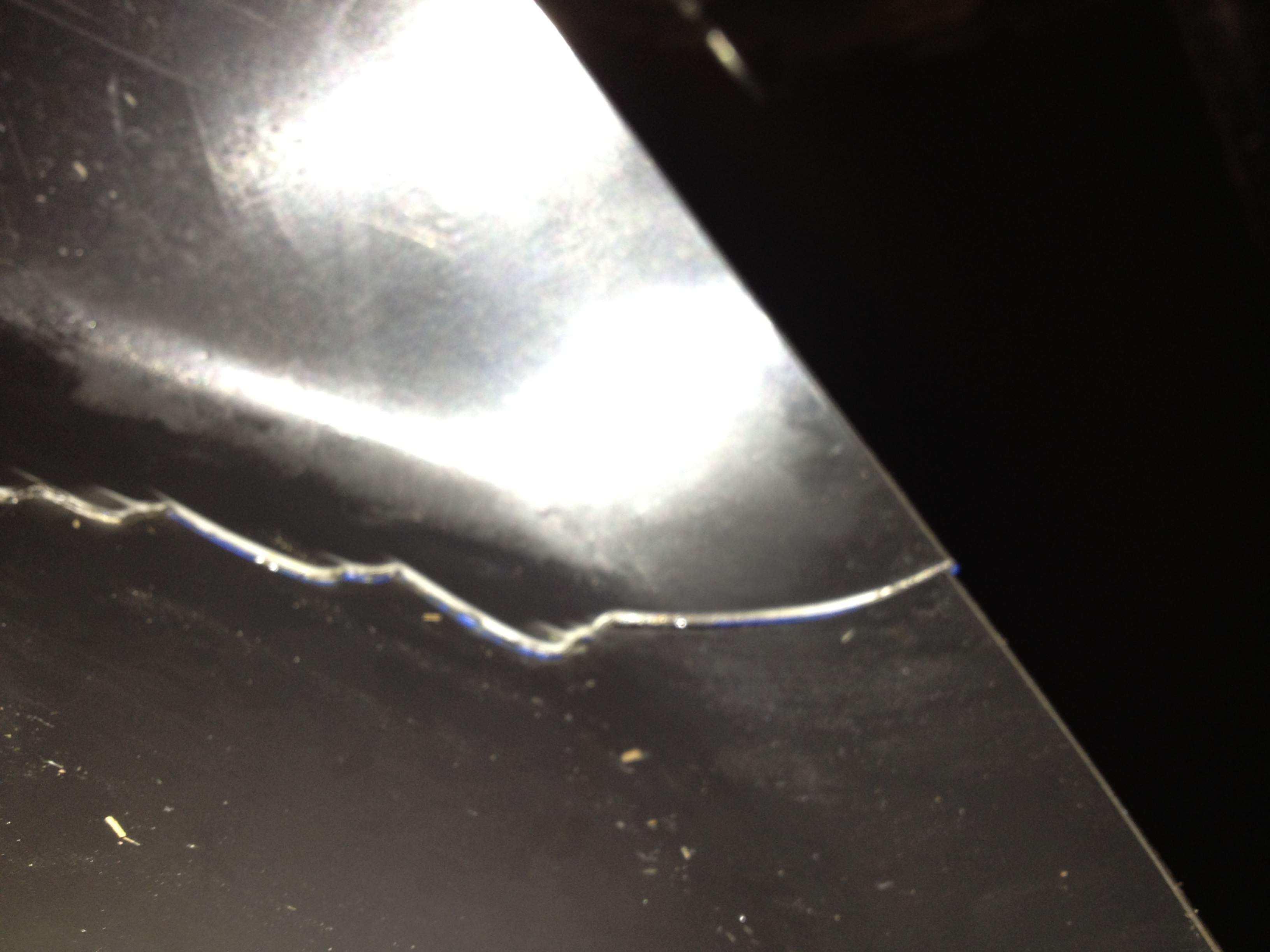

I should have put pictures on to start but had some computer issues. Not sure these are completely clear. Included some shots from top and bottom. As you can see, very clean tractor, even under fenders. Still open to any suggestions. large crack - next to seat.jpglarge crack from under.jpgphoto.jpgphoto[1].jpg
