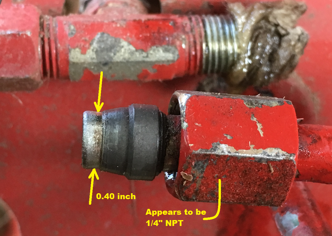

I have noted that the 3/8 inch flex hoses that transition from steel lines to the tailgate hydraulic cylinders are showing age. I want to replace all four of them, each being around 16 inches long. One end is a standard 3/8 JIC swivel fitting, the other is special that can connect to the steel hydraulic line. Does anyone know what this special fitting is? I make my own hoses and want to order just the fittings.
Doing some research, this steel line connection appears to be labeled as a flareless tube fitting. Optically, the flex hose fitting looks like a fixed 1/4" male NPT, but the walls are thinner so that it can fit over the ferrule on the steel line.
I am attaching a photo of the ferrule and steel line.

My mistake. I no longer believe that the flex hose fitting fits over the ferrule. I think it either contacts the ferrule slope or presses against the end of the steel line, as the tip of the steel line seems to have a very slight flare as through the fitting was jammed up against it.

Another update. Re-measured the steel line at a different location, this time I got a dimension of 0.38 inches, thus it is 3/8" OD.
Did some searching and found what appears to be the ferrule that NH uses. It is part number 514929 and is for a 3/8" tube. I just have not yet located the hose fitting to use with it.

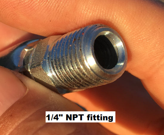

For confirmation, I rechecked the fit of a 1/4" NPT pipe fitting. The fitting threads and nut threads do not get close enough to engage. The fitting does not have a center hole large enough to fit over the 3/8" line, thus the walls on the correct fitting must be thinner than a standard pipe fitting. I am attaching a picture of my 1/4" NPT pipe to show it's detail.

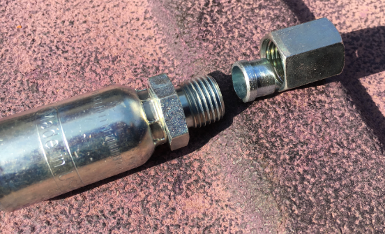

Steel-to-Flex coupling: as mentioned in earlier posts, and pictured, the coupling uses a ferrule over the steel tube. I gave up on finding a male coupling that I could simply crimp on flex hose and keep the same old ferrule and nut in place. I figured that if I bought complete couplings, I would just cut the steel tubing behind the original ferrule and use a new ferrule and new nut. A complete coupling includes crimp fitting, ferrule and nut. Sidebar: the needed male thread is 9/16-18. A 1/4" nominal NPT fitting is the same thread specs but tapered instead of straight threaded. A 1/4" NPT won't fit over the 3/8" hydraulic tube, which is a requirement. From DiscountHydraulicHose dot com, I ordered 27305-06-06 couplings. When they arrived, I inspected and found the ferrules to be a different shape:

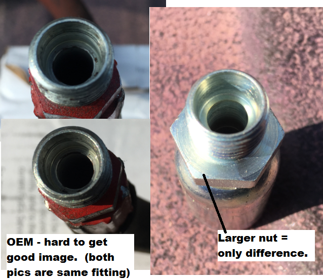

I compared the new the hose fitting to the OEM hose fitting. I don't have fine measuring instruments, but I could not measure or detect any difference in specs between OEM and new - diameters, depth of bore, threads, etc.
I made up a new cylinder feed hose with a new crimp and a new tractor-to-baler lead hose with a new crimp. I connected up the tractor and tested with full pressure and could detect NO LEAKS at either fitting!!!! Yeah!
So that's my solution. For me, they are a perfect OEM replacement. And with all new 2-wire flex hoses, I will feel much better with my next baling job.
