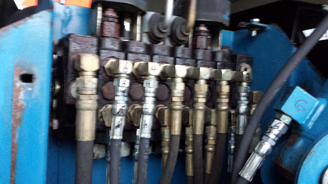

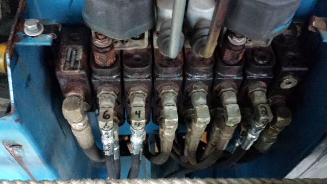

I got the replacement hoses today but most likely will not get to work on it till the weekend. Work keeps me running. The supply and return hoses are connected to a block which is also tied to the loader control valves. This is a factory setup from New Holland. The rushing sound was at the bucket cylinder not at the control valves like when under load. I'll post a pic of the block tomorrow sometime.

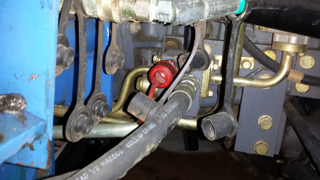

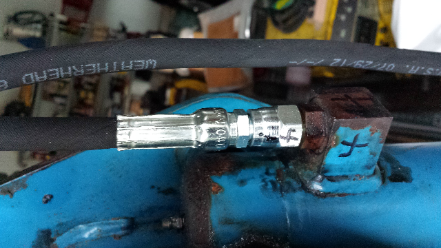

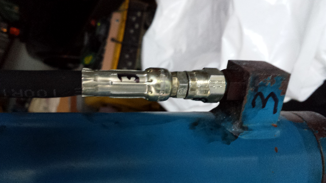

The supply and returns are 1/2". I figure NH did this for volume when operating more than one function at a time. I took these pics this morning. I'm wondering if the fitting with the 3 on it isint the issue as it looks double crimped....

   / NH 757C Slow Hydraulic Movement #16
It's pretty obvious someone doesn't know how to crimp hoses.....I'd be leary of all of those, you may need to check them all for overcrimp
Don't forget on a 1/4" hose fitting the inside dia of the hose fitting is 1/8" or less due to the stem wall thickness....not much room for error
   / NH 757C Slow Hydraulic Movement #17
Try putting a 1/4 rod through the fitting and hose. Probably can't, closer to 3/16 in.
Everyone should know why you try and match hose size with the GPM's, and we know why loaders, BH, and anything you want to reduce the speed of operation, you use smaller hose or restrictors.
The 1/4 in hose and fittings also cost less.
If you switch hoses around, you can tell if a hose is restricted more than it should be.
Make them fix what you don't like.
   / NH 757C Slow Hydraulic Movement #18
I should have been more concise, I meant 1/4" hoses between the valve and cylinders.
Those hoses appear to me to be overcrimped; #3 especially, but also #4. Just an observation from a guy that makes Weatherhead Hoses using 425 series hose.
