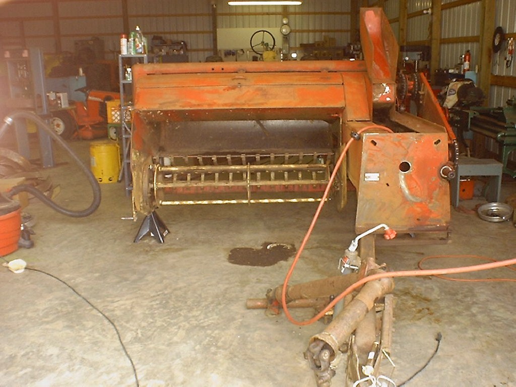

I have all my experiences with New Holland. New Holland and Deere are the most popular balers in my area. You see some Agco centerline under the Hesston, New Idea, Challenger or Massey name. I am on my second NH and it is a 315. (Late 70's to early 80's model). I did have a NH 68 (late 50's model). They were both working when I bought them but I still went thru them when I got them home. They were bought from individuals.

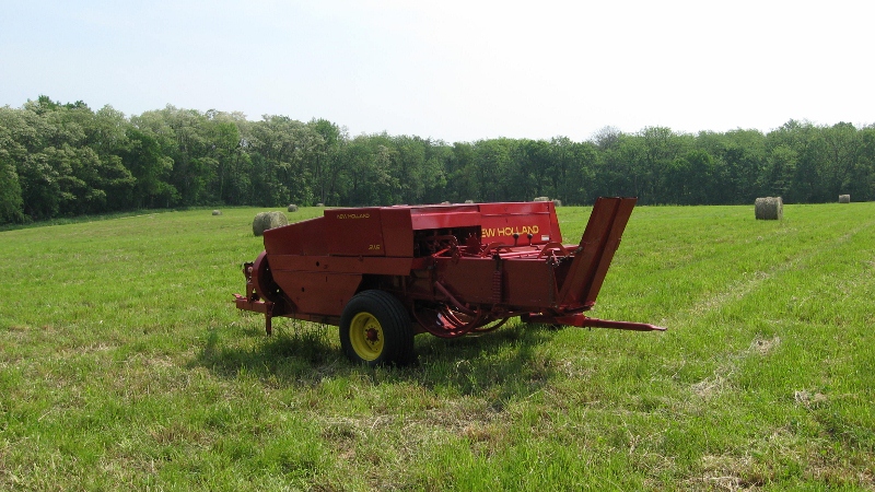

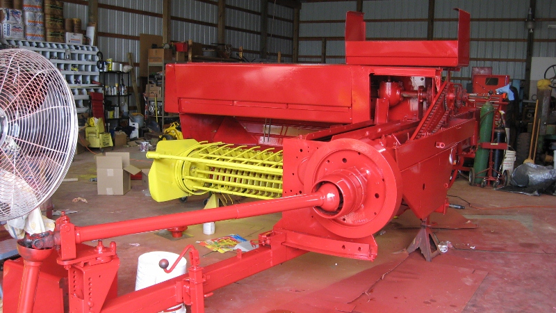

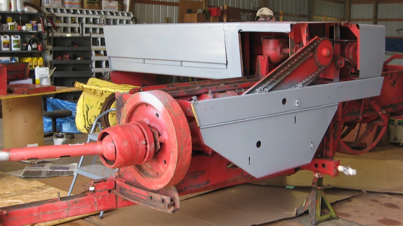

Here are some pics of my NH 315 rebuild a couple of years ago.

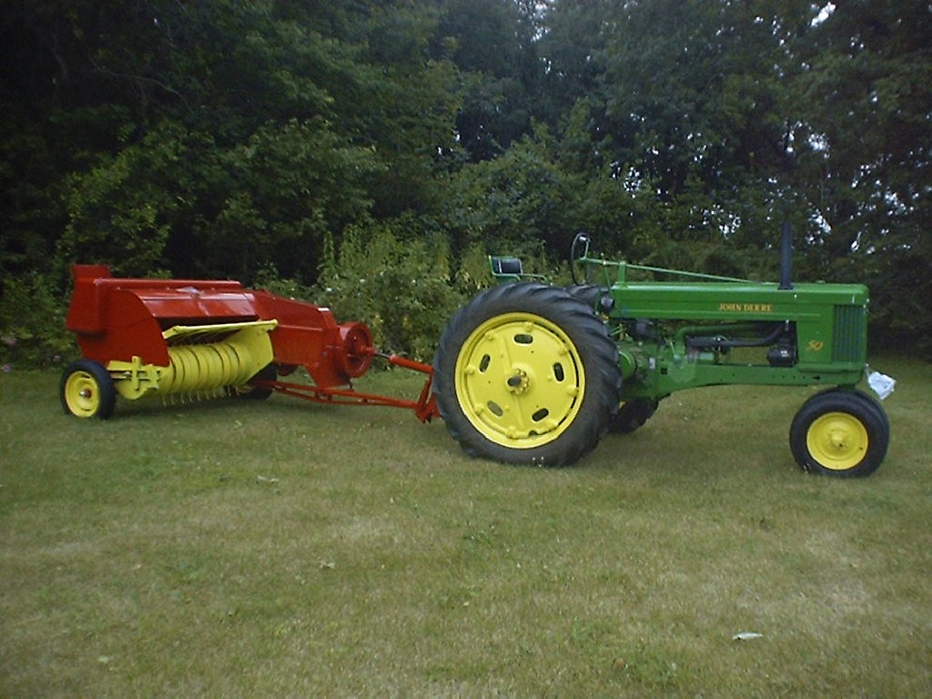

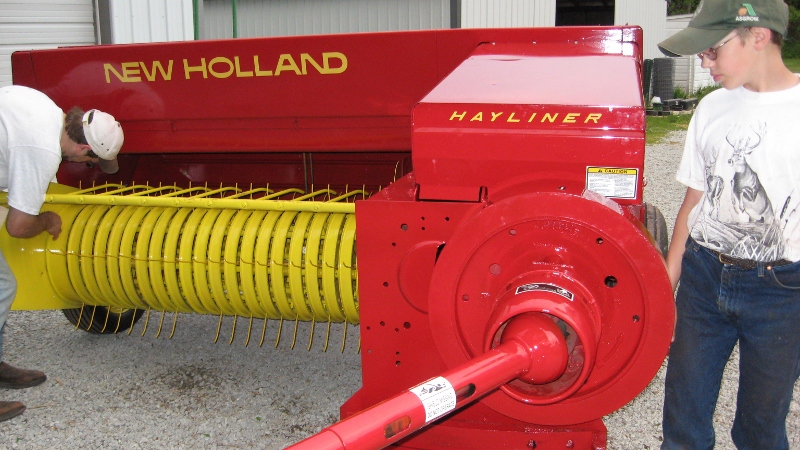

A few more pics of the NH 68 rebuild and NH 315.:D If I can work on these anybody can!:laughing:
