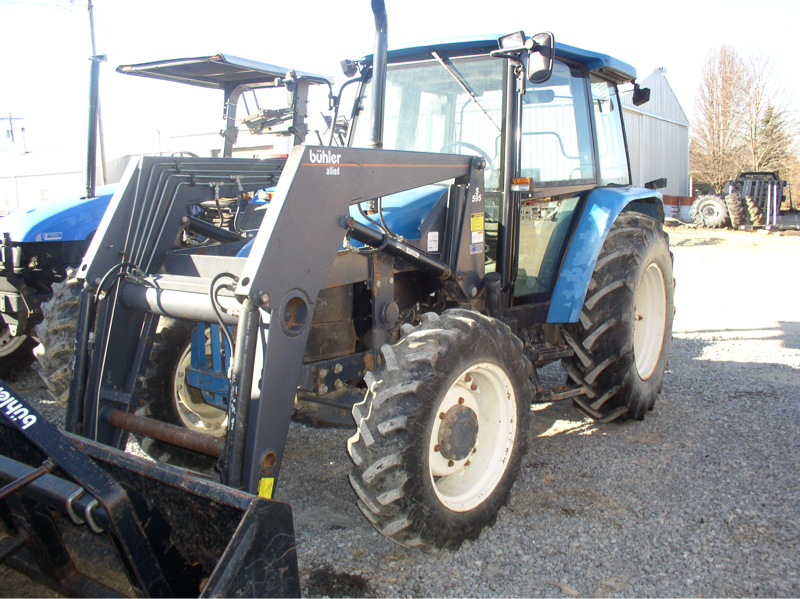

   / NH 5635
#9
I added a picture. It seems to be in great shape and has an allied 595 loader
