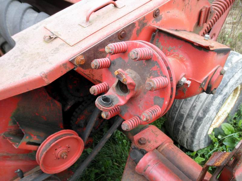

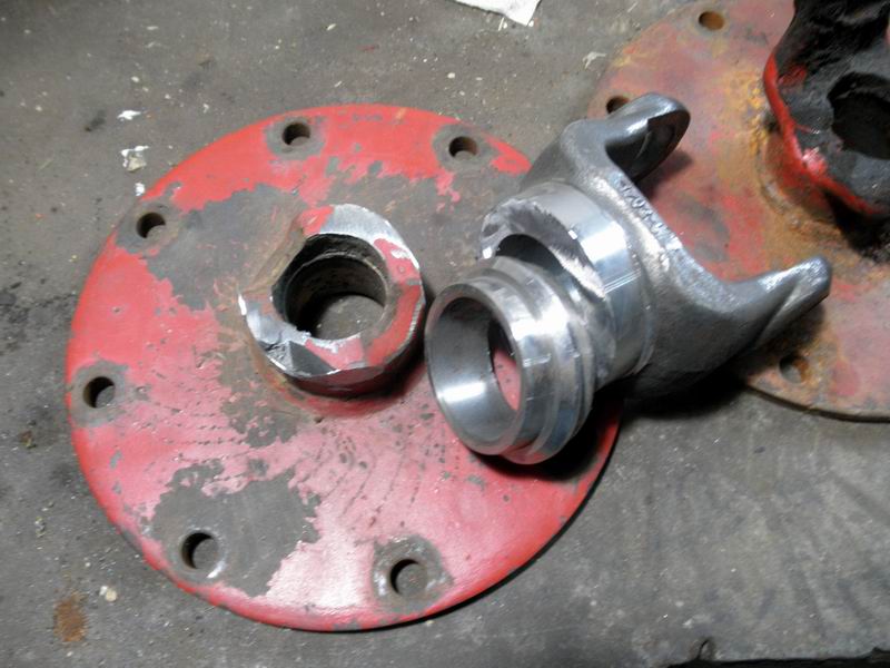

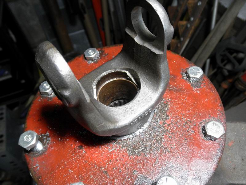

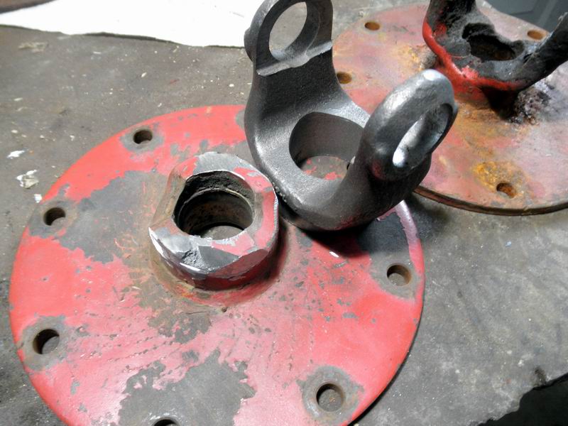

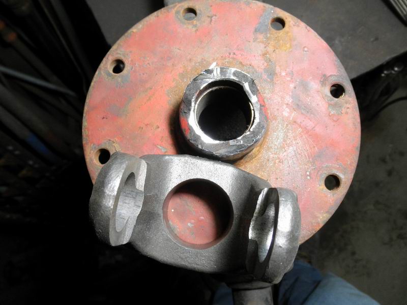

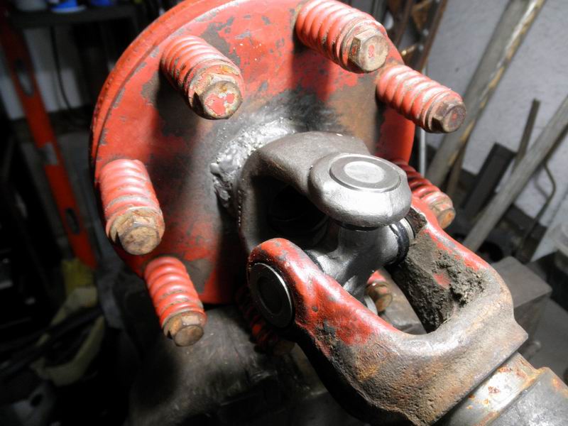

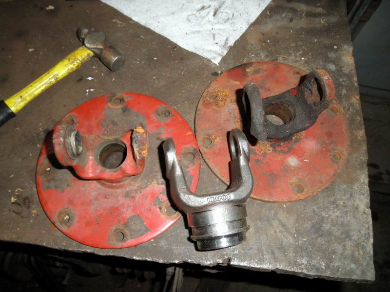

I have a 479 that has the yoke ear broken off. Priced one at the dealer and figured for their cost I would try my hand at repairing it. Found a yoke to fit the cross, SKF UJ187305. I cut a portion off the bottom of the new yoke to get it closer to the height needed. I needed to retain the bushing that was in the yoke so I couldn't just cut off the old yoke and weld in the new one. I cut the ear off the old yoke and trimmed it down with cut off. I then turned down the old yoke on a lathe so the new would slip over the old. And this was the finished product. Not pretty but should do. Will see how it holds up this season.
Just wanted to share.

Nice work.

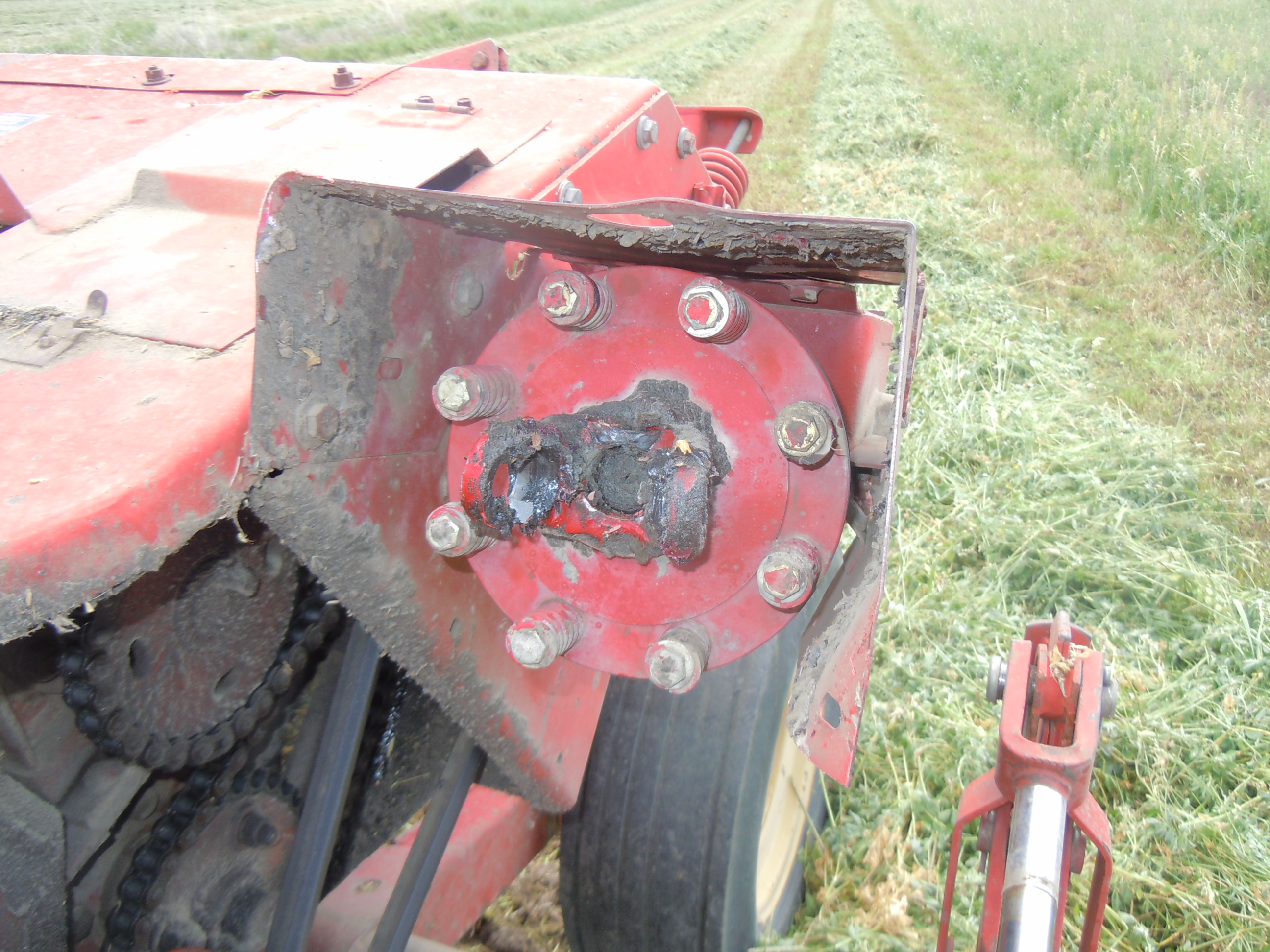

I had to replace the yoke on my NH488 this past summer.
Hoping you could answer a question for me about those slip clutches. Do you engage the PTO at any rpm/speed and let the "slip" do it's thing? Or do you throttle down to engage? I ask because I think that's how I broke mine. At the end of a row I usually turn the pto off and raise the cutter bar, then after turning and lining back up throttle down lower cutter bar and engage the pto.
Last year I was turning sharp on a hill with the cutter bar raised up, pto still engaged and snap. Shaft falls to the ground. This is a long way of asking if I could just disengage the pto while turning around and engage without doing anything else?

You have to be carful how high you lift the cutter if it's engaged too, too high and it's very hard on the drive line.
I lift it, and only turn it off if I'm making a "sharp" turn, like on a point row... For normal corners, I leave it down and make the turn...

I'm sure lifting it high on a hill while engaged is what caused the problem.
