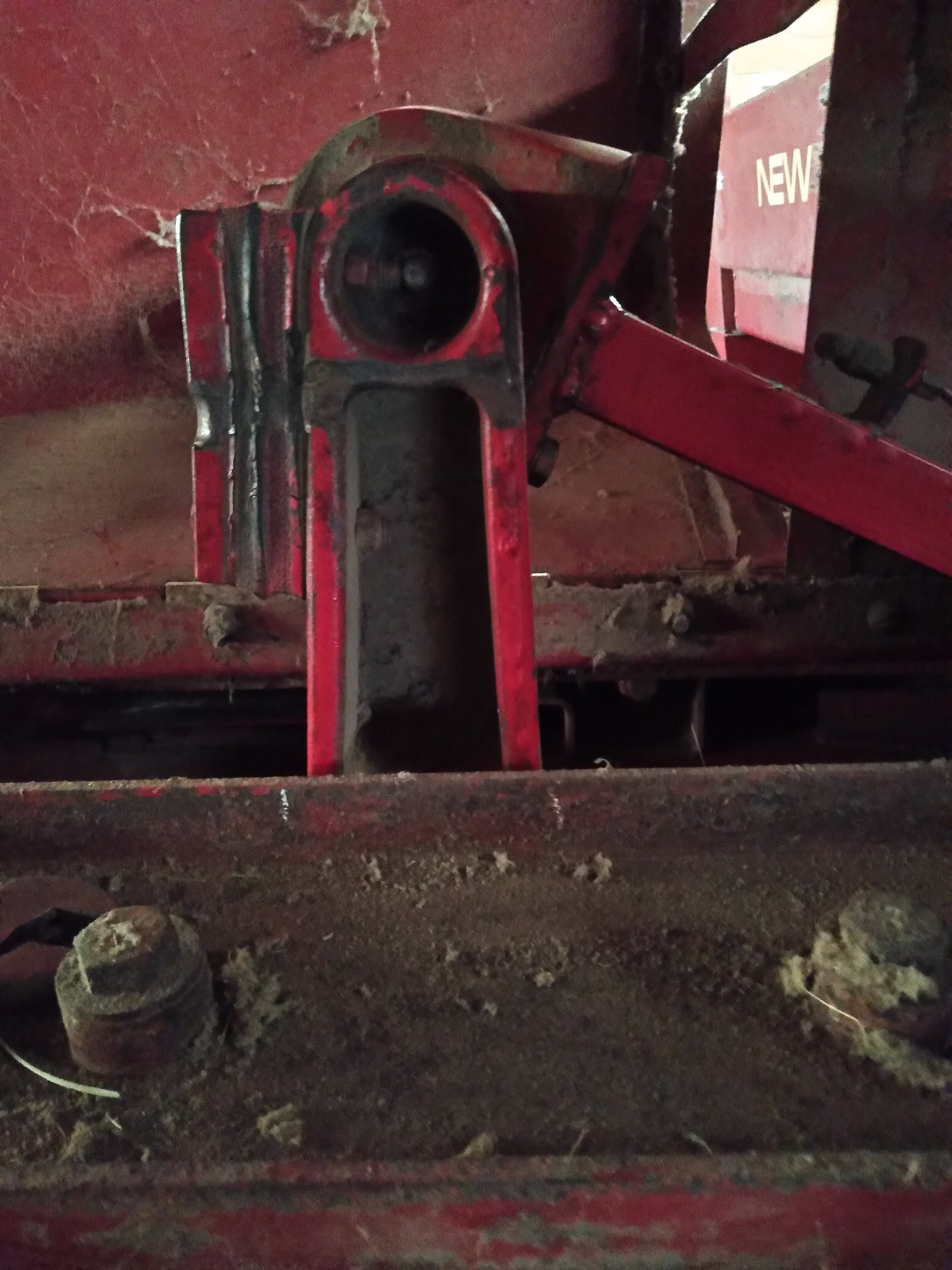

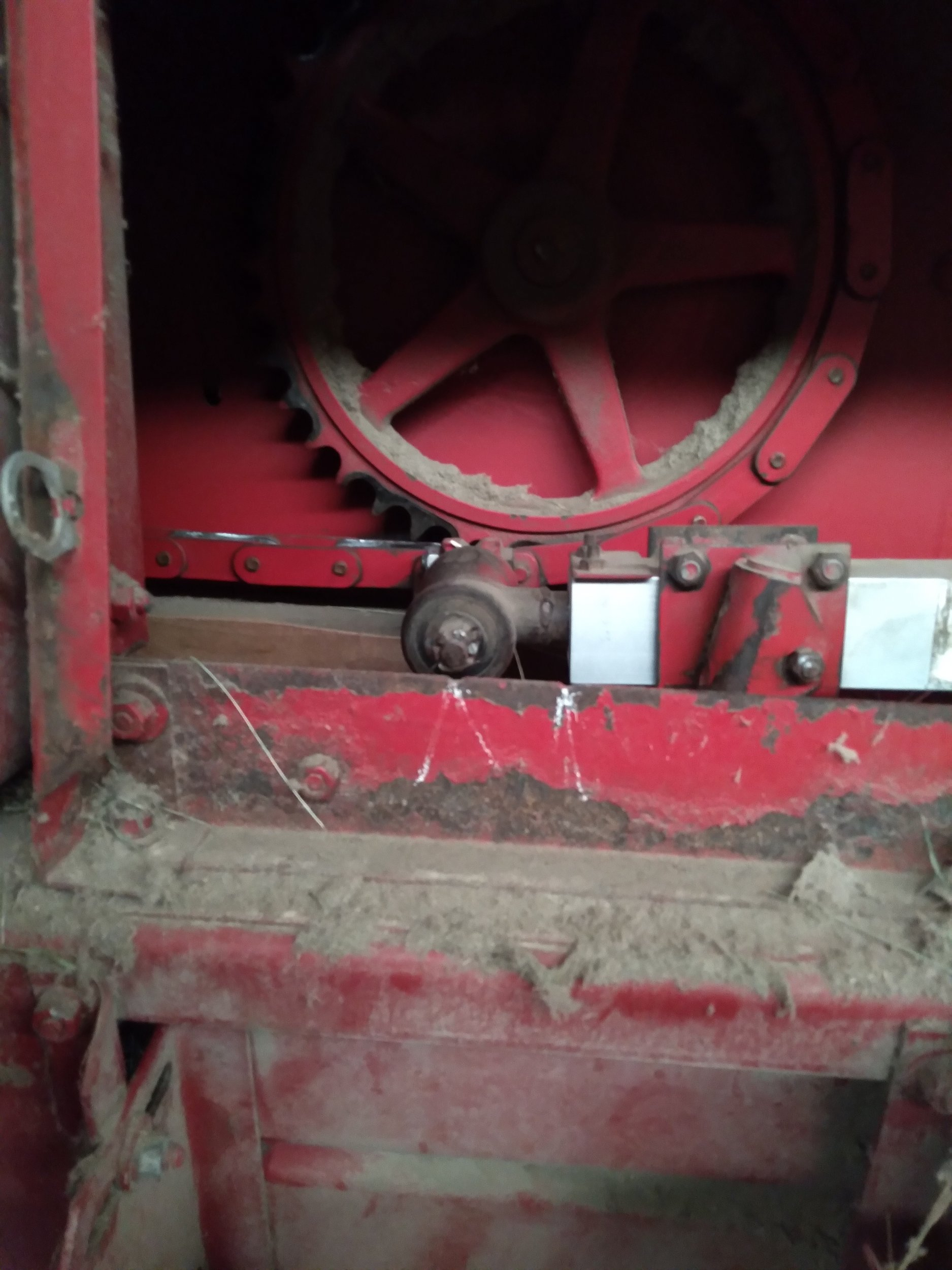

I have tried timing this 315 baler several times it seems to bale ok but when timing the plunger and tine bar are between marks then when i hook up the drive chain and idler wheel the tine bar bolt move to the right side of the right mark or the left side it will not stay between the two marks. Thank you

What is the condition of the chain or is the sprocket worn?
