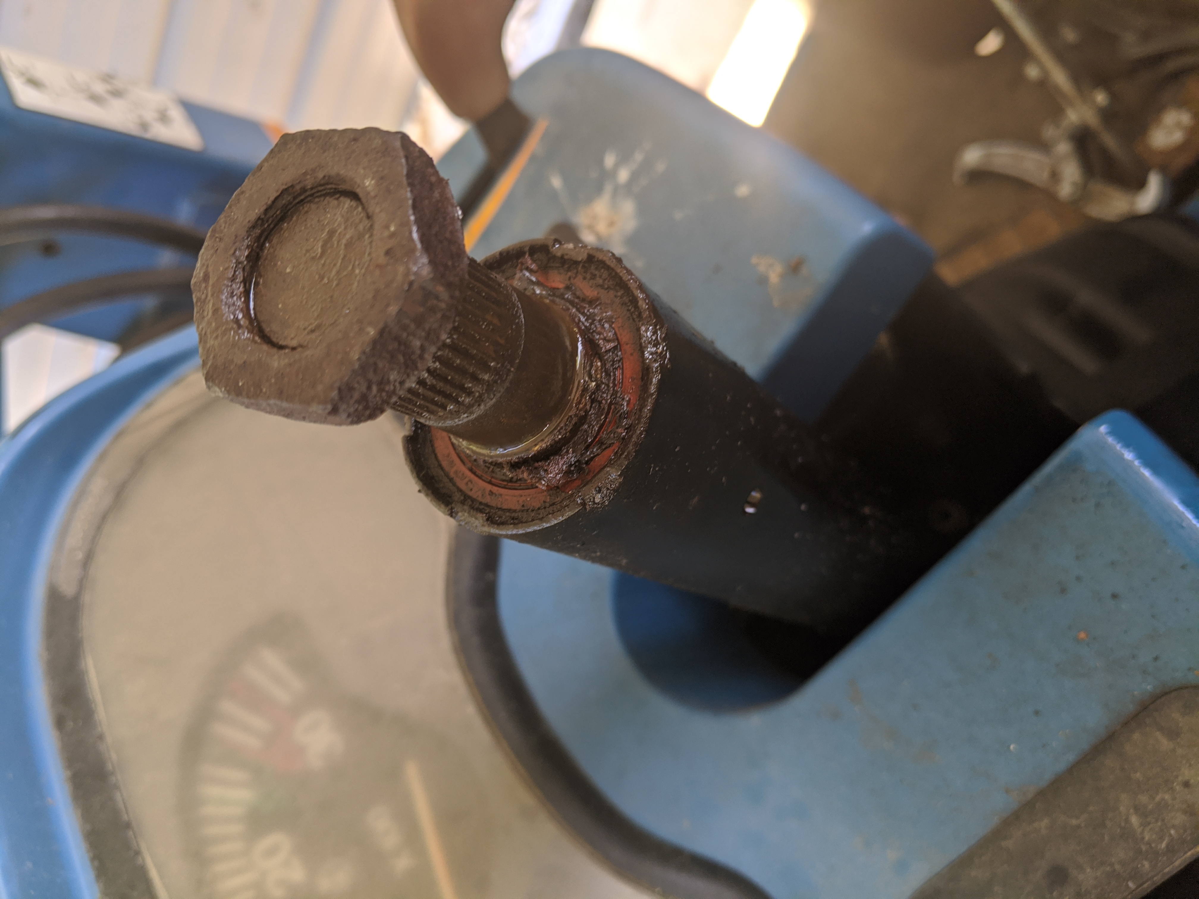

Hello gents, it has been a while but I have had some long term problems with my 1925 FWD that have gotten bad enough that now I need to address them.
My steering column is leaking power steering fluid from the little plastic plug under the steering wheel. I believe that many of these were built with a snap ring and a serviceable seal and o-ring underneath there. Mine is crimped together at the top and there is one side of me that is saying pry the crimps apart and figure out how to rebuild the thing, the other side of me is just spend the $400 and move forward with a new one.
Has anyone cut or pushed back out the crimps and can give me some insight into rebuilding that steering column?
My steering cylinder is bent as well as a pretty good gouge out of it, unfortunately NH does not support it with parts, and even though Messicks shows a rebuilt, there are none available. Looks like about $800 for a new one. That is in the department of making me sad. I dropped it at a friends shop today and they are going to look at making a new shaft etc, and getting rebuild parts for it and getting it put together for me. I am hoping that comes in at less than $800. I am picturing about $500.
ended up cutting one of the power steering hoses to get the lines off, apparently they decided not to use any swivels so I need to get a new one made up. At least one will get a swivel fitting. Probably just change them both out and put swivels on both while I am there.
Anyone fooled around in there with these systems and can provide some insight? IMG_20200424_172309 (1).jpg

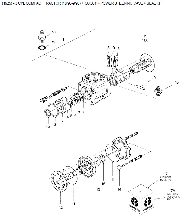

Hi, first off, the top of the column is not your problem. The column is bolted (4 bolts at the bottom of the column) to the steering motor which has a seal leaking. I have take these apart and the kit can reseal them. Sometimes water gets into this area though and pits the shaft where the seal rides. Then, you might as well replace the motor. I found an aftermarket motor for one a while back.
There is a complete motor seal kit depending on serial number that is either $161 (Jan 96 - Nov 96) or $239 (after Nov 96). Take a look at the diagram attached. 1A, 2, 4 and 5 are the part needed, but they total up pretty close to the price of the cheaper kit.1925.jpg
