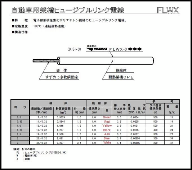

Answering my own questions here just for reference:
The original fusible link is Yazaki FLWX-0.85. There appears to be a new part number which is HR085-21A.
The wire appears to be 18 AWG which has an ampacity of 16A. The fusible link appears to be rated for 21A.
Various auto parts stores sell fusible links with 18 gauge wire. Belden 784690 is one example.
