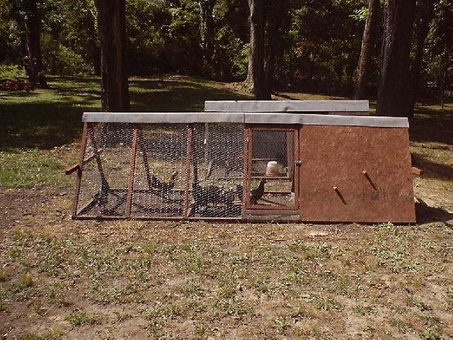

   / Next chicken question - winter lighting? #3
Dr Dan, I use a 60 watt bulb for light in my henhouse. To lay best the hens need about 12 hours of light. also attaching a pic of my modified chicken tractor. No wheels, it has handles and we just pick it up and move it once in a while. The larger coop is 12' long with 4' covered and 8' of open run space. it was made by ripping pressure treated 2x4s into 2x2s. I also nailed 2x4 dog wire across the bottom so the critters could not dig under. They have tried but the dog wire kept them from coming up inside. This size coop will accomadate 6 to 8 hens. I drilled holes in the covered side and installed wooden dowels for roosts. You can see them sticking out the sides.

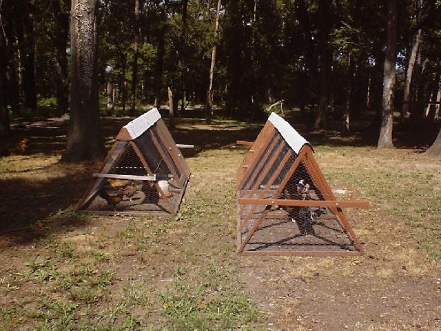

   / Next chicken question - winter lighting? #4
Tis is a pic from the ends the shorter coop is 8' with 2' covered and 6' open run space.

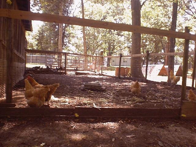

   / Next chicken question - winter lighting? #5
I have 11 buff hens and a rooster on the west side of the hen house

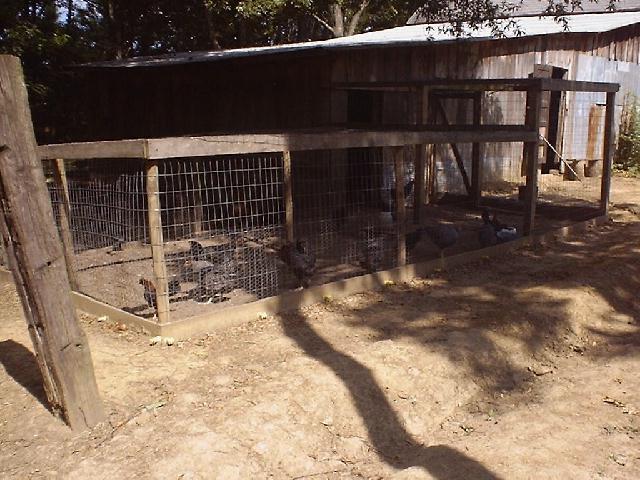

   / Next chicken question - winter lighting? #6
I have 9 barred rock hens and a couple of rooster on the east side. They will be laying by fall. The henhouse has a partition in the middle. I have a small incubator and I hatch quite a few chicks.

   / Next chicken question - winter lighting? #8
Jim -- I really like the design of your chicken tractors and will probably copy it next year. The big rectangles we've been using weigh so much the portability suffers.
I'm curious, though. What do you do with the manure from your permanent pens? Looks like quite a few birds in a relatively small space; they probably give you a heck of a start on composting!
