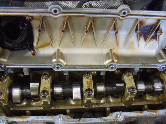

Here is a 2003 Jetta 2 liter gas engine with 200,000 miles and always Mobil 1 at 10K intervals (salesman's car). This picture is from 2009 and engine now has over 300,000 miles with no bearing issues.
