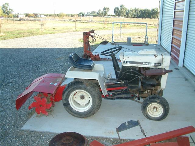

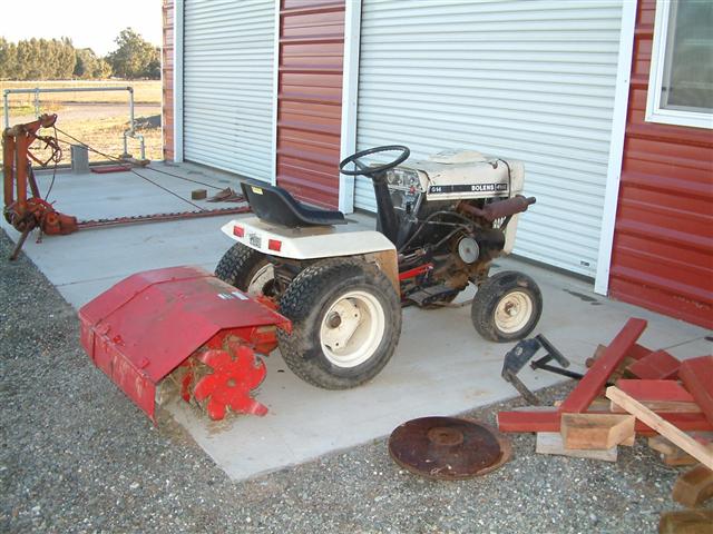

In 2007 I bought a medium tube frame Bolens GT1453 with 42" deck and rototiller for $600 off craigslist. It has the 14 hp Tecumseh engine.
I used it for 5 years before the engine started smoking badly. Replaced the engine with one of those Predator 420 cc Honda clones from Harbor Freight.
