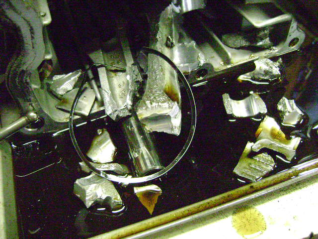

I saw a listing for a new model GT5000 (red) that is in good condition for $250 (a steal in my opinion), but they say it has a broken rod and wont run. Besides doing some work to replace that, any red flags on the engine I should consider when looking at this? If it is only a rod, that is fixable but not sure what other damage could have been done.

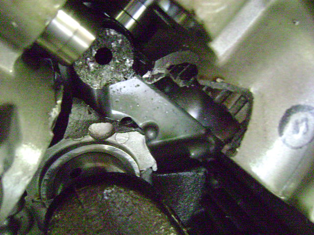

Here is a few pictures of my blown rod engine,you may be looking for another engine

Well you make a very convincing point. I guess my only hope would be that the seller said they "had to have it diagnosed' as a broken rod and I am assuming your damage was visible from the outside. Guess the only way to know the extent of damage is a tear down. These Kohler engines make good tractors into garbage quick. My GT3000 is solid as a rock except for the engine.
   / Newer Model GT5000 - Blown Engine #4
All the damage was internal, but I bought the machine anyway. I had another engine that would fit and has worked out well for 3 years now. Quite a few engines will probably replace the original. Mine was a 23HP Kohler and a 15HP Briggs single went back in perfectly. I have not seen any lack of power from the change. I have another tractor with the original engine to compare it to.
