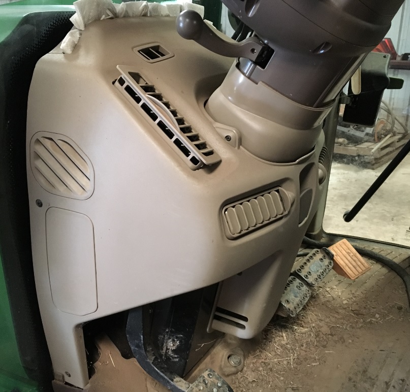

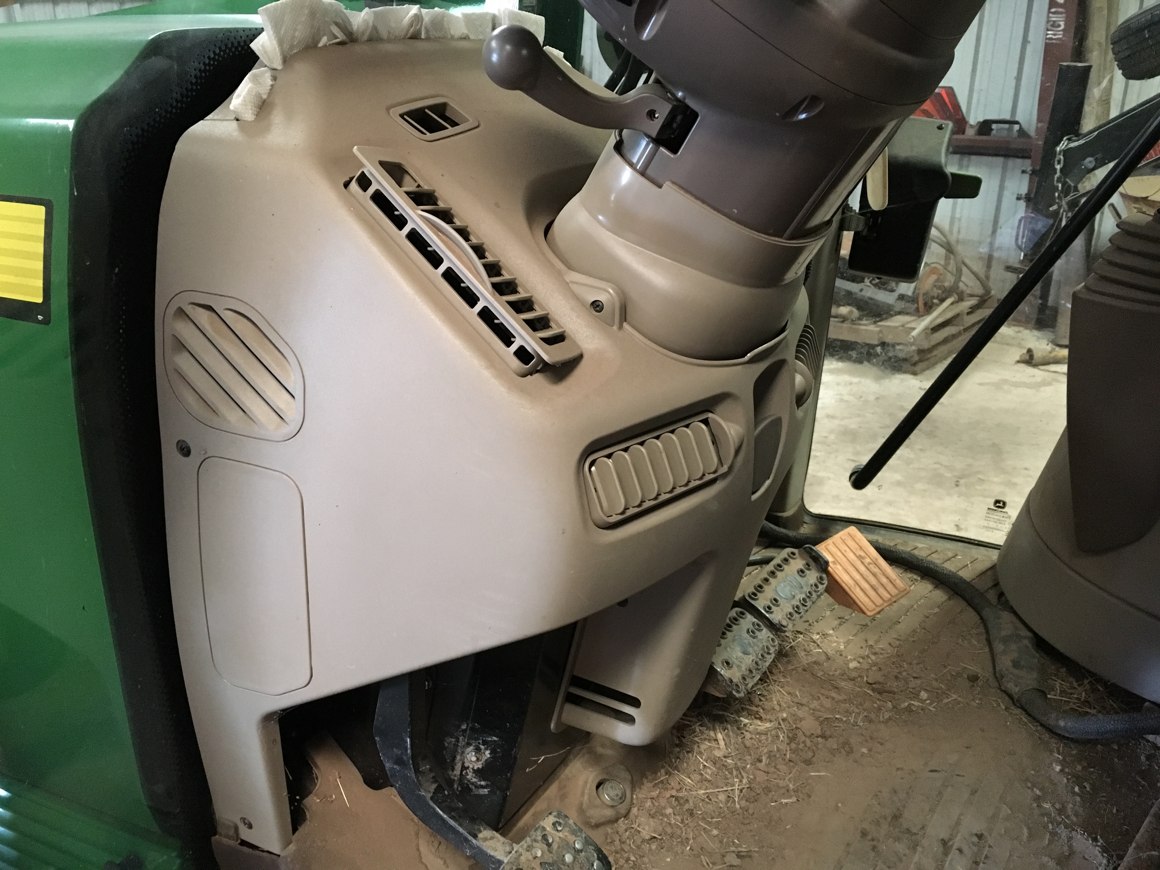

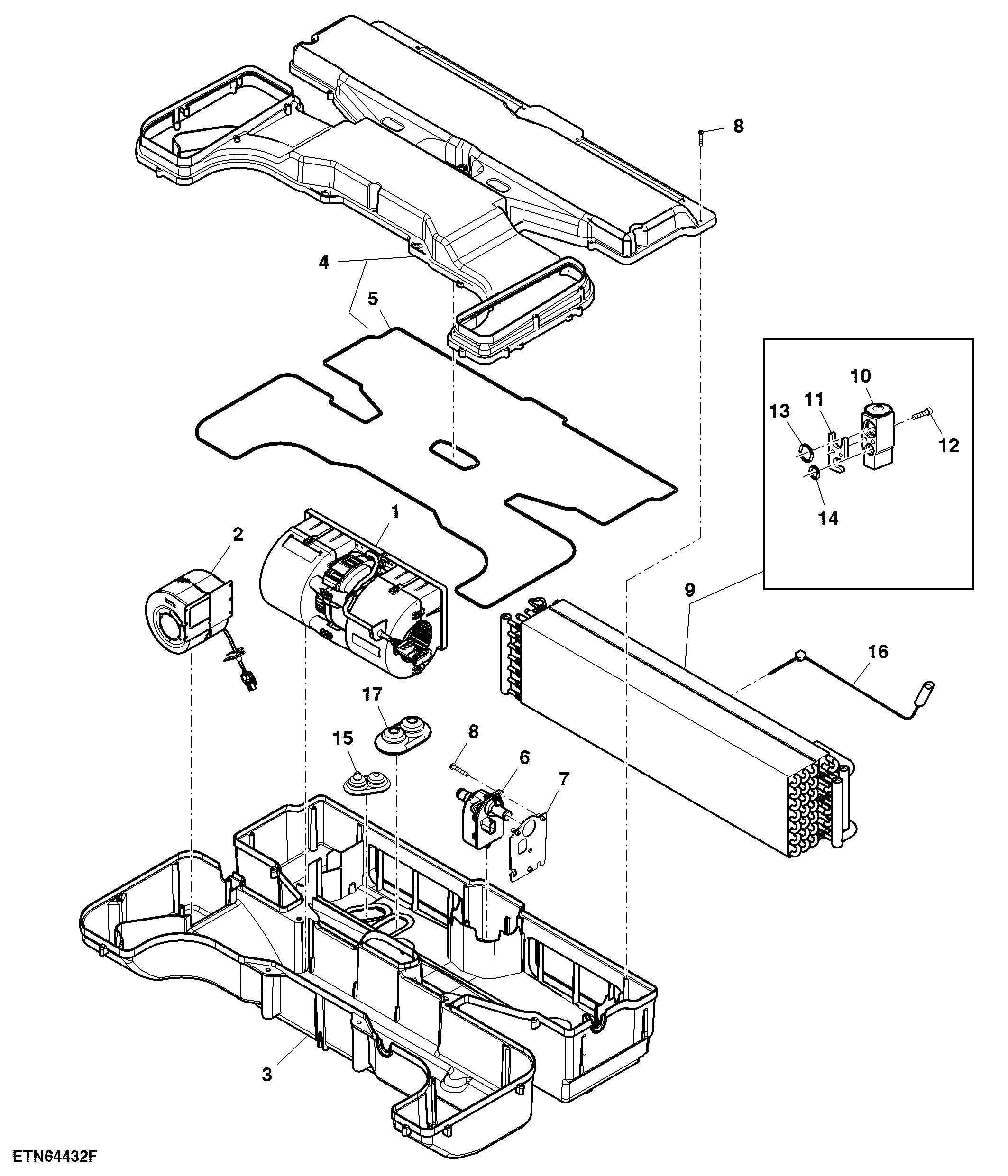

I have an issue with a 2012 JD 6105R. This JD design has all of the cab temperature equipment (cold or hot) in the steering pedestal:

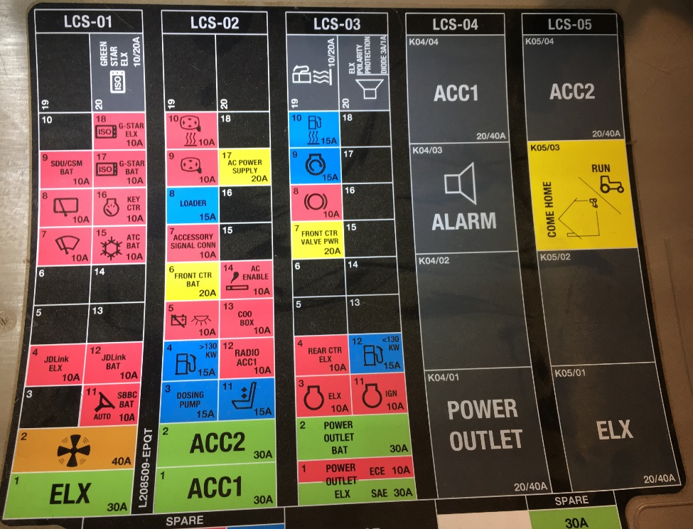

All of a sudden there is no fan. No matter what I set on the temp controls (heat / cold), there is no fan blower action. No action - as in no sound of a blower even trying. I checked every fuse and all are good. I have found nothing else failing except the blower. Here is the fuse layout:

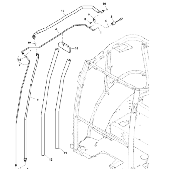

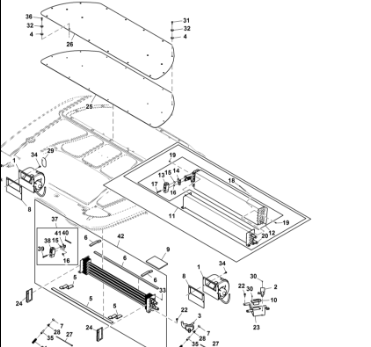

   / Newer JD - Cab air (A/C, Heat) fan does not blow #3
It appears from viewing parts catalog that blower motor is under cab roof.

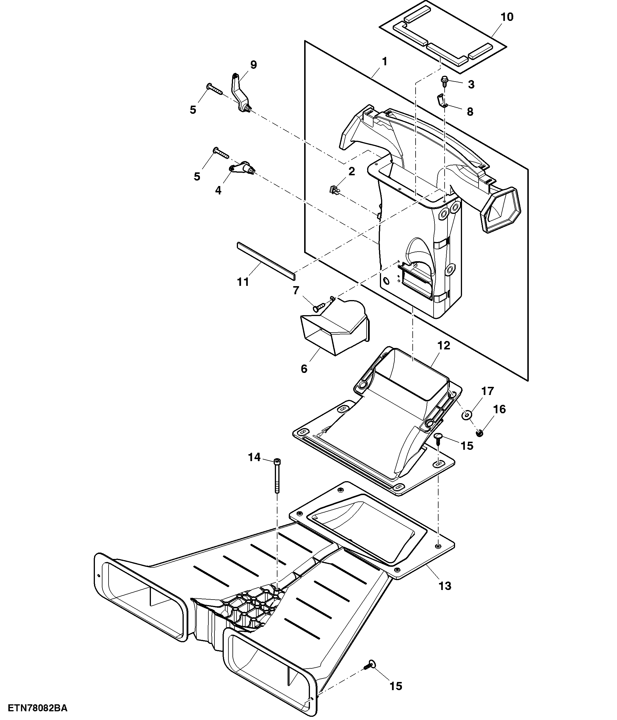

   / Newer JD - Cab air (A/C, Heat) fan does not blow #4
From what I found in the JD parts catalog it looks like the blowers are under the floor. Notice the duct work for the steering column comes from below.

Blower motors are actually under the seat. Remove the seat and panel under the seat for access. Depending on which version of a/c you have, blower motors may be controlled by an electronic control unit(computer). Are you getting any codes displayed?
   / Newer JD - Cab air (A/C, Heat) fan does not blow #6
I thought blower motor was under seat but didn't understand why parts catalog shows lines leading to top of cab. Can someone explain what lines I saw? Thanks,Jim

I was thinking that the blower was deep inside the pedestal, but now I am doubting. I have removed the steering wheel, tilt collar and large pedestal shroud that has the vents. I can clearly see ducts and butterfly valves but no blower, yet. How to take this further apart is perplexing. Definitely a complex design that requires expensive service if service is required.
As I look at Zebrafive diagrams, I see a probable match. Now the question is how to access. Maybe I should remove the rubber floor and look for an access panel?

Here is what could have saved me a lot of time, as found in the Diagnostics:
Now I need to put the steering pedestal back together and remove the seat. The electrical diagram is informative for concepts, but the weakness of those is that physical locations are always absent.

Conclusion: I removed the old blower fan and replaced with new. $450+. Unbelievable. For a 12v motor and double squirrel cage. I tested the new fan by connecting before reassembling anything. It worked. I dissected the old fan motor and noted some green corrosion (copper) on the circuit board. Apparently the designer and manufacturer did not anticipate ever having condensation.
