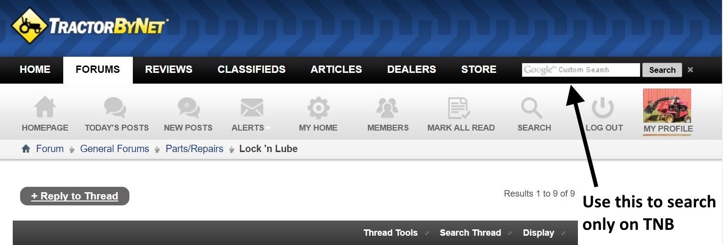

I have done multiple searches on here but not much luck
Did you use the custom search feature: Search Results | Compact tractor forums, news, reviews, information.
