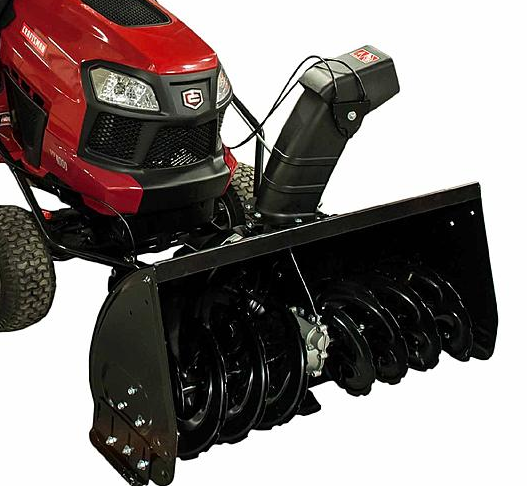

Currently and over the last 8 years I have an used an RZT50 for the lawn and a craftsman gt6000 18hp lawn tractor with the agri-fab universal 48" two stage blower for snow removal. Both have worked pretty well but the RZT slips on my hilly yard with even the slightest dampness- andd it's nearly impossible to let my 2 year old son ride with daddy (which I think will be solved by the 4wd 1710). Not to mention that I hate having two tractors in my garage all year round.

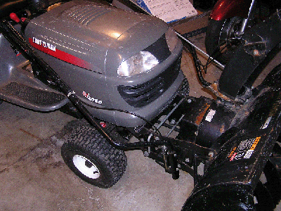

So, i've got this agrifab 48" blower that works quite well and i got new for a great price - i'd like to try and retrofit it for the GC1710. I have read many posts about adapting plows and other items to a tractor so I figured this shouldn't be any different - perhaps more complicated though.

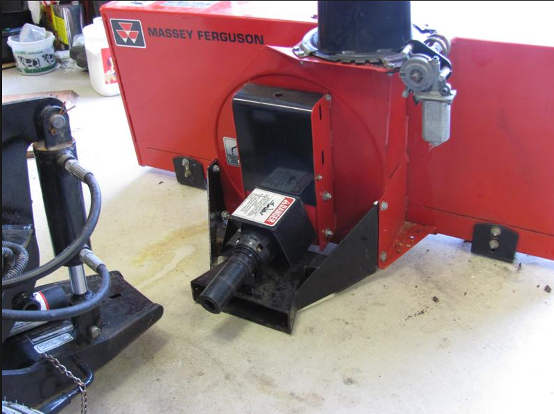

-- I believe I need the front sub-frame mount for the blower - does anyone know if this mount includes the hydraulic lifting mechanism - or is that mechanism of the snowblower?
For fun i've attached some pictures of the what my current blower looks like vs the 2360 as well as some tractor pictures I took at the dealer - she looks too clean....

The front blowers for the Kubota Bx line hooks up without modification. The Kubota and Massey blower are made by the same manufacturer, Rad Tech up in Canada. The only difference is the MID PTO speed, Massey is rated for 2000 rpm and Kubota 2500 rpm. There is a corresponding gear difference in the blowers to compensate.
I think the agrifab blowers made for riding mowers are belt driven..the hard part is finding a way to adapt the belt drive to take power form the PTO....adapting a plow is much easier....

2.The hydraulic lift cylinder is on the quick hitch, see the last picture you posted, lift cylinder is on the left with the tractor.

Thanks Fiziksgeek, I guess I should have looked over that last picture more carefully. As to adapting the agrifab belt driven blower to pro driven, it looks like I could buy the adapter gear parts from MF or kubota and possibly retrofit the drive with those.
Looking at the rear of the one i have it looks like the belt drive and lift system are bolted onto the blower and can be removed, then it would look similar to the rad tech model. I'll need to spend some time looking at things as I analyze how to do this.

Take a really good look and compare the construction of the blowers. Is the old blower made sturdy enough to survive the front of the GC. Looks like a lot of stamped/bolted parts on the agri-fab blower.

So this blower has worked flawlessly for 5 years on my sears tractor clearing my driveway and at least 4 other neighbors' driveways - it throws about 35 feet, is barely rusted, and weighs about 175lbs. I don't understand why it wouldn't be sturdy enough to survive the front of the GC? It's the same operating environment, speeds, and operator - just a different power plant. Can you explain what makes the GC beat on attachments vs my current tractor?
