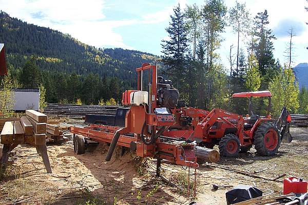

Here's an image of our tractor and our woodmizer bandsaw cutting cedar bevel siding.
