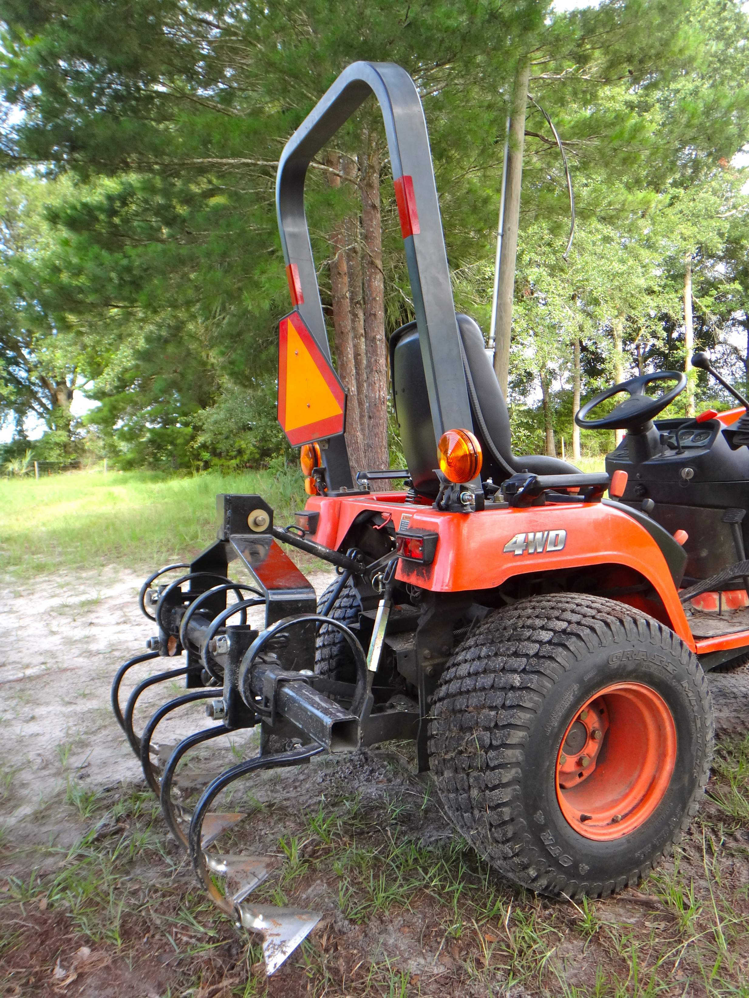

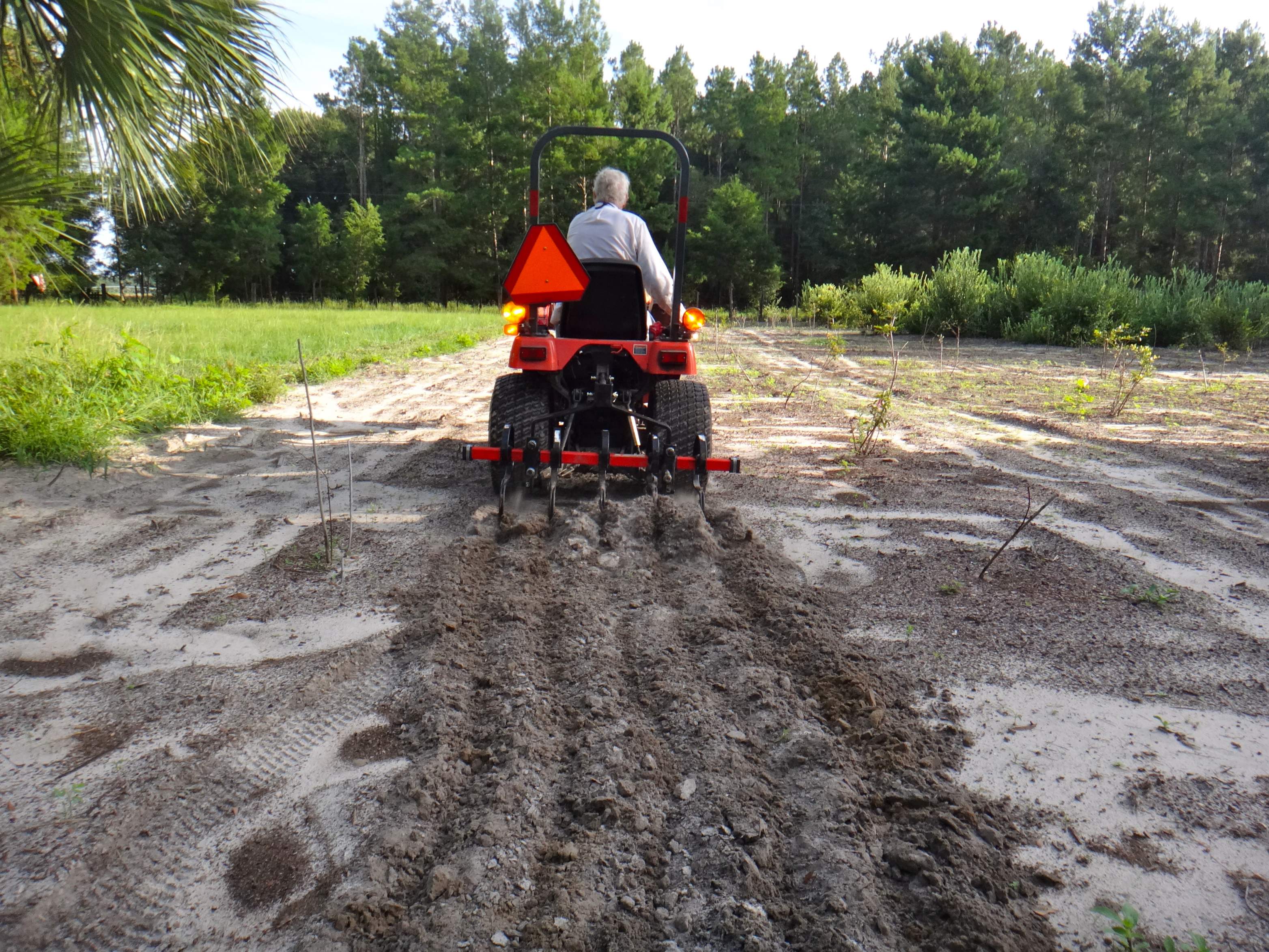

I am a hobby type farmer on five acres. I want to purchase a new compact tractor around 30hp. We would use the tractor to till our 1 acre garden, use the FEL for cleaning the animal stalls in the barn and occasionally moving some dirt/sand/mulch around the property. Eventually I would like to add on to our pasture so I would consider renting or purchasing a post hole digger.
Twenty to thirty horsepower should be ample. Twenty to ~~ twenty-five horsepower subcompact tractors are smaller and might be more suitable for barn work. Thirty horsepower begins the compact tractor category. There are a zillion tractor brands and models in the thirty-horsepower and under category. I think all diesel tractors in the thirty-horsepower and under category are standard with 4-WD today.
You probably want to consider:
Hydrostatic transmission (HST)
Front End Loader with Bucket (FEL)
R4/Industrial tires
48" to 60" Three Point Hitch mounted PTO powered Roto-tiller.
Probably a 48" to 60" Three Point Hitch mounted garden Cultivator.
~~ Three Point Hitch mounted Auger
Here are a couple Kubota tractor suggestions:
Sub-Compact Tractors | BX-Series | Kubota Tractor Corporation
Compact Tractors | L Series | Kubota Tractor Corporation
Take a good look at the small but heavy Kubota L2501.
